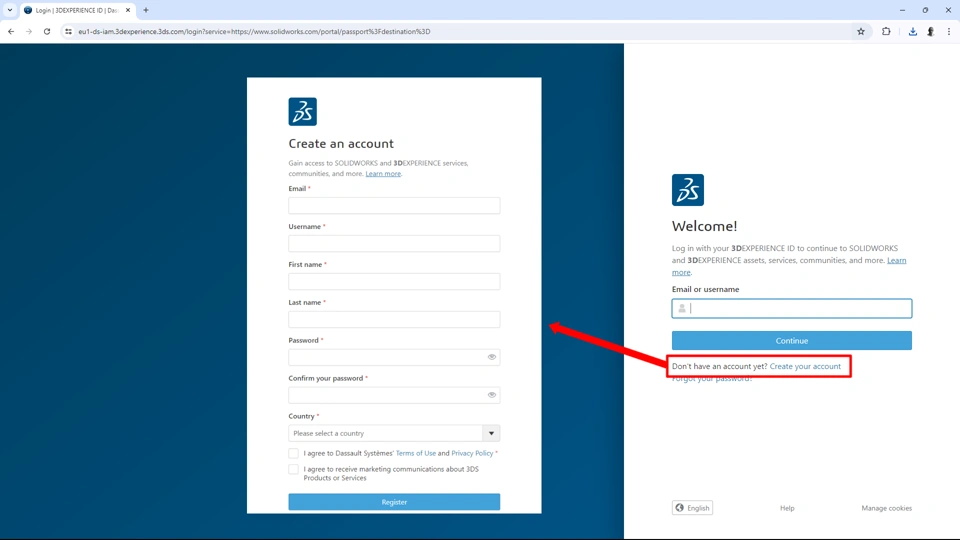

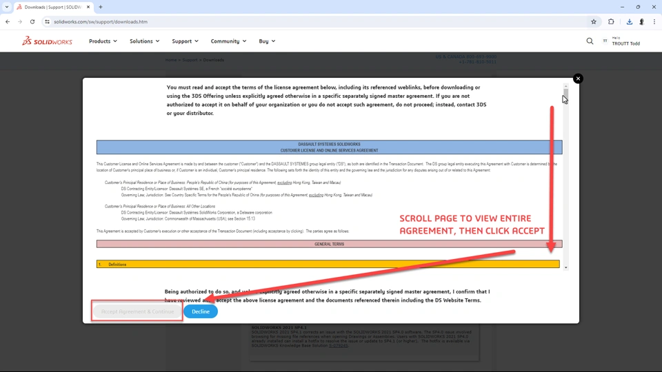

1. Go to the SOLIDWORKS Downloads page and click Log In
2. You can create a 3DEXPERIENCE ID here if needed, or sign in with your existing ID
3. Read and accept the Customer License and Online Services Agreement

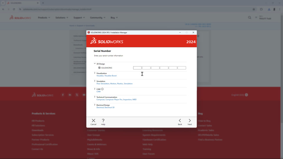

6. Enter your SOLIDWORKS serial number next. Refer to to order confirmation email for the 16-digit number. Tip: You can copy the entire number (with spaces) and paste it in after clicking in the first empty box. Also, you can enter additional serial numbers for products you may have purchased.

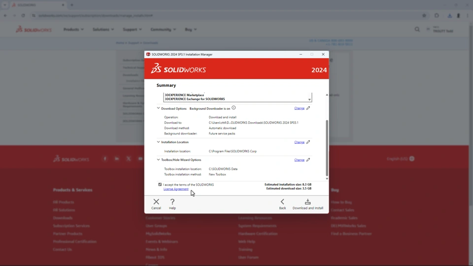

7. At the Summary page, you can edit the details of what will get installed, view options for download location and the Background Downloader (for future updates), the install location, and the Toolbox/Hole Wizard Options. For a new installation, most of these can be left as default options. Click to accept the terms of the SOLIDWORKS License Agreement and then click Download and Install.
8. The download of all the files and the installation will take a few minutes, depending on your internet speed and your computer/hard drive speed.

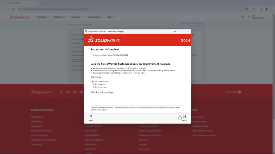

9. Once complete, you can take a look at the What’s New document if you want, and join the Customer Experience Improvement Program to provide feedback that directly helps make SOLIDWORKS Design run better.
