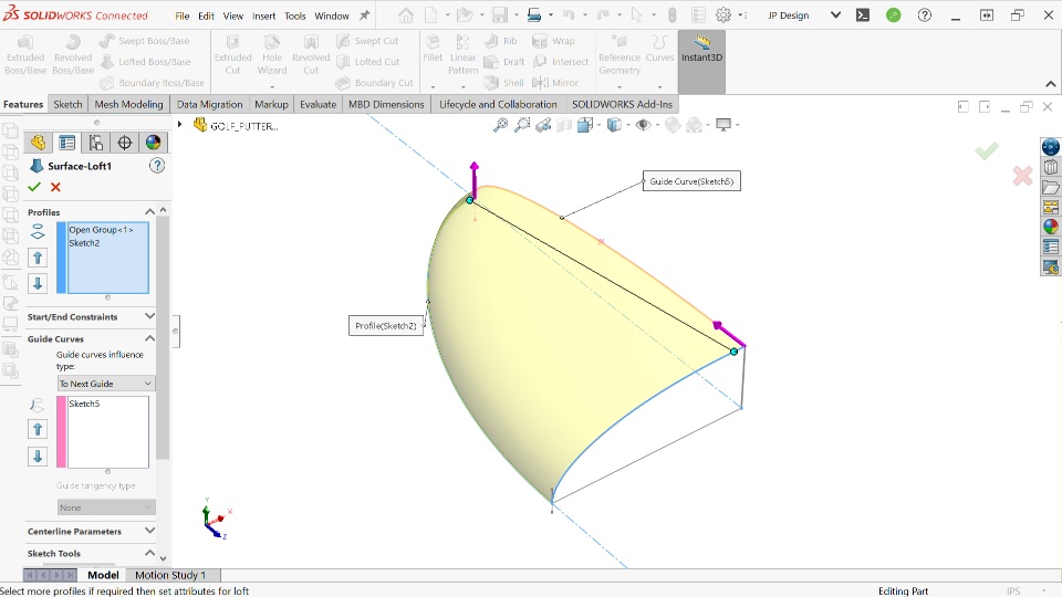

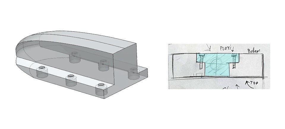

To kick off this design I decided to dive straight into SOLIDWORKS.  I started with a few simple sketches, and then used a surface loft with guide curves to almost immediately get the shape I wanted.
Even at this early phase it is important to use the correct size and proportions, I try not to let rules hinder the creative process, but it is important to setup some boundaries to make sure that the design will meet the specifications set out in phase 1.

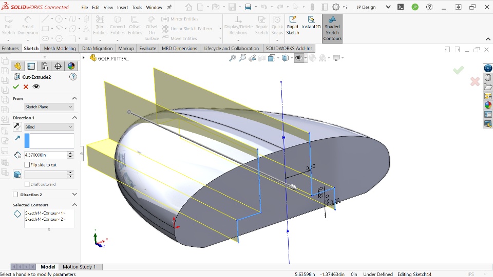

To create the transparent channel, the putter is made up of multiple parts. I needed a way to connect all these units together, so I created a “top-hat” shaped central part which creates the channel, but also acts as a bridge for all the parts connecting and blending together.

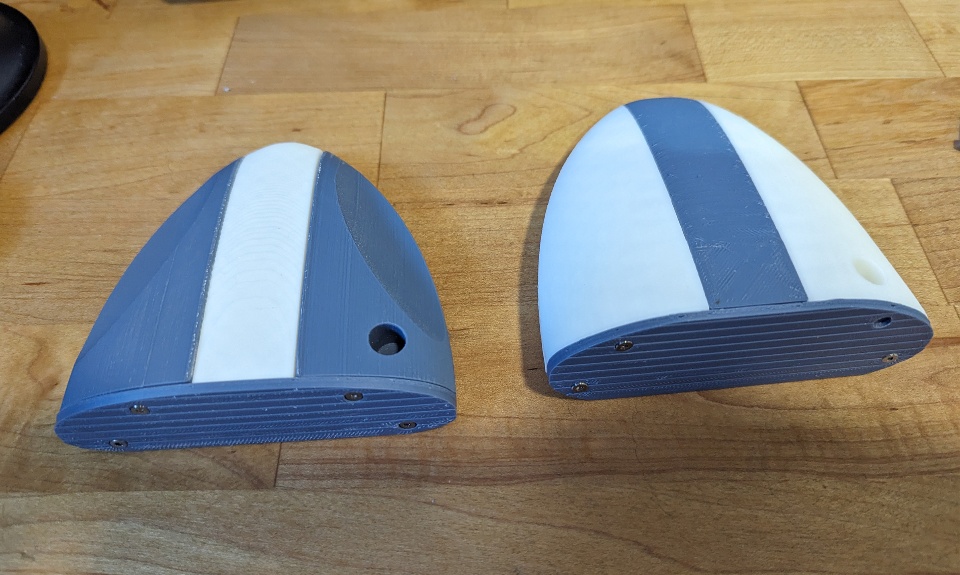

I find it helpful to create 3D prints of my designs as soon as possible.  I do this to make sure I am working with the correct dimensions, to get hands-on, and really get a feel of the design I am creating.  By doing this I ensure that I am not wasting time by heading in the wrong direction.
After putting around the shop with the prototype (someone has to do it), the putter felt good, but I realized that my putter is a little too large and lacks a bit of style.
With this new knowledge I created a list of adjustments and then jumped back into SOLIDWORKS to start the redesign.  Once these tasks were completed, it was back to the 3D Printer to play, I mean test out the putter.
I was super impressed with this updated design, which increased my motivation to continue on my path.
