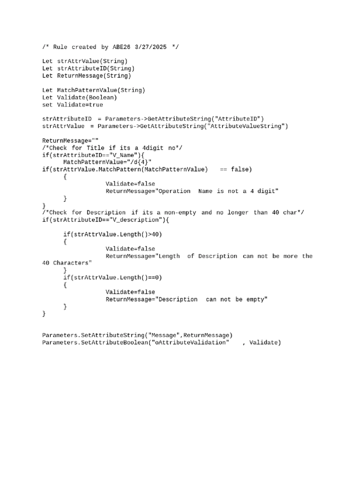

Validation Logic:
For V_Name Attribute:
  • The script checks if the AttributeValueString matches the pattern /d{4}, which means it expects exactly 4 digits.
  • If the value does not match this pattern, the validation fails, and the ReturnMessage is set to "Operation Name is not a 4 digit".
For V_description Attribute:
  • It checks if the length of the AttributeValueString is more than 40 characters. If it exceeds 40, the validation fails, and the message is "Length of Description cannot be more than 40 Characters".
  • If the value is empty, the validation fails, and the message is "Description cannot be empty".

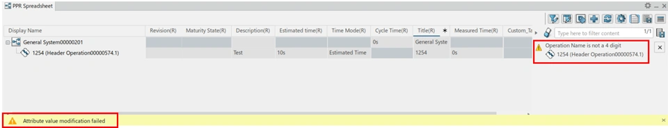

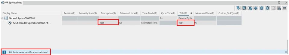

When user tries to edit Header operation Title to “Header1” in PPR Spreadsheet editor. The BL is triggered, and the value will not be modified, and the error can be seen in Report Manager.

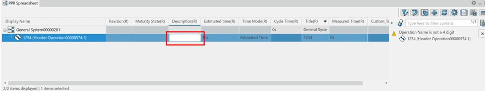

When user tries to edit Header operation and makes Description empty in PPR Spreadsheet editor. The BL is triggered, and the value will not be modified, and the error can be seen in Report Manager.
Now, user corrects the Title or adds the Description
After the user corrects the errors, and all validations pass, the Header Operation (HOP) is successfully edited with the Title (e.g., "4254").
Logic to validate the Title attribute is filled with 4digits
if(strAttributeID=="V_Name"){
          MatchPatternValue="/d{4}"
if(strAttrValue.MatchPattern(MatchPatternValue) == false)
                    Validate=false
                    ReturnMessage="Operation Name is not a 4 digit"
Logic to validate the Description attribute is non-empty and no longer than 40 chars
if(strAttributeID=="V_description"){
       if(strAttrValue.Length()>40)
             Validate=false
             ReturnMessage="Length of Description can not be more the 40 Characters"
       if(strAttrValue.Length()==0)
             Validate=false
             ReturnMessage="Description can not be empty"

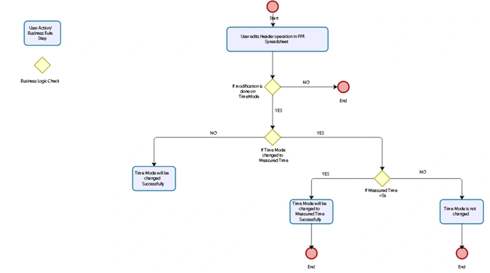

Example 2:
This example is of attribute dependency validation, where the value of one attribute affects the validation of another attribute. This kind of validation ensures that certain conditions are met before allowing a change or modification
No Use Case
1Ensure if Time Mode is changed to “Measured Time” then Measured Time should be greater than 0s
Here we have modified the OOTB script “PPRSpreadsheetAttributeValidation_ID”  to validate the attribute values of General Operation if modification is done in PPR Spreadsheet.
In similar way it is possible to validate an OOTB/ Custom attribute on an OOTB/ Custom type.
Logical Flow
Business Rule Sample
Detail Explanation
Validation Logic:
  • Measured Time Validation:
    • Check if Mode is changed to “Measured Time”. If yes, then Check if Measured Time value is greater than 0s
    • If its value is <=0s, the modification of value will not happen, and Error can be seen in Report Manager

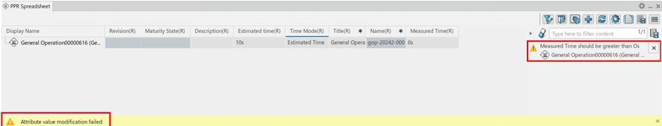

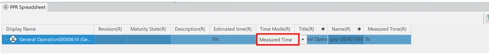

When user tries to edit General operation Change Time Mode to “Measured Time” in PPR Spreadsheet editor.
Following checks on attributes are done before General operation is modified [BL is called]:
  • If Time Mode is “Measured Time” then “Measured Time” should be greater than 0s
As above conditions are not met, modification will fail, and error can be seen in Report Manager.
Now, user adds non-zero Measured Time and changes TimeMode to Measured Time
After the user corrects the errors, and all validations pass, the General Operation is successfully modified

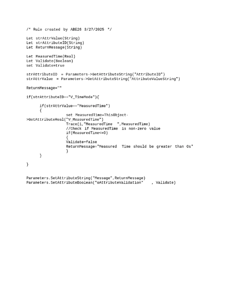

Logic to validate Time Mode and Measured Time
if(strAttributeID=="V_TimeMode"){
          if(strAttrValue=="MeasuredTime")
                    set MeasuredTime=ThisObject->GetAttributeReal("V_MeasuredTime")
                    Trace(1,"MeasuredTime ",MeasuredTime)
                    //Check if MeasuredTime is non-zero value
                    if(MeasuredTime<=0)
                    Validate=false
                    ReturnMessage="Measured Time should be greater than Os"

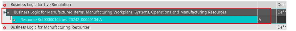

Business Rule Deployment
The below page can be referred for Business Rule deployment.
How to Deploy Business Rule
For deployment using Data Setup app following Resource set ID and opening needs to be used:
Resource Set ID:
Opening:
