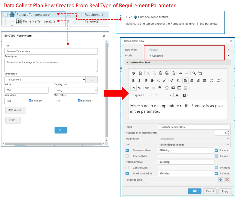

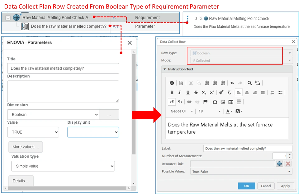

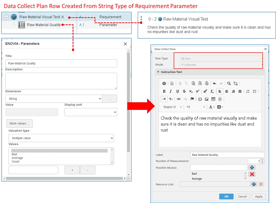

A. Using Requirement Parameters to Initialize Data Collect Plan Row's Attributes
The sample script provided here supports the use of Requirement Parameters to initialize the attributes of Data Collect Plan Rows.
  • It supports the parameters of type Real, Integer, Boolean and String.
  • Also, it supports single value as well as multi value requirement parameters.
  • From Requirement Parameters, it can take Target Value (For Real Type of Parameters), Possible Values (For Integer, Boolean and String Type of Parameters), Minimum Value (For Real and Integer Type of Parameters) and Maximum Value (For Real and Integer Type of Parameters)
Note: To know "How to create Requirement Parameter" follow the section "Creating Requirements Manually using "Requirements Widget" on this page
Examples

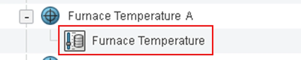

  • DCPR Created from Real Type of Requirement Parameter

  • DCPR Created from String Type of Requirement Parameter
  • DCPR Created from Boolean Type of Requirement Parameter

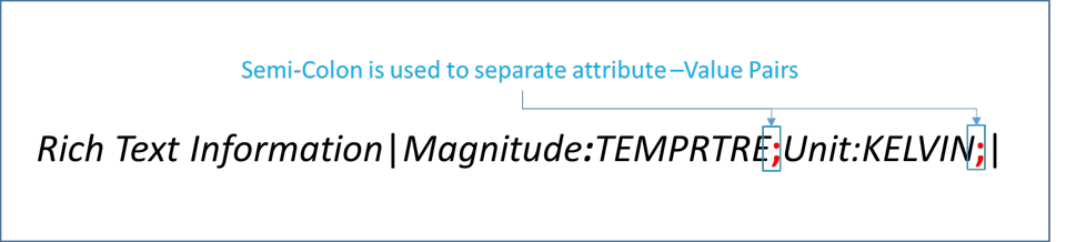

  1. "|" (Pipe): Pipe is used to separate the attribute information from the rich text. In rich text of Non-FTA Requirement, one need add the information of attributes after the rich text in between two pipes. For example:
  2. ":" (Colon): Colon is used as the separator between an Attribute and its value in the Attribute Information part of the rich text. For example:
  3. ";" (Semi-Colon): Semi-Colon is used as the separator between two attribute-value pairs. For example:

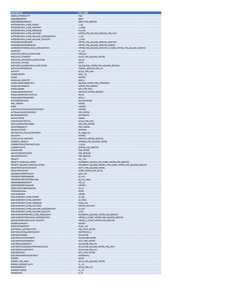

  4. "Magnitude": Magnitude of measurement to be taken. It should be as given in the excel file "Keywords for Magnitude and their MKS Units in 3DExperience Platform" given below. For example, TEMPRTRE for Temperature. Magnitude is needed for Real Type of DCPR only.

The "Magnitude" section can be non-intuitive and not understood in a 'natural' way by 3DExperience, for example, Temperature must be entered as 'TEMPRTRE' for it to be understood by the BL. Here an exhaustive list of these magnitudes and the corresponding MKS unit.

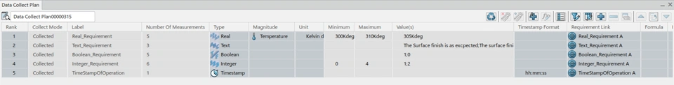

Here is an example of a non-FTA requirements:
When the above requirements were assigned to the Data Collect Plants, the Data Collect Plan Rows got created were as given below:
