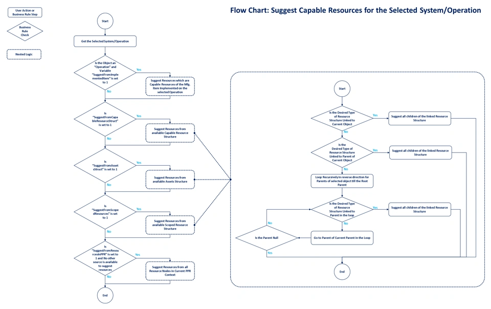

Sources Used to Suggest Capable Resources
In the provided sample business logic, five sources are considered for suggesting capable resources:

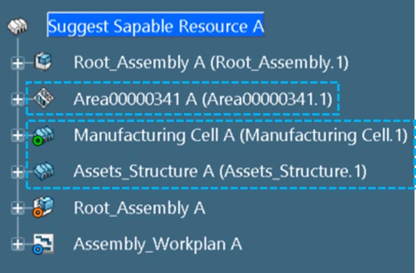

Capable Resources of All Manufacturing Item which are Implemented on the selected operation
Resources from the "Capable Resource Structure" – either linked directly to the selected object, its parent system, or the first upper-level linked "Capable Resource Structure"
Note: All the children of found "Capable Resource Structure" are suggested in the list
Resources from the "Assets Structure" – either associated with the selected object, its parent system, or the first upper-level linked "Assets Structure"
Note: All the children of found "Assets Structure" are suggested in the list
Resources from the "Scoped Resource" – either scoped to the selected object, its parent system, or the first upper-level scoped resource
Note: All the children of found "Scoped Resource" are suggested in the list
If none of the above sources are available or the suggested resource list is empty, then suggests Resources from All Resource Nodes available within the current PPR context
Note: All the children of found Resource Nodes are suggested in the list
To enable to suggest resources from all the resource nodes in the current PPR structure (Source 5) along with all aforementioned sources (Source 1-4), remove the following highlighted part of the condition available in the provided sample script.

Managing from Where to Suggest the Capable Resources
The source used to suggest capable resources for the aforementioned options can be managed through preference variables defined in the provided sample business logic, as listed below:
/*------Preferences to suggest Capable Resources-----------------*/
SuggestFromCapableResourceStruct = 1 //Set to 1 to allow sugget capable resources from 1st Upper Linked "Capable Resource Structure"
SuggestFromAssetsStruct = 1 //Set to 1 to allow suggest capable resources from 1st Upper Linked "Assets Structure"
SuggestFromScopedResources = 1 //Set to 1 to allow sugget capable resources from 1st Upper Scoped Resource Structure
SuggestFromResourcesInPPR = 1 //Set to 1 to allow sugget capable resources from Root Resource Nodes in the PPRContext
SuggestFromImplementedItem = 1 //Set to 1 to allow sugget capable resources from Implemented Capable ResourceTo disable suggestions from a specific source, set the corresponding variable's value to "0". By default, resources are being suggested from all the sources.
In the BL, the parameter "OutputIsButtonVisible" (Value can be "true" or "false") is used to manage whether to show the button to show the button to suggest the capable resources and the parameter "OutputListOfResourceReferences" (Value is a "List") is used to upend the list of resources to suggest as capable resources.

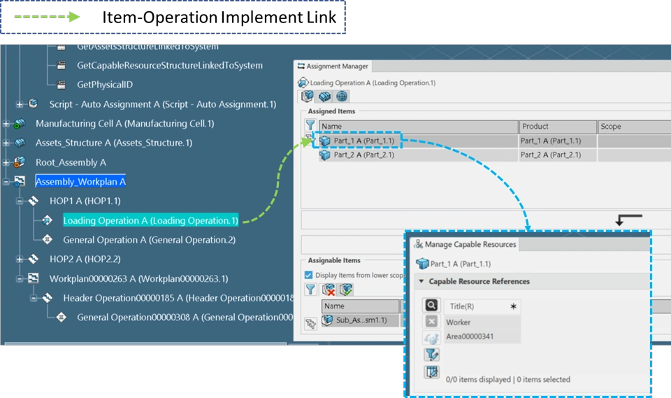

Scenario 1: "Manage Capable Resources" command launched for a Step Operation
When a Step operation is selected, it will show the button to suggest capable resources. A "Notification" is also displayed to show the sources from where the resources are being suggested.
After clicking on the button to suggest capable resources, it will suggest the resources from all the possible sources.

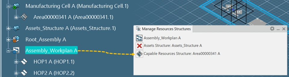

Scenario 3: "Manage Capable Resources" command launched for a child Workplan/System (With no Resource Scoped, With no Capable Resource Structure and no Assets Structure) of Root System
When a Workplan or System is selected, it will show the button to suggest capable resources. A "Notification" is also displayed to show the sources from where the resources are being suggested.
Scenario 4: "Manage Capable Resources" command launched for Workplan/System (With Resource Scoped, With Capable Resource Structure and Assets Structure)
Scenario 5: "Manage Capable Resources" command launched for object which have no Scoped Resource Link, Capable Resource Link, Assets Structure Link and no Capable Resources from Implemented Mfg. Items
When an object is selected, which don't have any Scoped Resource (Linked to Itself, it's parent or in first upper scope) or Linked Capable Resource Structure (Linked to Itself, it's parent or in first upper link) or Linked Assets Structure (Linked to Itself, it's parent or in first upper link) or Capable Resources coming from the implemented Mfg. Items, then it will suggest the resources from all the resource nodes available in the current PPR Structure.
Selecting and assigning the Capable Resources from Suggested Resources
From the suggested resource, any number of resources can be selected to be assigned as capable resources and after clicking on the "OK" button, the capable resources will be assigned on the selected object.
