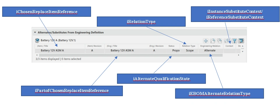

Key Input Parameters:
ParameterTypePurpose
iChosenReplaceItemReferenceObjectThe alternate item being selected as replacement
iPartofChosenReplaceItemReferenceObjectThe part associated with the alternate
iAlternateQualificationStateStringTells whether the alternate is Proposed, Qualified, or Obsolete
iEBOMAlternateRelationTypeStringTells the type of replacement (Alternate, Reference Substitute, Instance Substitute)
iRelationTypeStringHow the replacer item and part are related (e.g., Scope, Resulting Product)
iInstanceSubstituteContextObjectOnly used if it's an Instance Substitute
iReferenceSubstituteContextObjectOnly used if it's a Reference Substitute
Output Parameter:
oReplaceValidationStatusStringFinal answer - "Yes" or "No" to the replacement

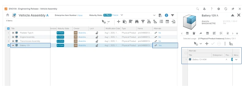

  1. Using the Engineering Release app to create an EBOM for a vehicle part.
  2. Defining alternates/substitutes (e.g., alternate battery or radiator) on EBOM.

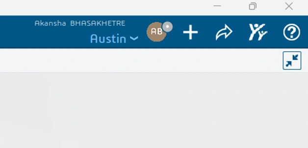

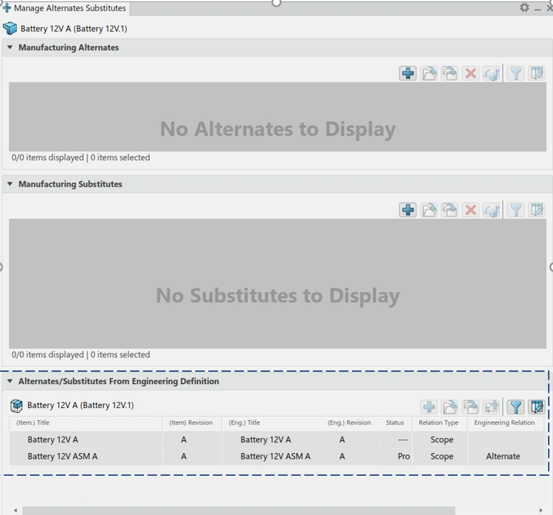

  3. Logging in to the Austin site.
  4. Creating MBOM for Austin site using Create/update item structure command as shown and MBOM is created

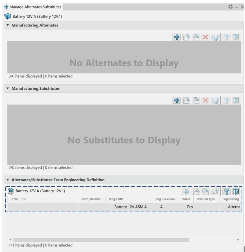

  5. Launch Manage Alternate Substitute command from Authoring Tab
    This will show the alternate engineering part in the command whose part is not yet created

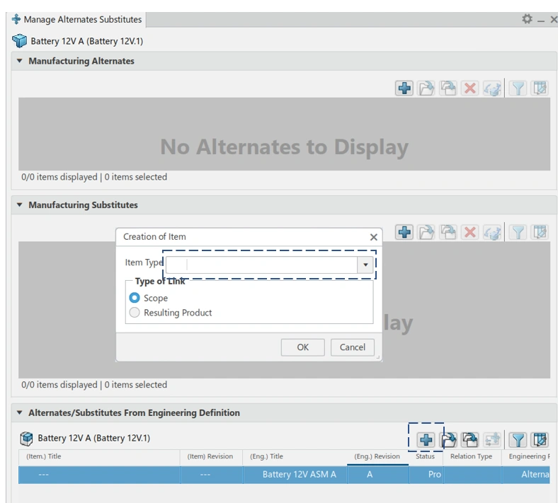

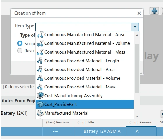

  6. Click on Add button and select the required OOTB or custom type

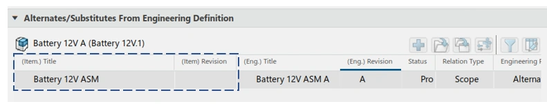

The item for alternate part is created as seen in (Item) Title icon

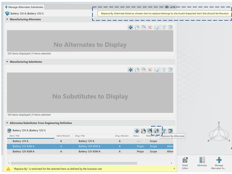

7. Now select the item and use Replace by Alternate command to replace one part with its alternate.
Item is replaced by alternate part and item is created in Austin Site

BUT here's the problem:
 You accidentally pick an alternate part that was provided by Austin, not Houston.
This would break plant-level traceability and introduce a site mismatch.

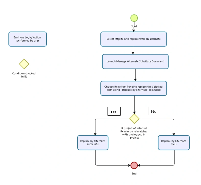

What Does This BL Do?
This Business Logic (BL), linked to the Opening ID DELMA_ReplaceByAlternate_Validation_ID, blocks replacement if the chosen alternate part was provided by a different plant/site.
In simple terms:
You can only replace a part with an alternate from the same site/project - no cross-site replacements allowed.
Without BL:
The system might allow this - even though Houston has no authority over Austin’s part.
With BL:
The system checks:
  • CurrentItemReference.project = Houston
  • ReplacerItemReference.project = Austin
  • Blocked with message:
    "Replace By Alternate failed as chosen item to replace belongs to different plant"
How It Works – Behind the Scenes
Triggered When:
  • User clicks Replace by Alternate from the Manage Alternates/Substitutes panel.
⚙️ The BL Checks:
  • The site/project of the current part (e.g., Houston).
  • The site/project of the selected alternate (e.g., Austin).
  • If they match, the replacement is allowed.
  • If they don’t match, it’s blocked, and the user is notified.

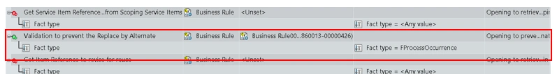

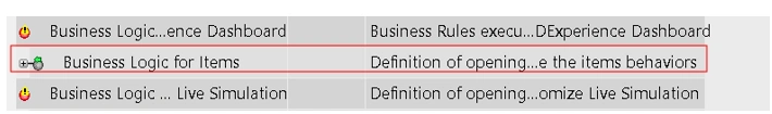

Business Rule Deployment
You may refer the below page for Business Rule deployment.
How to Deploy Business Rule
For deployment using Data Setup app following Resource set ID and opening needs to be used:
  • Resource Set ID:
  • Opening ID:
  • Fact Type:
Deploy the BL using Data Setup for "Fact type" = "FProcessOccurrence"
