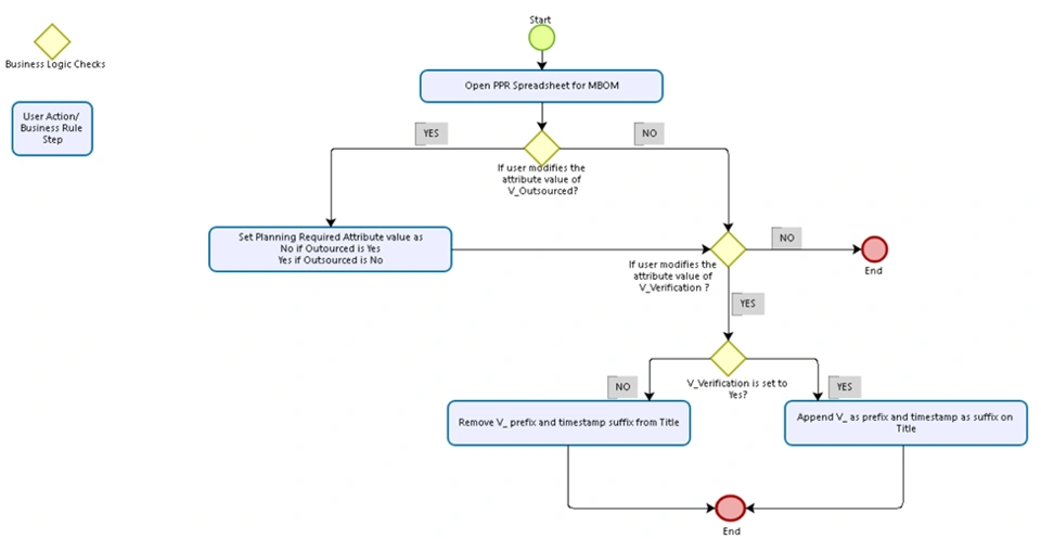

This business logic (BL) will handle the following use cases related to attribute dependency:
Handling Attribute Dependencies:
  • If the Outsourced attribute is set to Yes, the Planning Required attribute should automatically be set to No and vice-versa
  • If the custom attribute Custom_Verification is set to Yes, the Title attribute will be prefixed with "V_" and suffixed with a timestamp.
  • If the custom attribute Custom_Verification is set to No, the V_ prefix and timestamp suffix will be removed from the Title attribute.

Logical Flow
Business Rule Sample

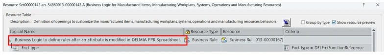

For deployment using Data Setup app following Resource set ID and opening needs to be used:
Resource Set ID:
Opening:
