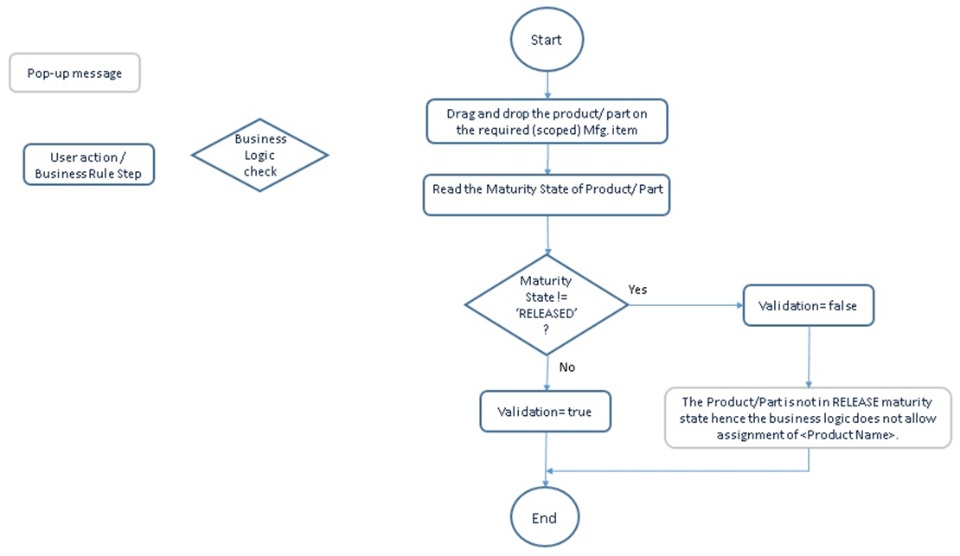

Example: Product Assignment Validation using Maturity State
The below example describes how we can apply restrictions to assign a product/ part depending on the Maturity state. If the product/ part has Maturity state other than 'RELEASED' then the assignment is not allowed. The assignment is allowed only for 'RELEASED' Maturity state.

We can control the assignment of any product/ part with some particular Maturity State.
Here, the assignment of only a product/ part with Maturity State 'RELEASED' to Mfg. item is allowed.
When we drag and drop the product not in 'RELEASED' maturity state on the Mfg. item the business rule makes the validation 'false' and we get a Message on the screen saying "The Product/Part is not in RELEASE maturity state hence the business logic does not allow assignment of

Scenarios:
| Maturity State | Result | |
| Scenario1 | RELEASED | The assignment is allowed.
| Scenario2 | any other value | The assignment is not allowed. Return message: The Product/Part is not in RELEASE maturity state hence the business logic does not allow assignment of |
One can change the check used in validation condition (if the maturity = "Released") with some other maturity state like frozen or with some other required attribute as per the requirement.

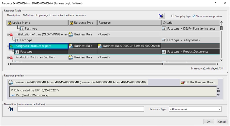

Business Rule Deployment
The below page can be referred for Business Rule deployment.
For deployment using Data Setup app following Resource set and Opening needs to be used
Resource Set ID:
Opening:
