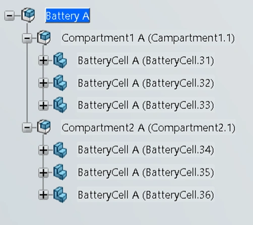

Let's consider the example data set given below.

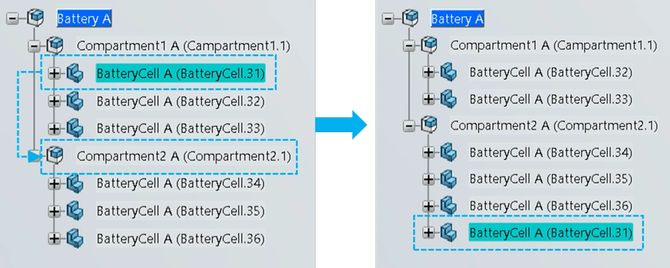

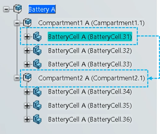

If the 3DPart "BatteryCell.31" instance is dragged and dropped from "Compartment1" to "Compartment2" as given below:
Then the Instance ""BatteryCell.31" will be renamed to "BatteryCell.1" as given below:

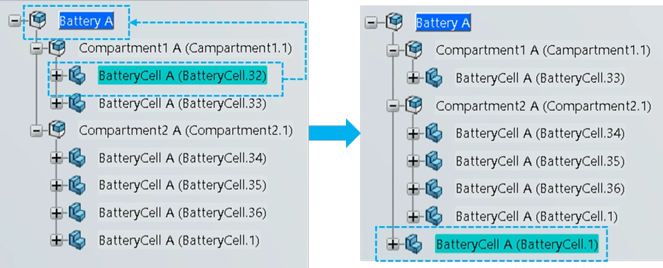

Similarly, if the 3DPart "BatteryCell.32" is moved under the root "Battery", it will be renamed to ""BatteryCell.1"
This conduct may be inappropriate when the "Manage Item - Product Links Inconsistency" command is attempting to locate a Physical Product Instance for rerouting on the inconsistent link. As the search is performed with the Instance Name of the previously linked Physical Product.

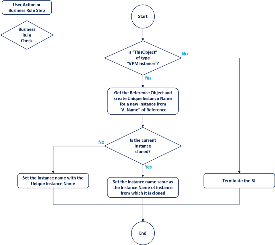

When the BL is triggered, it checks if the BL is triggered for "VPMInstance" or not. If the BL is triggered for any other Fact Type, the BL gets terminated.

If the object is "VPMInstance", take the instance and its "Reference". Using the V_Name of the reference, generate a unique instance name which can be used to name the instance of the object if it is created "Newly".

If the object is "Cloned" (Duplicated), then set the "Instance Name" of the current instance with the "Instance Name" of instance from which it was cloned. Else, set the "Instance Name" of current instance with the unique name generated from the "V_Name" of the reference.

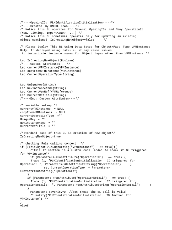

Sample BL
Sample Business Logic
Important Note:  The Opening ID "PLMIdentificationInitialization" gets triggered when any type of PLM Object is created (New, Clone or other operations). When the Opening ID "PLMIdentificationInitialization" gets triggered, it tries to find the BL "PLMIdentificationInitialization.CATRule" in the "3DExperience_Installation\\win_b64\\resources\\knowledge\\scripts" folder. If the BL is not available, it goes for type specific BLs to manage the Attributes Initialization. For example, BL "ENONT_VPMReference_BLInitialization.CATRule" is called for "VPMReference". However, if the BL "PLMIdentificationInitialization.CATRule" is available in "3DExperience_Installation\\win_b64\\resources\\knowledge\\scripts", then it gets called for each type of PLM object after creation and does not go to type specific Attribute Initialization BLs.
Due to the above reason, it is recommended to deploy this sample BL only using "Data Setup" for Fact Type as "VPMInstance". If the BL is deployed using "CATRule", it may cause issues to create objects of another types.
Logical Flow of Sample BL
