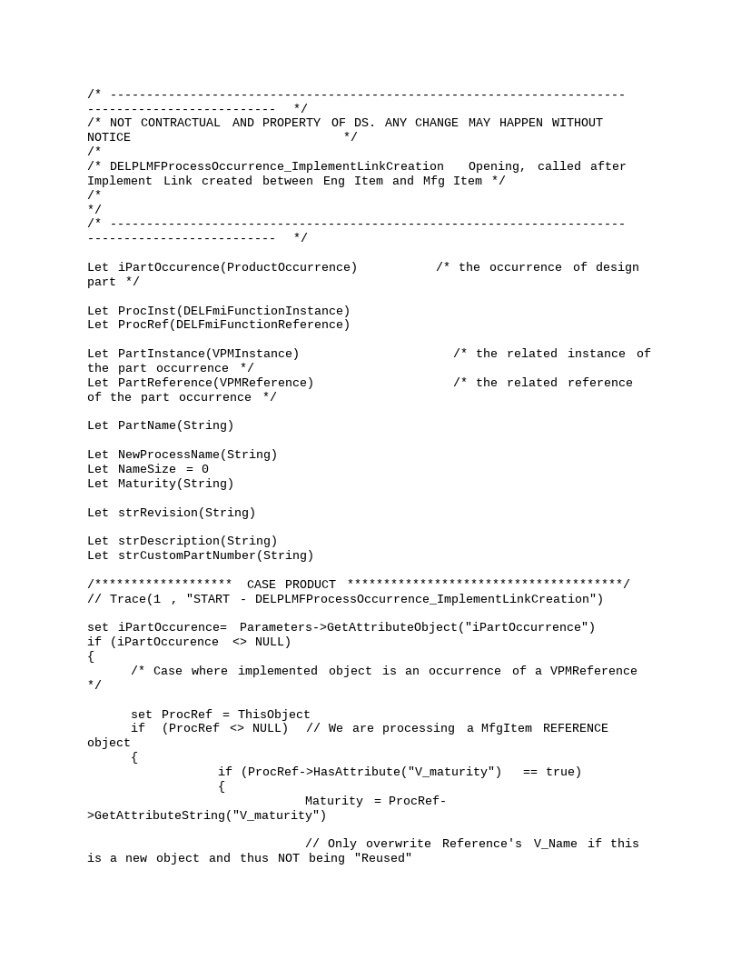

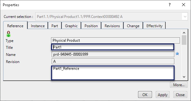

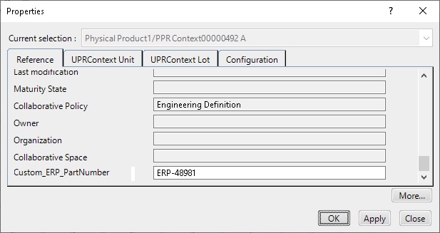

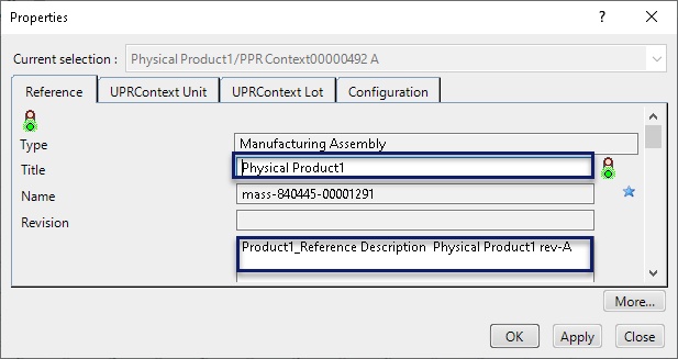

Example 1: Initialize reference attributes on MI from EI based on scope link
This example shows how the reference attributes on MI can be initialized by copying the useful reference attribute values from EI based on scope link.

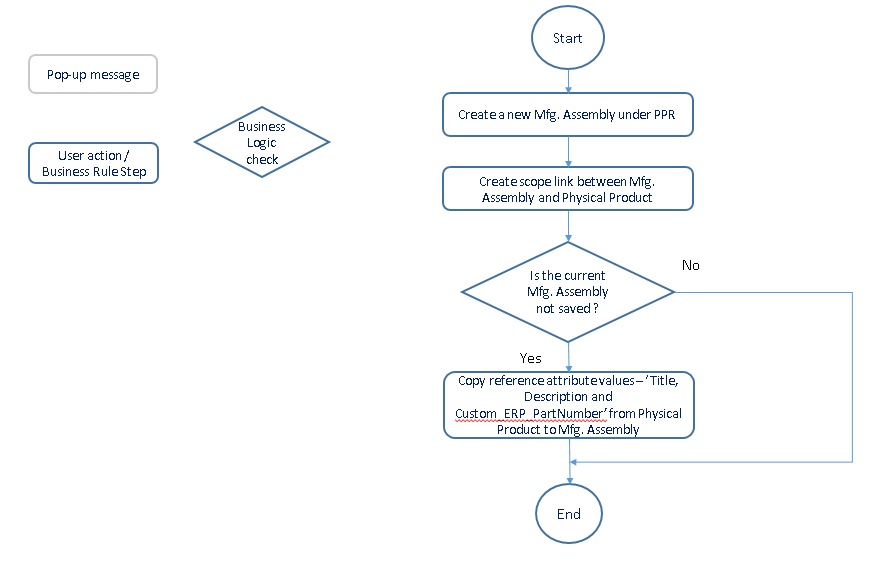

Example 1: Logical Flow
Example 1: Business Rule
DELPLMFProcessOccurrence_ImplementLinkCreationReference.CATRule
Detail Description:
When we create a scope link between MI and EI, this business rule gets invoked.
If the MI is created new and is not yet saved (no maturity state defined for it: maturity = “”), the ‘Reference Title’, ‘Reference Description’ and ‘Custom_ERP_PartNumber’ of MI are initialized to following values
  • Reference Title of MI = Reference Title of EI
  • Reference Description of MI = Reference Description of EI + Reference Title of EI + Revision of EI

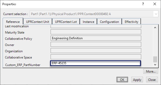

  • Custom_ERP_PartNumber of MI = Custom_ERP_PartNumber of EI (custom attribute on EI and MI reference)
Logic to check if MI object is not yet saved
if( Maturity == "" )
Logic to initialize Reference Title on MI
if ((ProcRef->HasAttribute("V_Name") == true) and (PartReference->HasAttribute("V_Name") == true))
               PartName = PartReference->GetAttributeString("V_Name")
               set  NewProcessName = PartName
               strRevision = PartReference->GetAttributeString("V_version")
               NameSize=NewProcessName.Length()
               if (NameSize>100)
                               NewProcessName=NewProcessName.Extract(0,96)+ "..."
               ProcRef.V_Name = NewProcessName
Logic to initialize Reference Description on MI
if ((ProcRef->HasAttribute("V_description") == true) and (PartReference->HasAttribute("V_description") == true))
      ProcRef.V_description =  PartReference.V_description + "  " + ProcRef.V_Name + " rev-" + strRevision
Logic to initialize Custom Reference Attribute - Custom_ERP_PartNumber on MI
if ((ProcRef->HasAttribute("Custom_ERP_PartNumber") == true) and (PartReference->HasAttribute("Custom_ERP_PartNumber") == true))
     strCustomPartNumber = PartReference.GetAttributeString("Custom_ERP_PartNumber")
     if(strCustomPartNumber <> "")
          ProcRef.SetAttributeString("Custom_ERP_PartNumber",  strCustomPartNumber)
In similar way we can extend this functionality to initialize a set of attributes on MI from EI according to the requirement based on scope link creation.

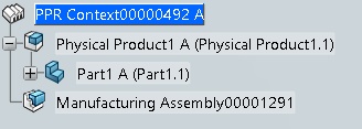

Example 1: Scenarios:
InputResults

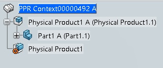

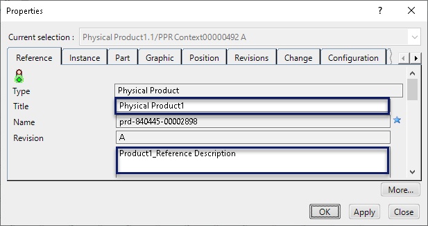

Scenario1:Create scope between Root EI and Root MI
The reference attributes Title, Description and Custom_ERP_PartNumber are copied from Physical Product1 to MI.
Scenario 2:Run CUPS command and select Root EI and Root MI
The reference attributes Title, Description and Custom_ERP_PartNumber are copied from Physical Product1 to MI.​​​​​​​

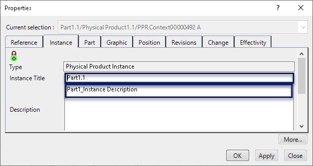

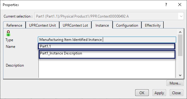

Example 2: Initialize reference attributes on MI from EI based on implement link
This example shows how the instance and reference attributes on MI can be initialized by copying the useful reference and instance attribute values from EI based on implement link.

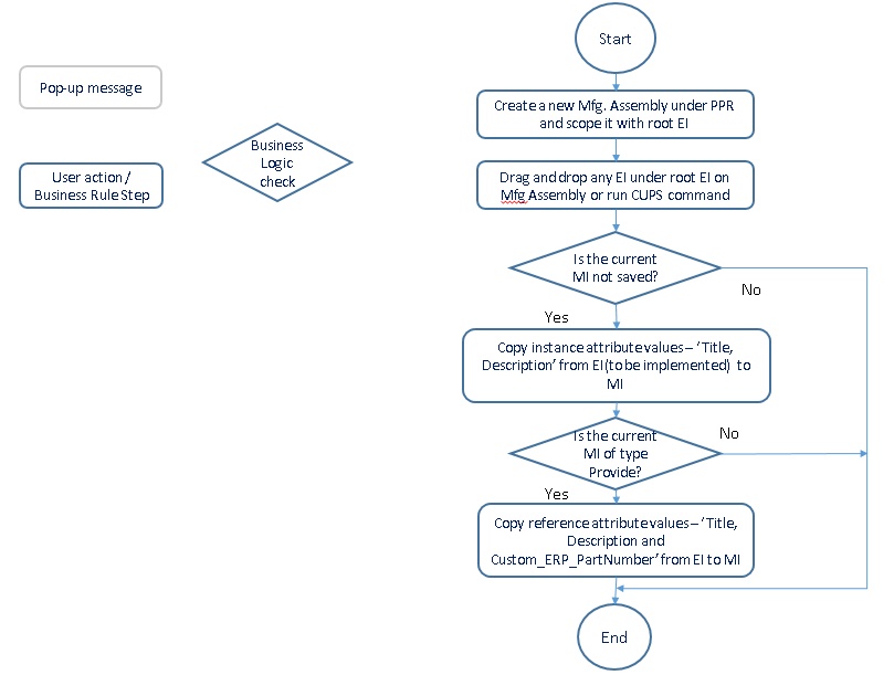

Example 2: Logical Flow

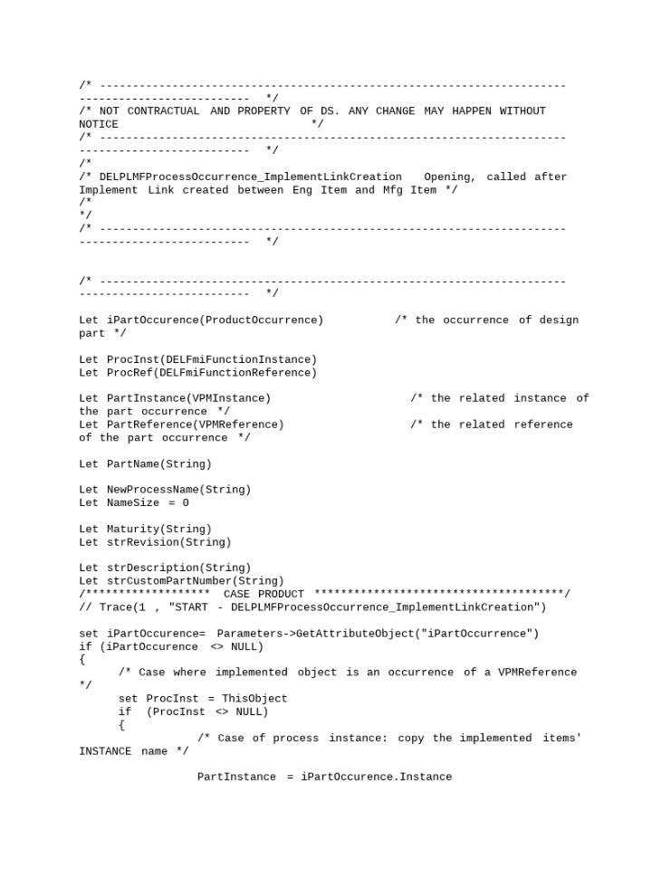

Example 2: Business Rule
DELPLMFProcessOccurrence_ImplementLinkCreationInstance.CATRule
Detail Description:
When we create an implement link between MI and EI this business rule gets invoked.
If the MI is created new and is not yet saved (no maturity state defined for it: maturity = “”), the ‘Instance Title’ and ‘Instance Description’ of MI are initialized to following values
  • Instance Title of MI = Instance Title of EI
  • Instance Description of MI = Instance Description of EI
Logic to initialize Instance Title on MI
if ((ProcInst->HasAttribute("PLM_ExternalID") == true) and (PartInstance->HasAttribute("PLM_ExternalID") == true))
        Trace(1 , "### Process instance naming")
        PartName = PartInstance->GetAttributeString("PLM_ExternalID")
        if (NameSize>100)
        ProcInst.PLM_ExternalID = NewProcessName
Logic to initialize Instance Description on MI
if ((ProcInst->HasAttribute("V_description") == true) and (PartInstance->HasAttribute("V_description") == true))
     ProcInst.V_description  = PartInstance.V_description

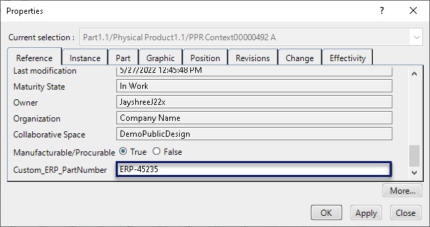

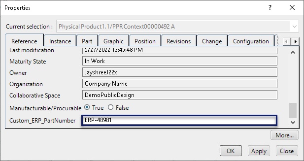

If the MI is of type ‘Provide’ then the ‘Reference Title’, ‘Reference Description’ and ‘Custom_ERP_PartNumber’ of Provide are initialized to those attribute values from EI.
  • Reference Title of Provide = Reference Title of EI
  • Reference Description of Provide = Reference Description of EI + Reference Title of EI + Revision of EI
  • Custom_ERP_PartNumber of Provide = Custom_ERP_PartNumber of EI (custom attribute on EI and MI reference)

Example 2: Scenarios:
InputResults

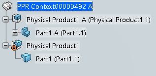

Scenario 1:Create implement link by drag and drop Part1 on Root Mfg. Assembly
The instance attributes Title and Description are copied from Part1 to Provided part.
The reference attributes Title, Description and Custom_ERP_PartNumber are copied from Part1 to Provided part.

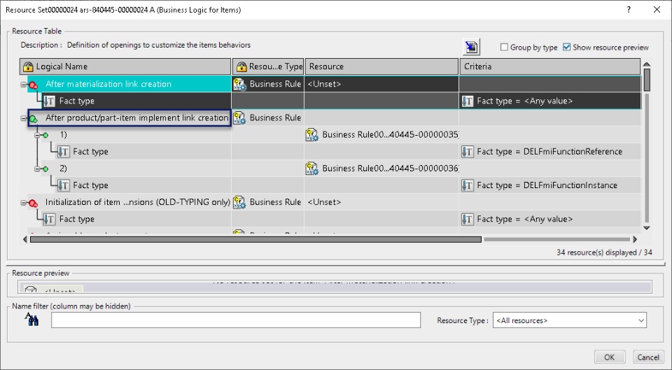

Business Rule Deployment
You may refer the below page for Business Rule deployment.
How to Deploy Business Rule
For deployment using Data Setup app following Resource set ID and opening needs to be used:
Resource Set ID:
Opening ID:
