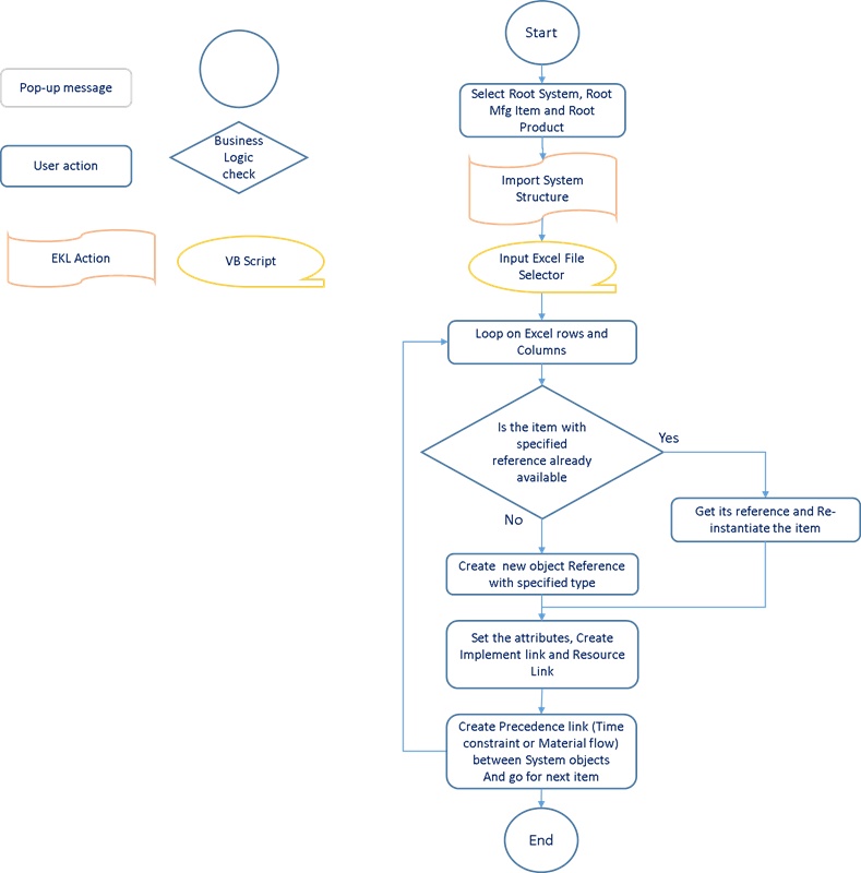

Logical Flow
Below is the logical flow for Import System Structure EKL script:
Example
Detail Explanation

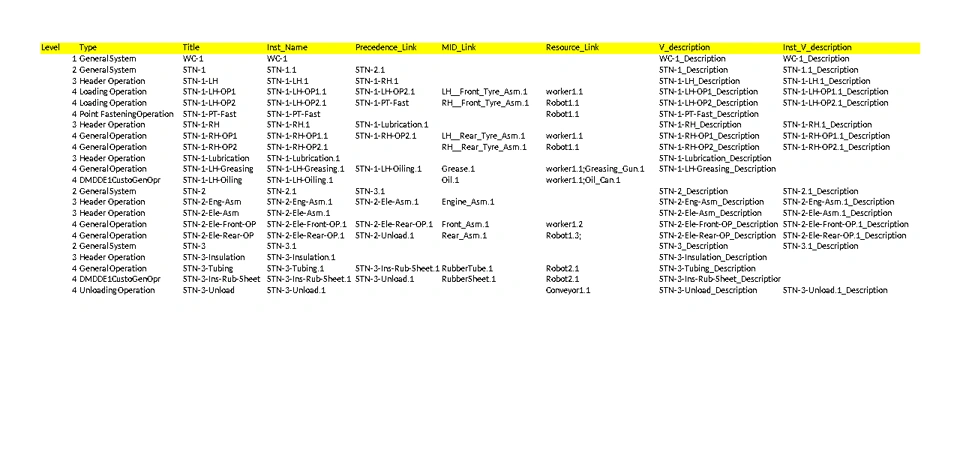

Excel template for Importing Resource Structure
The template excel format is as shows below:
The 1st 7 columns are reserved and necessary to be added. Their description is as given below:
| Column Title | Significance |
| Level | Defines level of object inside structure, 1 – Root 2 – First level child of root or child of level 1. 3 – Second level child of root or child of level 2. … N – Child of level N – 1. |
| Type | Type of object to create
| Title | V_Name of Object created |
| Inst_Name | V_Name / PLM_ExternalID of Object Instance created |
| Precedence_Link | Precedence link created between operations instance and material flow for system instance Can give multiple “;” separated instance names. |
| MID_Link | MfgItem instance name to link with created Operation. Can give multiple “;” separated instance names. |
| Resource_Link | Resource instance name to link with created Operation. Can give multiple “;” separated instance names. |
| Additional attributes | All other attributes (Internal name) to be set on created Object’s reference and instance. |
Note: If instance attributes value needs to be set then add “Inst_” keyword before attribute name. For example for instance description, it will be “Inst_V_description”

To set other extra attributes of the created objects, add extra columns in the excel file after column 7. 1st 7 columns are reserved for Level, Object type, Title(Reference Name), Instance name, Precedence link, MID Link and Resource link. While creating the column, column name should be the attribute name. Add the values in respective rows. While setting the column name for attribute of instance object, add “Inst_” as a prefix in the column name.
The EKL script manages to set the additional attributes if they are specified in the excel file. The condition is, the attribute should be available on the object. User can specify custom attributes also if available.
For example: Additional attributes to be set are highlighted in red box.
The code between below comment lines in attached EKL script is responsible for setting additional and custom attributes. It set both reference and instance object attributes.
//Logic to read remaining columns and set additional attributes

Precedence Link is created at the end after creating whole System Structure. A query is executed on Root System to get the Occurrence of System object to be linked. If both the objects are of type, General System, Material Flow is created. If both the objects are of Operation type, Time Constraint is created.
To modify the logic for precedence link, modify the code between below comments.
//-----START precedence link-----
//-----END precedence link-----Here under some Use Case about possible adaptation of the script

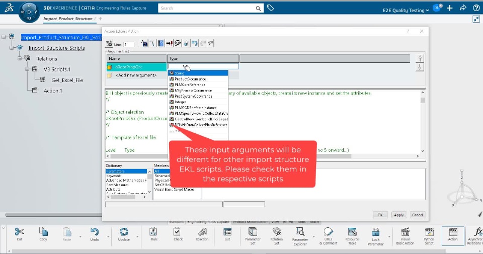

This video describes: How to deploy the "Import Product Structure from Excel?" EKL Script. However, the process is same for following EKL Scripts:
1. Import Resource Structure from Excel
2. Import Mfg. Item Structure from Excel
3. Import System Structure from Excel
(Note:
1. Instead of creating a separate Physical Product for containing each script, you can create the action files for the above three EKL scripts in the same Physical Product that we are going to create for "Import Product Structure from Excel" EKL Script.
2. The Excel File Selector VBScript is same for all the above EKL Scripts. So, you can create it only once and use it in all the above EKL Scripts.
3. The input arguments are different for different type of structure script. The information is provided in the respective EKL script as a comment at the top section.
