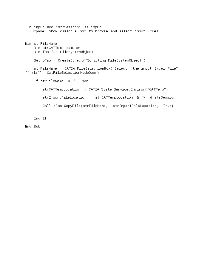

VB_Script for Excel File Selector

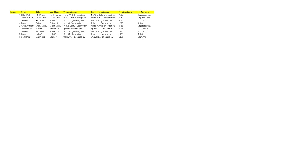

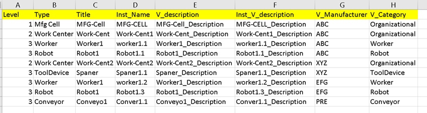

Excel template for Importing Resource Structure
The template excel format is as given below:
The 1st 4 columns are reserved and necessary to be added.  Their description is as given below:
Column Title Significance
Level
Defines level of object inside structure,
1 – Root
2 – First level child of root or child of level 1.
3 – Second level child of root or child of level 2.
N – Child of level N – 1.
Type Type of object to create
Title V_Name of Object created
Inst_Name V_Name / PLM_ExternalID of Object Instance created
Additional attributes All other attributes (Internal name) to be set on created Object’s reference and instance.

How to set additional attribute and other custom attributes:
To set other extra attributes of the created objects, add extra columns in the excel file after column 4. 1st 4 columns are reserved for Level, Object type, Title (Reference Name) and Instance name. While creating the column, column name should be the attribute name. Add the values in respective rows. While setting the column name for attribute of instance object, add “Inst_” as a prefix in the column name.
The EKL script manages to set the additional attributes if they are specified in the excel file. The condition is, the attribute should be available on the object. User can specify custom attributes also.
For example: Additional attributes to be set are highlighted in red box.

1. Requirement 1: Support CSV input file type.
 To support .csv file type instead of .xlsx, follow bellow steps.
  • Edit below string in the VBScript:
In the script, strFileName string specifies the input excel file type. Modify the extension of the file name to .csv
'For .xlsx
strFileName = CATIA.FileSelectionBox("Select the input Excel File", "*.xlsx", CatFileSelectionModeOpen)
'For .csv
strFileName = CATIA.FileSelectionBox("Select the input Excel File", "*.csv", CatFileSelectionModeOpen)
