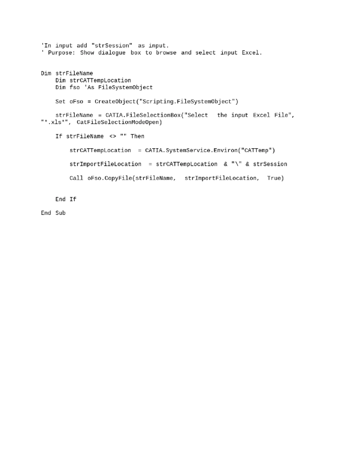

VB Script for Input Excel File Selector

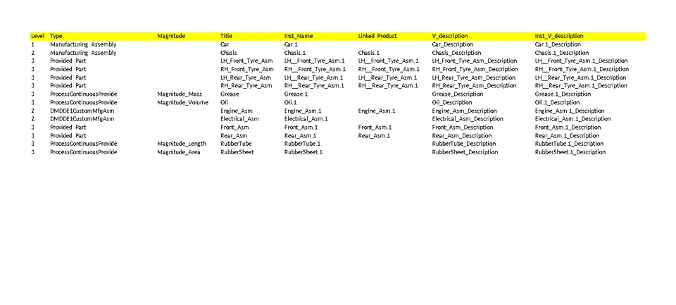

Template Excel format
The template excel format is as given below:
The 1st 5 columns are reserved and necessary to be added.  Their description is as given below:

TitleV_Name of Object created
Inst_NameV_Name of Object Instance created
Linked_Product
Linked product instance name to link with created Mfg. Item.
Can give multiple “;” separated instance names.
Additional attributesAll other attributes (Internal name) to be set on created Object’s reference and instance.
Note: If instance attributes value needs to be exported then add “Inst_” keyword before attribute name. For example for instance V_description, it will be “Inst_V_description”

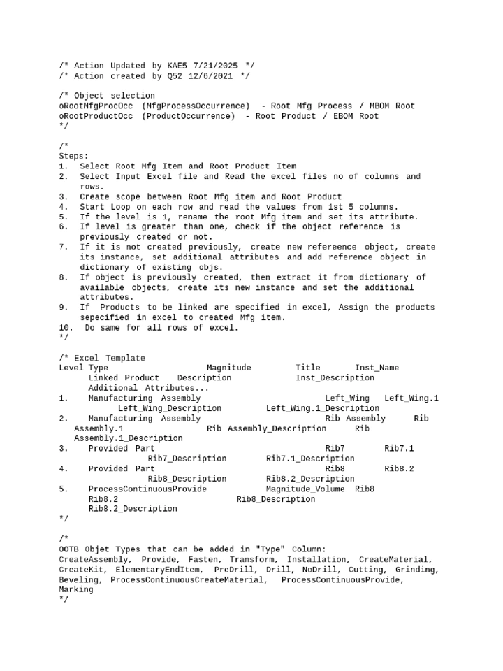

How to manage Multi-Instantiation
Steps followed for managing Multi-Instantiation:
Note: In the script, every time an new object is created, its reference is added in dictionary (Volatile instance) with V_Name(strPartNo) used as its key.
  1. Check if the reference with V_Name of item to be created is already available in Dictionary of existing objects.
  2. If the reference is not created previously, create a new reference and add it Dictionary of existing object. Set attributes of new objects reference and instance.
  3. If the reference with V_Name of item to be created is available in dictionary, extract it and create its new instance. Set the attributes of newly instantiated object.
In attached EKL script, user can find the code between below two comments. This code is responsible to manage multi-instantiation as described above.
/*-----------------Code to Manage Multi-Instantiation starts here--------------*/
/*--------------Code to Manage Multi-Instantiation Ends----------------*/

To set other extra attributes of the created objects, add extra columns in the excel file after column 5. 1st 5 columns are reserved for Level, Object type, Title, Instance name and Linked Products. While creating the column, column name should be the attribute name. Add the values in respective rows. While setting the column name for attribute of instance object, add “Inst_” as a prefix in the column name.
The EKL script manages to set the additional attributes if they are specified in the excel file. The condition is, the attribute should be available on the object. User can specify custom attributes also.
For example: Additional attributes to be set are highlighted in red box.
The code between below comment lines in attached EKL script is responsible for setting additional and custom attributes.
/*Below code will set additional OOTB/specialized attributes from column number 6 onwards*/
/* Setting specialized/custom attributes is finished */

1. Requirement 1: Support CSV input file type.
 To support .csv file type instead of .xlsx, follow bellow steps.
  • Edit below string in the VBScript:
In the script, strFileName string specifies the input excel file type. Modify the extension of the file name to .csv
'For .xlsx
strFileName = CATIA.FileSelectionBox("Select the input Excel File", "*.xlsx", CatFileSelectionModeOpen)
'For .csv
strFileName = CATIA.FileSelectionBox("Select the input Excel File", "*.csv", CatFileSelectionModeOpen)
  • In the EKL script, make following changes:
In the EKL script, strTempFileName variable of string type specifies the type of excel file to be created. Modify the below lines of code
//For .xlsx
strTempFileName = " MID_Structure_ " + strTemp3 + ".xlsx"
//For .csv
strTempFileName = " MID_Structure_ " + strTemp3 + ".csv"

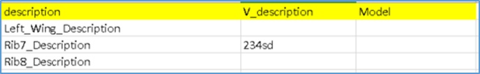

3. Requirement 3: Use custom column names instead of internal attribute name
If the user wants to use custom column names instead of internal attribute name, for example:
Here “description” is used instead of “V_description”
Add below line of code in the EKL script, where additional/custom attribute values are read from the excel file.
if strAttrName== "Description" or strAttrName == "description"
     strAttrName = "V_description”
else if strAttrName == "Inst_Description " or strAttrName == " Inst_description"
     strAttrName = “Inst_” + "V_description"
//for attributes of instance objects “Inst_” is added to the internal name
