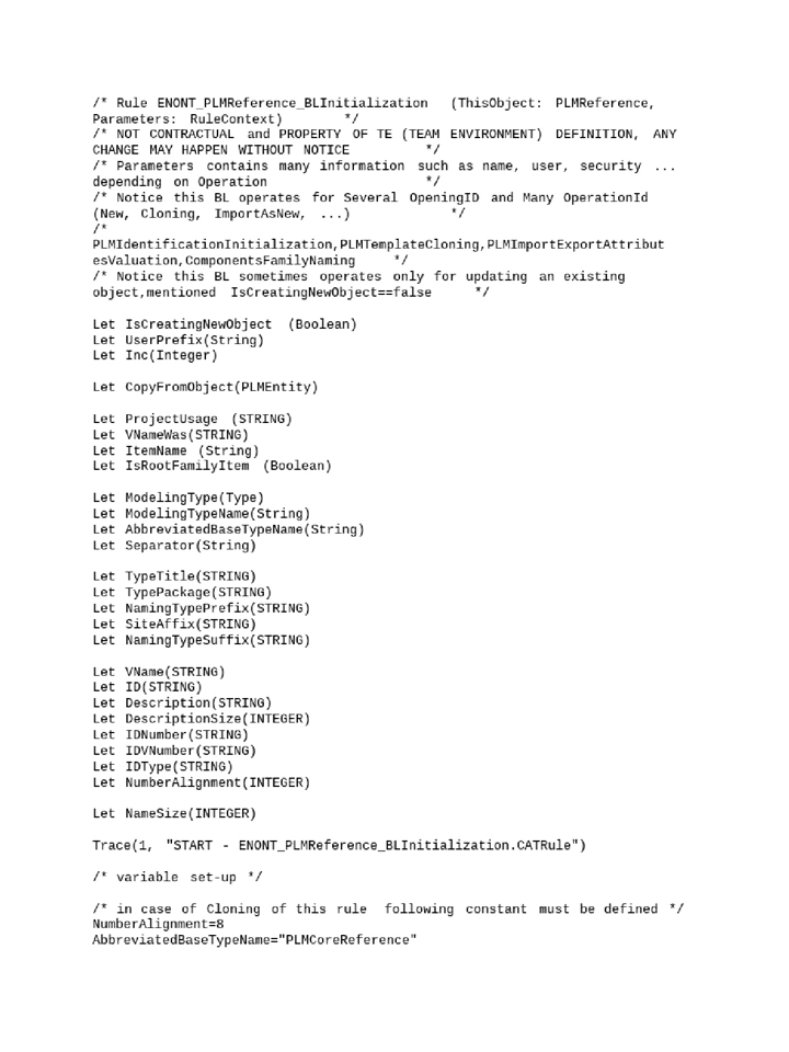

Here we have modified the OOTB script “ENONT_PLMReference_BLInitialization.CATRule” to set custom attribute ‘Test_Plant_ID’ on custom type ‘Test_CustoMfgAssembly’ (derived from CreateAssembly).
In similar way it is possible to initialize an OOTB/ Custom attribute on an OOTB/ Custom type.

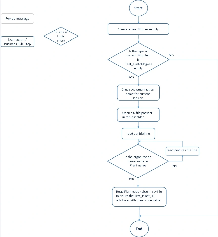

Example 1 Logical Flow
Below is the logical flow for Example 1 Business Rule
Example 1 Detail Explanation
If the plant name (first column in csv file) in the row matches with the current organization name, the Plant ID value for that matching row will be set on the object which is getting created/ cloned/ imported.
For example if the user has logged in with organization ‘”Barcelona”, when user creates a new object of type ‘Test_CustoMfgAssembly’ the BL reads the ‘Plant ID’ value for each row in the csv file. When the Plant Name matches “Barcelona” the attribute ‘Test_Plant_ID’ will be set to value “4502”.
Similarly we can have multiple columns in the csv file. We can use these different attribute values for initialize object attributes as per need of customization.

strFileContent = oConfigFile->Read()Logic to match the Plant name and set Plant ID value to attribute ‘Test_Plant_ID’
strListFileContent = SplitString(strFileContent, ",")
if(strListFileContent.Size() > 1)
strPlantNameFromFile = strListFileContent->GetItem(1)
if(OrgName == strPlantNameFromFile)
ThisObject->SetAttributeString("Test_Plant_ID",strListFileContent->GetItem(2))

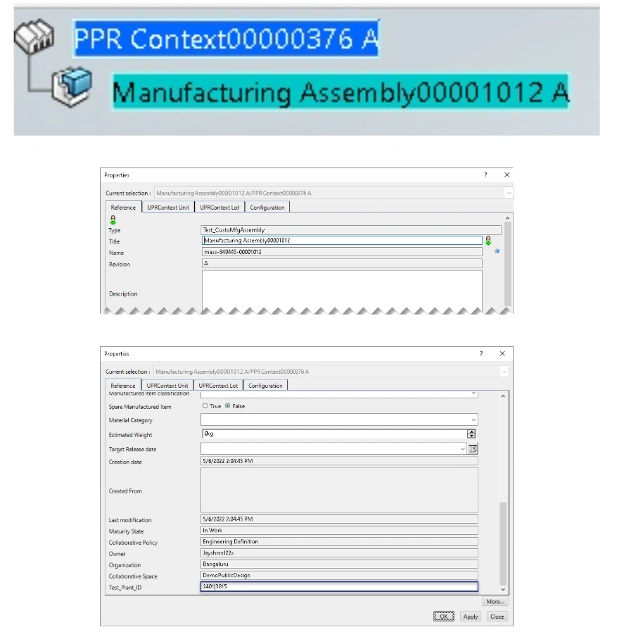

Scenarios:
| Scenario 1 | Mfg. Assembly - New Creation |
| Object creation steps | Please select organization 'Bangaluru' while starting a native client session. Click on the "+" icon in the upper right corner and New Content option from the down menu to create Test_CustoMfgAssembly reference object.
| Result |
| Comment | The Plant_ID attribute value (for Bangaluru Plant) is set with the value from the excel input file. |

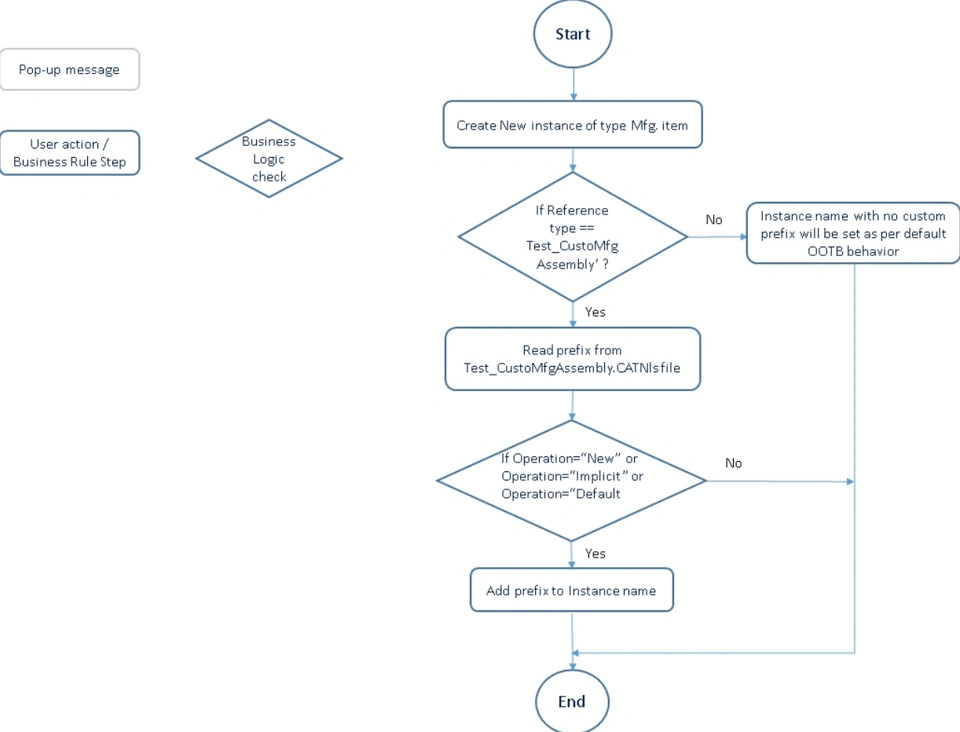

Example 2 Logical Flow

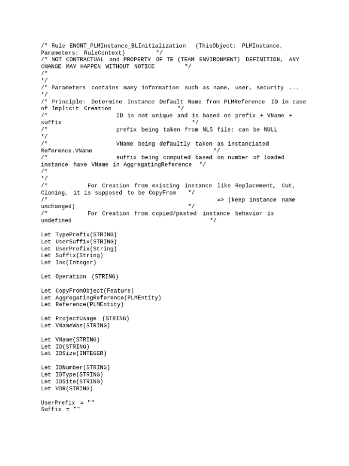

Example 2 Business Rule
Example 2 Detail Explanation

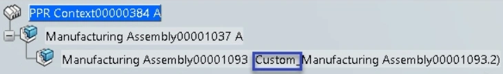

When we create a new instance of Mfg. Assembly then the instance name attribute gets initialized automatically using this OOTB Business rule.
Here we have modified/ cutomized the OOTB Business Rule "ENONT_PLMInstance_BLInitialization.CATRule".
When the object is being instantiated a Prefix is added to the instance name.
TypePrefix=""
if ( Reference <> NULL )
if (Reference->IsSupporting("Test_CustoMfgAssembly") == true)
TypePrefix=BuildMessageNLS("Test_CustoMfgAssembly","PLMInstance.Prefix")
else
TypePrefix=BuildMessageNLS("PLMEntity","PLMInstance.Prefix")
}The required prefix is stored in Test_CustoMfgAssembly.CATNls file for id PLMInstance.Prefix .
Please refer the below entry in CATNls file.
PLMInstance.Prefix = "Custom_";In similar way we can initialize any other OOTB or custom attribute on the supported types.

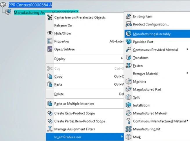

Scenarios:
| Scenario | Mfg. Assembly - New Creation |
| Result | |
| Comment | A new Mfg. Assembly instance is created with instance name prefix: Custom_ |
Similarly we can initialize attributes for above mentioned types.
Here we can see the instance name of Mfg. Assembly is initialized with the prefix “Custom_”.

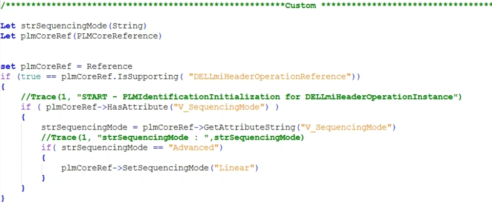

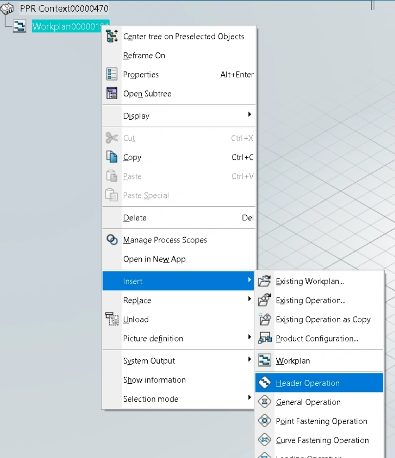

Example 3 : Initializing 'V_SequencingMode' attribute on Header Operation reference by checking the existing value
The below example describes how we can initialize a 'V_SequencingMode' attribute value on a Header Operation reference when it gets instantiated under a workplan object.

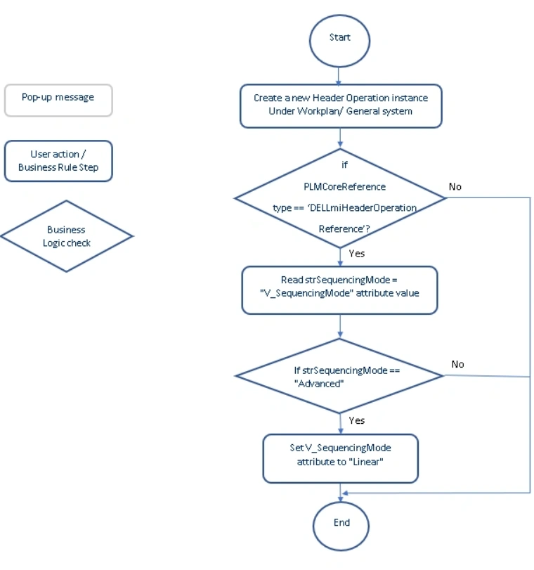

Example 3 Logical Flow
Below is the logical flow for the Example Business Rule (custom code at the bottom)
Example 3 Business Rule
Note: Please copy and paste the custom code at the bottom of this file to your existing 'ENONT_PLMInstance_BLInitialization.CATRule' in the installation folder.
Example 3 Detail Explanation
Here a special API - SetSequencingMode is used to set the "V_SequencingMode" attribute on Header operation reference object.
The commonly used SetAttributeString API does not work here.
Note:
The SetSequencingMode does not work in 'ENONT_PLMReference_BLInitialization.CATRule' because ThisObject works as a proxy object. Hence, we have used it in 'ENONT_PLMInstance_BLInitialization.CATRule' as a work around.
Please note that the same API SetSequencingMode works for setting "V_SequencingMode" attribute on Workplan or other similar objects. Simply you have to add the type of object in the initial check in the BL.
For example: replace the below line from the above EKL code snippet
if (true == plmCoreRef.IsSupporting( "DELLmiHeaderOperationReference"))
with
if (true == plmCoreRef.IsSupporting( "DELLmiWorkPlanSystemReference") OR true == plmCoreRef.IsSupporting( "DELLmiHeaderOperationReference"))

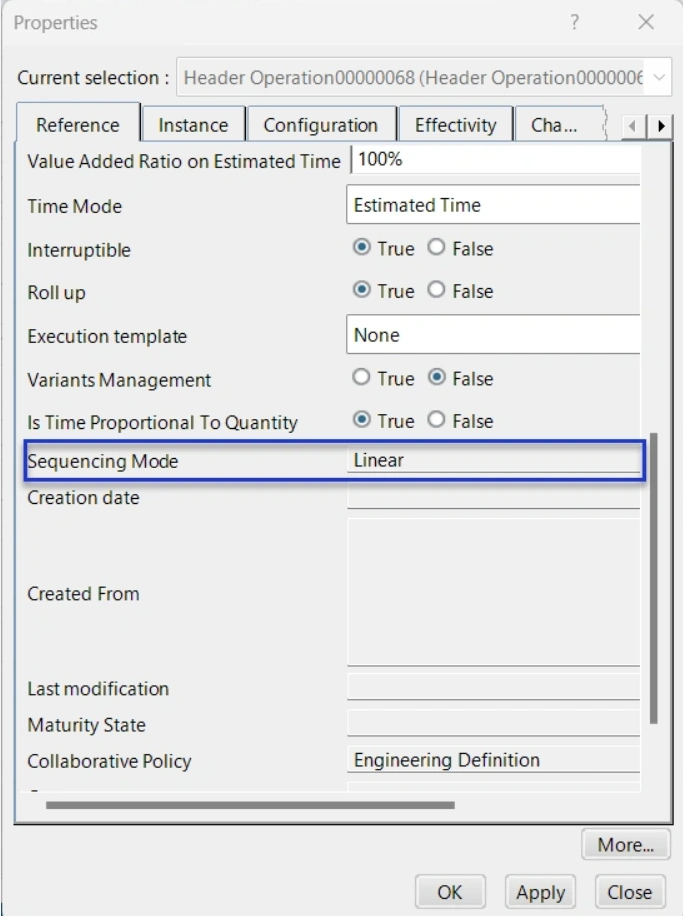

Scenarios:
Scenario | Header Operation - New Creation |
Object creation steps | |
Result |
Comment | A new Header Operation instance is created with Sequencing Mode = 'Linear'. |

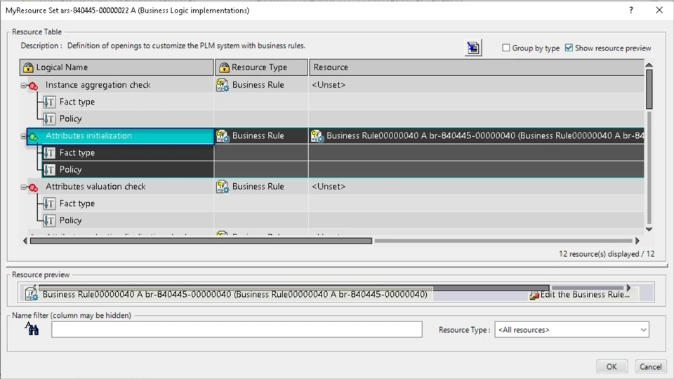

Business Rule Deployment
You may refer the below page for Business Rule deployment.
For deployment using Data Setup app following Resource set ID and opening needs to be used:
Resource Set ID:
Opening:
Fact Type for Example 1 : DELFmiFunctionReference
Fact Type for Example 2 : DELFmiFunctionInstance
Fact Type for Example 3: DELLmiHeaderOperationInstance
