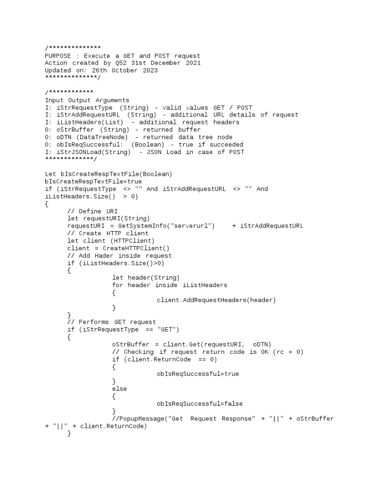

HTTP_Request

How to call web services
Steps followed for calling all web services.
  1. Create HTTP client.
  2. Define header for the HTTP client.
  3. Build web service URI.
  4. Perform GET/POST request.
  5. Retrieve the returned response code if it is zero / as per documentation then ok else error case.
  6. To retrieve the required content from the response traverse through returned data node or buffer.
For example – Below script calls web service to copy model dictionary on Mfg Item.
// Create content for header
let oDTN (DataTreeNode)
let oBuffer(String)
let headers(List)
headers.RemoveAll()
headers.Append("Content-Type: application/json")
headers.Append("Accept: application/json")
headers.Append("SecurityContext: " + "ctx::" + GetSystemInfo("securitycontext"))
// Define URI parameters
let requestURI(String)
requestURI = "/resources/v1/modeler/dsmfg/dsmfg:MfgItem/"
requestURI=requestURI+strPhysicalID
requestURI=requestURI + "/dscfg:Configured?\\\$mask=dsmvcfg:ConfiguredDetails&\\\$fields=dsmvcfg:attribute.enabledCriteria,dsmvcfg:attribute.isConfigured"
// Perform Get request – Below are the input arguments for HTTP request EKL action
/*I: iStrRequestType (String) - Valid values GET / POST
I: iStrAddRequestURL (String) - additional URL details of request
I: iListHeaders(List) - additional request headers
O: oStrBuffer (String) - returned buffer
O: oDTN (DataTreeNode) - returned data tree node
O: bIsReqSuccessful: (Boolean) - true if succeeded
I: iStrJSONLoad(String) - JSON Load in case of POST
Let httpReqAction(AdvisorAction)
Let strJSONLoad, strOBuffer(String)
Let bIsReqSuccessful(Boolean)
strJSONLoad = ""
set httpReqAction = AccessResource("HTTP_Request","AdvisorAction")
httpReqAction.Run("GET", requestURI, headers, strOBuffer, oDTN, bIsReqSuccessful, strJSONLoad)
