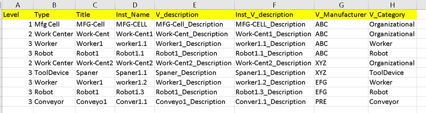

The template excel is used to decide the column names or attributes to be exported. User can add as much as attributes or column names which needs to be exported. The order of columns can be changed as per user’s requirement. The EKL script is able to support any kind of sequence of columns.
Here is an example template:
The template excel is usually contains only column names. But in above example, content is show to make it easier to understand. In case there is data is present in the template excel, then also the script works. Because, from template excel, only 1st row gets read.
Though the sequence does not matter here, for some attributes, column names are as follows:
Column Title Significance
Level
Defines level of object inside structure,
1 – Root
2 – First level child of root or child of level 1.
3 – Second level child of root or child of level 2.
N – Child of level N – 1.
Type Type of object like VPMReference or can be any custom type.
Title V_Name of Object reference
Inst_Name V_Name of object instance
Additional attributes All other attributes (Internal name) can be added to export on Object’s reference and instance.
Note: If instance attributes value needs to be exported then add “Inst_” keyword before attribute name. For example for instance V_description, it will be “Inst_V_description”

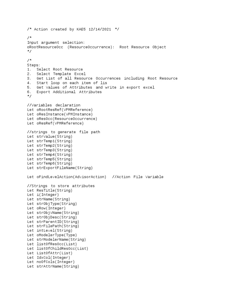

For refColIdx =1 while refColIdx <= oNoOfRefCols
   strRefAttr = oXLSheet.CellAsString(0, refColIdx)
   oExportSheet.SetCell(1, refColIdx,strRefAttr)
Get list which includes root resource and its children’s in same sequence as they appear in tree.
Below lines of code is responsible to get list of all “ResourceOccurrence” including root resource  in a same sequence as they appear in the tree.
//Find all the objects of type "ResourceOccurrence" inside Root Resource Occ
listOfResOcc->AddItem(oRootResourceOcc, 1)
listOfChildResOcc  = oRootResourceOcc->Query("ResourceOccurrence", "") // This list will be the entire list of ResourceOccurrence objects available under Root Resource node
listOfResOcc = listOfResOcc + listOfChildResOcc

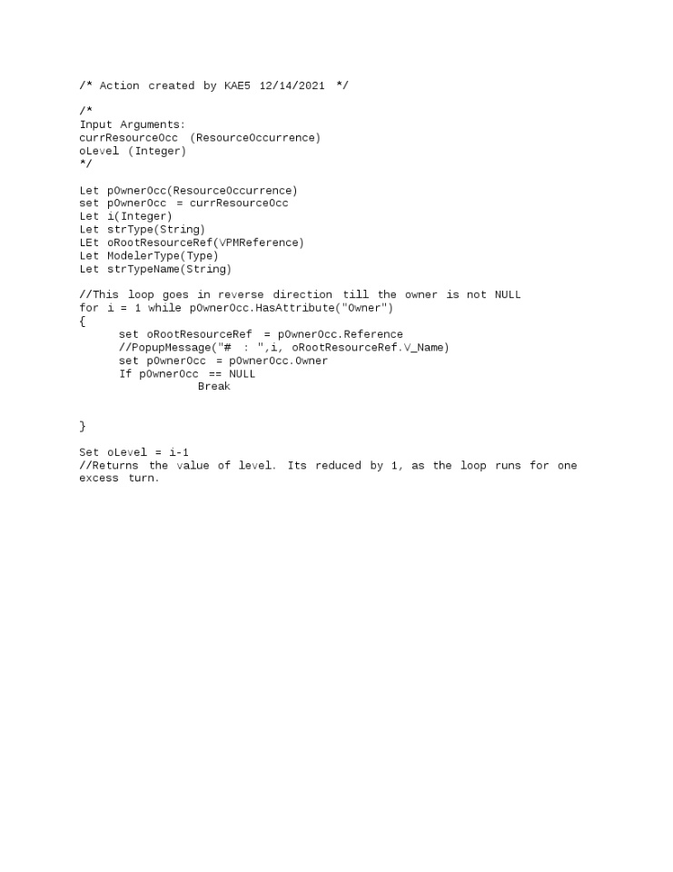

Get level of Current Product from tree:
To get level of resource item in tree, another EKL script is called by passing Resource occurrence and a variable to store Level. The script returns the level of the passed resource as output.
The below lines of code calls the external action file
oFindLevelAction.Run(oResOcc, i)
//A action script which finds the level of occurrence in the tree
intLevel = i  //set Level as i,which is output of running the action file
The Action file called above is attached in this page in Example section.
