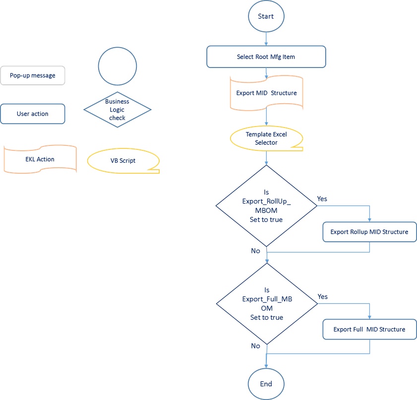

Logical Flow
Below is the logical flow to Export Mfg Item Structure to Excel
Example
Export Mfg. Item Structure to Excel EKL Script
Get Level of Mfg Item EKL Script
VB Script for Template Excel Selector
Template Excel for Mfg Item Export

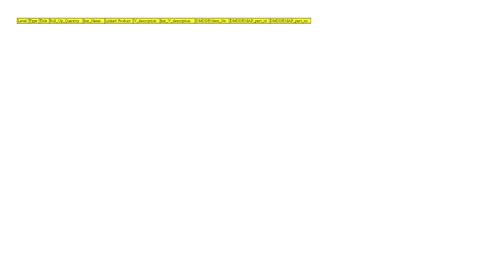

Template Excel format
The template excel is used to decide the column names or attributes to be exported. User can add as much as attributes or column names which needs to be exported. The order of columns can be changed as per user’s requirement. The EKL script is able to support any kind of sequence of columns.
Here is an example template:
The template excel is usually contains only column names. But in above example, content is displayed to make it easier to understand. In case there is data  present in the template excel, then also the script works. Because, from template excel, only 1st row gets read.
Though the sequence does not matter here, for some attributes, column names are as follows:

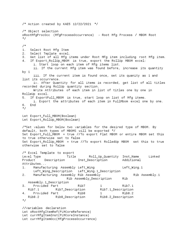

Modify below code for the desired output:
/*Set values for below two variables for the desired type of MBOM. By default, both types of MBOMS will be exported */
Set Export_Full_MBOM = true //To export Flat MBOM or entire MBOM set this to true otherwise set to false
Set Export_RollUp_MBOM = true //To export RolledUp MBOM  set this to true otherwise set to false
For example, if user don’t want to export Full MBOM, "Set Export_Full_MBOM = false"

Get list which includes Root Mfg Item and its children’s in same sequence as they appear in tree.
Below lines of code is responsible to get list of all “MfgProcessOccurrence” including Root MID in a same sequence as they appear in the tree.
// Get all children inside selected mfg item
listOfMfgItemOcc.AddItem(oRootMfgProcOcc, 1)
listOfMfgItemChildOcc = oRootMfgProcOcc->Query("MfgProcessOccurrence", "") // This list will be the entire list of oRootMfgProcOcc objects available under selected Root Mfg Item Node
listOfMfgItemOcc = listOfMfgItemOcc + listOfMfgItemChildOcc

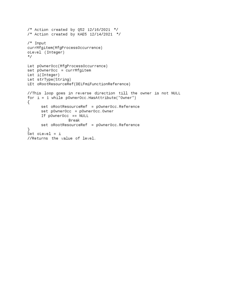

A separate excel file is called to get level of mfg item in list. The action file/EKL Script for getting level is attached above.  The Mfg items occurrence will and a variable to store level will be passed as input and the output will be stored in “lvlMfgItem”
scrGetMfgLvl.Run(currMfgItemOcc, lvlMfgItem) // Get its level and set inside the excel sheet
"lvlMfgItem" will have value of level after execution of action file.

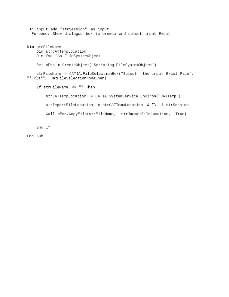

1. Requirement 1: Support CSV file type:
Most of the time external system generates the input file to create structure and commonly used format is Excel / CSV. So to use CSV as input/export file there are few modifications required in the code to export product structure.
  • Modify below string in the VBScript:
In the script, strFileName string specifies the input excel file type. Modify the extension of the file name to .csv
'For .xlsx
strFileName = CATIA.FileSelectionBox("Select the input Excel File", "*.xlsx", CatFileSelectionModeOpen)
'For .csv
strFileName = CATIA.FileSelectionBox("Select the input Excel File", "*.csv", CatFileSelectionModeOpen)
