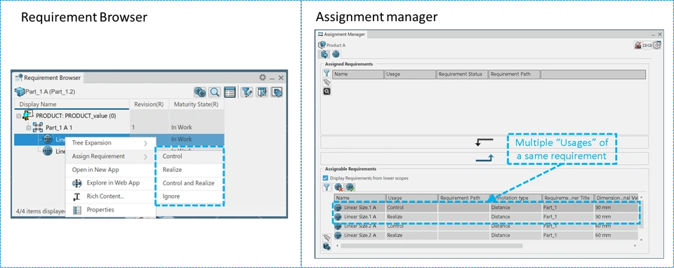

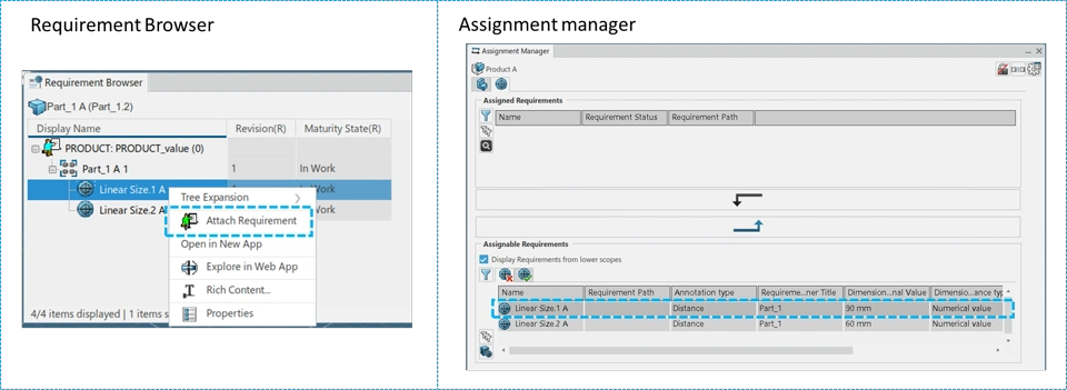

By default (Out of the box) a requirement can be assigned/consumed only once in each object structure (Mfg. Item Structure and Bill of Process Structure) as shown below:
To enable the consumption of a requirement multiple times within a structure, requirement usages can be helpful. Requirement Usage provides various usage types to consume the same requirement multiple times.
By default, the requirement usages are disabled. It is only possible to assign the requirement only once in a structure. No usages are manageable.

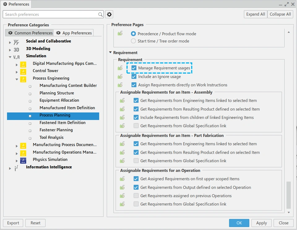

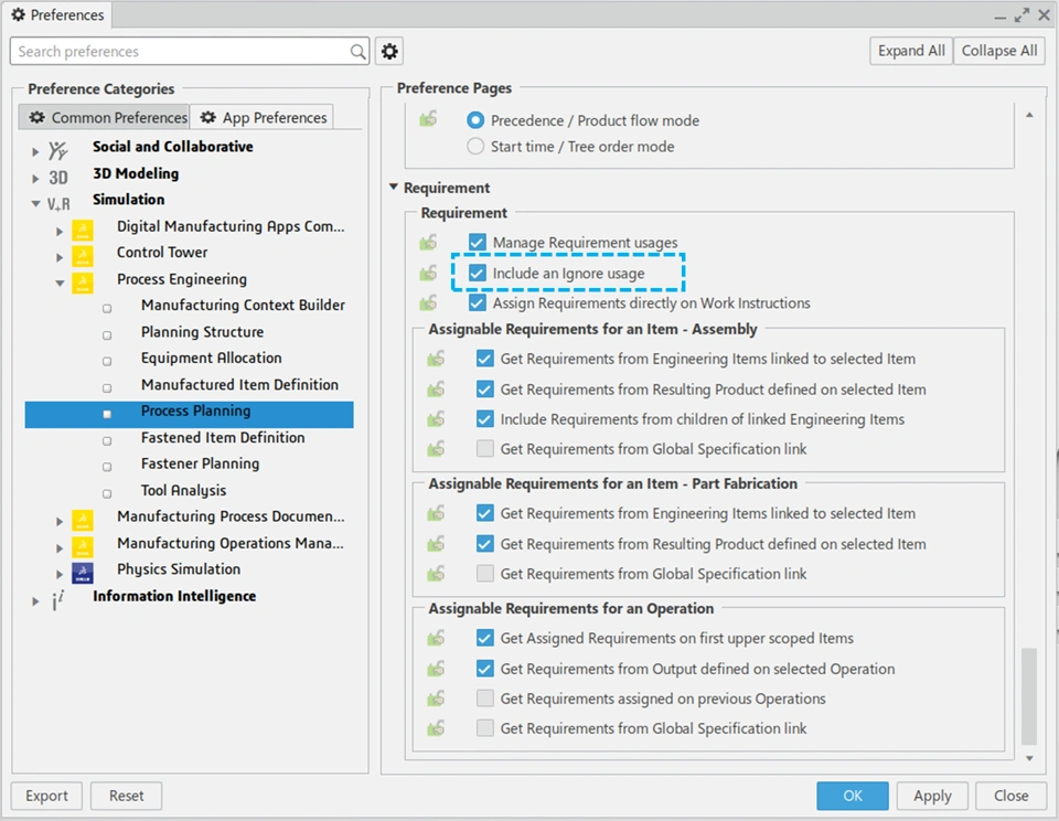

To enable the requirement usages, one need to check the "Manage Requirement usages" checkbox in the preference setting as given below:
 By default, for a requirement, there are two usages available:
  • Realize: This usage of a requirement is consumed on operations/Items, where the desired feature/requirement is realized/produced.
  • Control: This usage of a requirement is consumed on operation/Item, where the desired feature/requirement is controlled/Checked.
Note: By default, based on usage - A “Control” requirement can be assigned on two Mfg. Items in Item structure and two Steps/operations under a workplan/System simultaneously. A “Realize” requirement can be assigned on single Mfg. Items in the Item structure and single Steps/operations under a workplan/System simultaneously. (Applicable for both "Part Fabrication" and "Assembly" scenarios.
  • One additional usage "Ignore" can be enabled by checking the "Include an Ignore usage" checkbox in preferences of requirements.
After enabling the Requirement Usages in preference settings, “Requirement Browser” and “Assignment Manager” shows option to assign the requirement with the Requirement Usages as shown below:
Note: The ‘Ignore’ usage and the combined usage ‘Control and Realize’ is available for assignment only in “Requirement Browser”

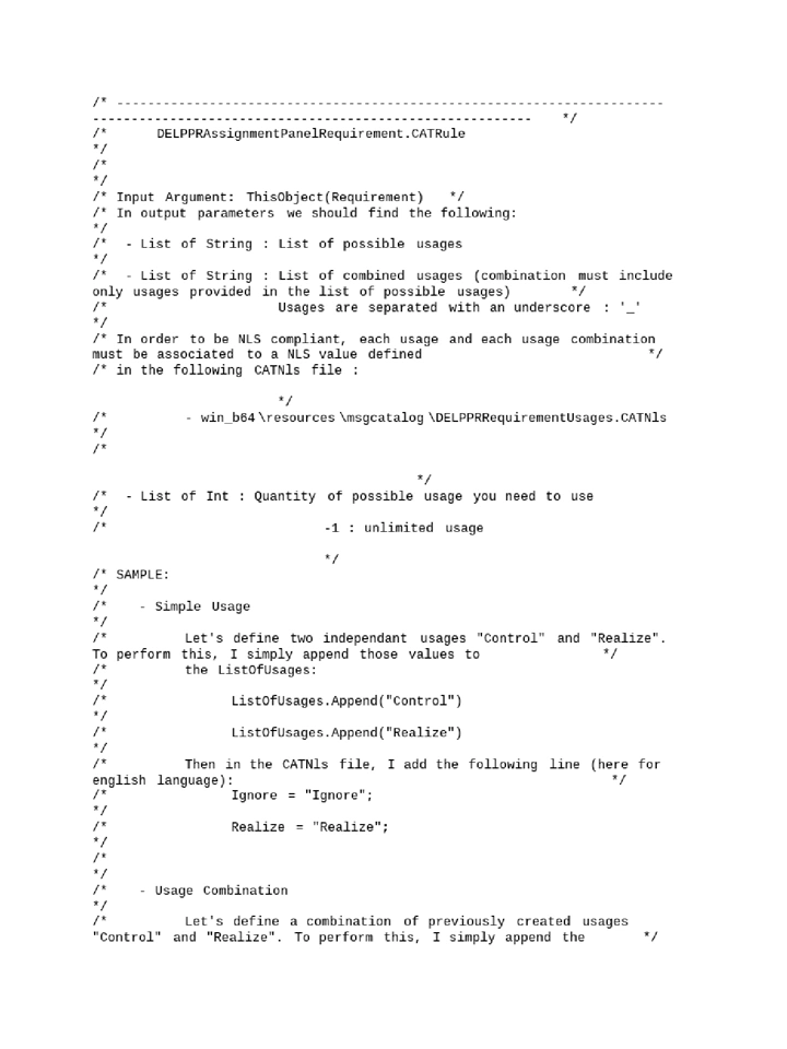

/* ---- Output Lists ---- */
Let ListOfUsages(List) //List for OutputListOfUsages
Let ListOfCombinedUsages(List) //List for OutputListOfCombinedUsages
Let ListOfUsageQty(List) //List for OutputListOfUsageQuantity
To create/add custom usage, in the BL, just after the definition of OOTB Usages, append the custom usage names in the “ListOfUsages” list followed by appending the allowed number of consumptions/assignments for that usage in the “ListOfUsageQty” list as shown below:
//OOTB Usages
ListOfUsages.Append("Control")
ListOfUsageQty.Append(2)
ListOfUsages.Append("Realize")
ListOfUsageQty.Append(1)
ListOfCombinedUsages.Append("Control_Realize")
//Adding custom usages
ListOfUsages.Append("Modify") //Add custom "Modify" usage
ListOfUsageQty.Append(1) //Add custom "Modify" usage consumption/assignment quantity
ListOfUsages.Append("Precaution") //Add custom "Precaution" usage
ListOfUsageQty.Append(-1) //Add custom "Precaution" usage consumption/assignment quantity (-1 to allow infinite assignment)
Also, a combined usage, which allows assignment of multiple usages in a single click can be created by appending the combined usage string in the “ OutputListOfCombinedUsages” list. The string should contain the names of the usages to assign separated with an underscore '_' as shown below:
ListOfCombinedUsages.Append("Control_Modify") //Add custom combined usage for "Control" and "Modify" usage
Note: Do not append the quantity for the combined usages in the list “ListOfUsageQty”. Because, the combined usage is not a separate usage. It only helps to assign multiple usages in a single step.

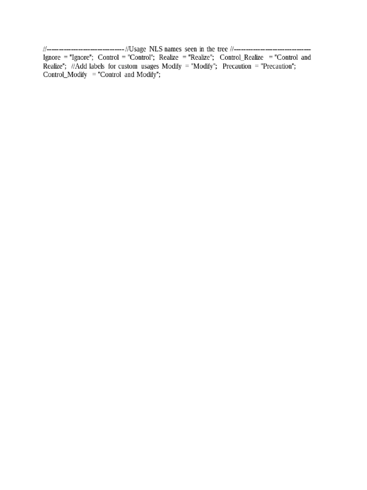

Updating the DELPPRRequirementUsages.CATNls File
After adding the custom usage to the BL, it is necessary to add the labels (Usage NLS Names) for each usage in the DELPPRRequirementUsages.CATNls file. These labels are displayed in the “Requirement Browser” and “Assignment Manager”.
The syntax to add the label for the custom usage is as shown below:
Usage Name as Defined in the BL (Use similar Case as used in BL) = “Label to be displayed” (Add in double quotes);
Notes:
  • “//” is used to define comments in ‘CATNls’ file.
  • The statement defined in the ‘CATNls’ file should end with a semicolon ‘;’.
For example:
//Usage NLS names seen in the tree
Ignore = "Ignore";
Control = "Control";
Realize = "Realize";
Control_Realize = "Control and Realize";
//---Add labels for custom usages---
Modify = "Modify";
Precaution = "Precaution";
Control_Modify = "Control and Modify";

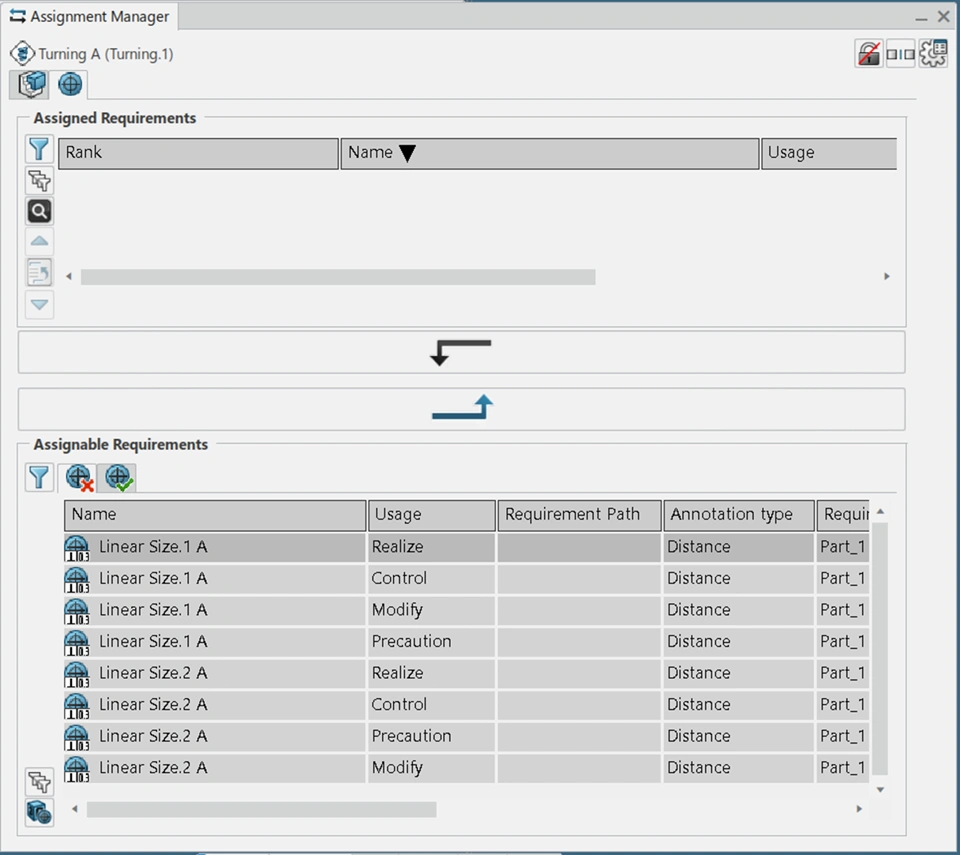

The above sample script will add additional usages “Modify” and “Precaution” in the “Requirement Browser” and the “Assignment Manager”. Also, a combined usage “Control and Modify” is added to the list of requirement usages. The number of allowed consumptions for the “Modify” usage will be set to 1 and for the “Precaution” usage to ‘-1’ which allows infinite number of assignments of the usage.

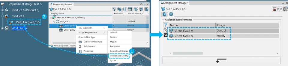

After deploying the above sample Business Logic (BL), the “Requirement Browser” and “Assignment Manager” will show the custom “Modify”, “Precaution” and “Control and Modify” usage.
After assigning the “Modify” usage, it looks as shown below in the assignment manager:
After assigning the “Control and Modify” usage from “Requirement Browser”, the “Modify” and “Control” usages are assigned to the object. It looks as shown below in the assignment manager:

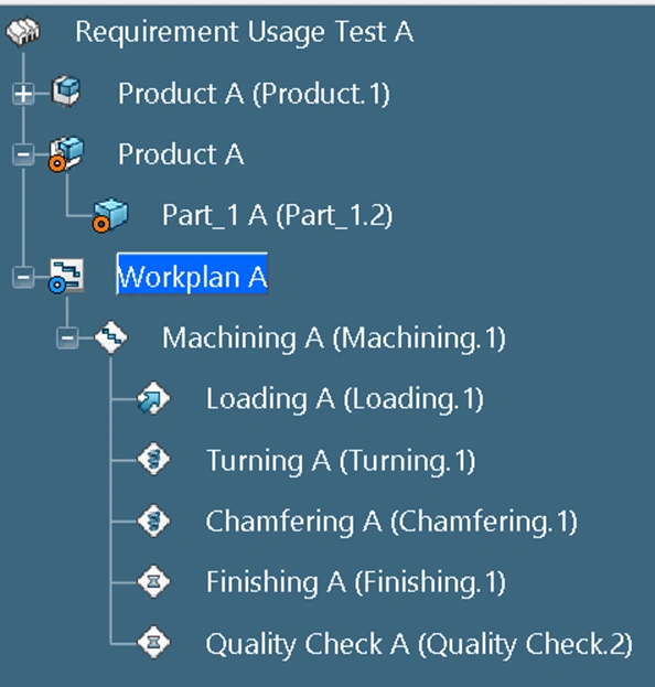

Let's consider a Process Planning Structure as shown below which has five operations in it:
When, no requirement is consumed on any operation, the assignment manager will show all the usages of the requirements available for the assignment as shown below:

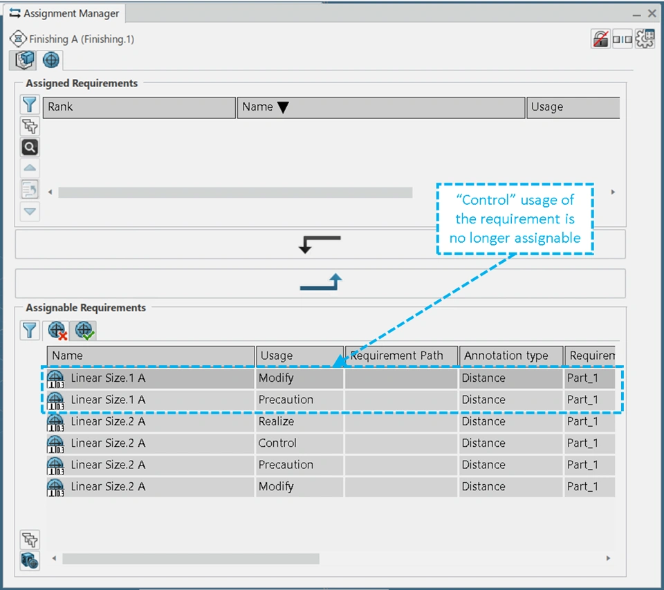

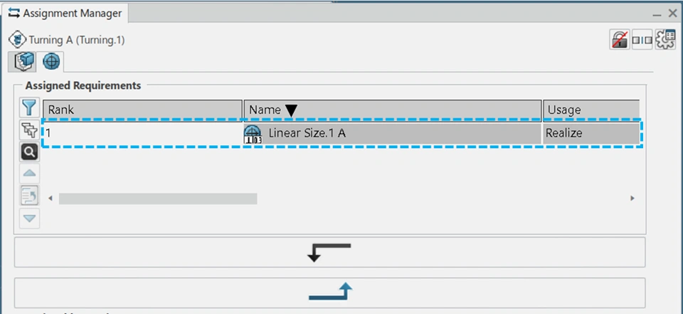

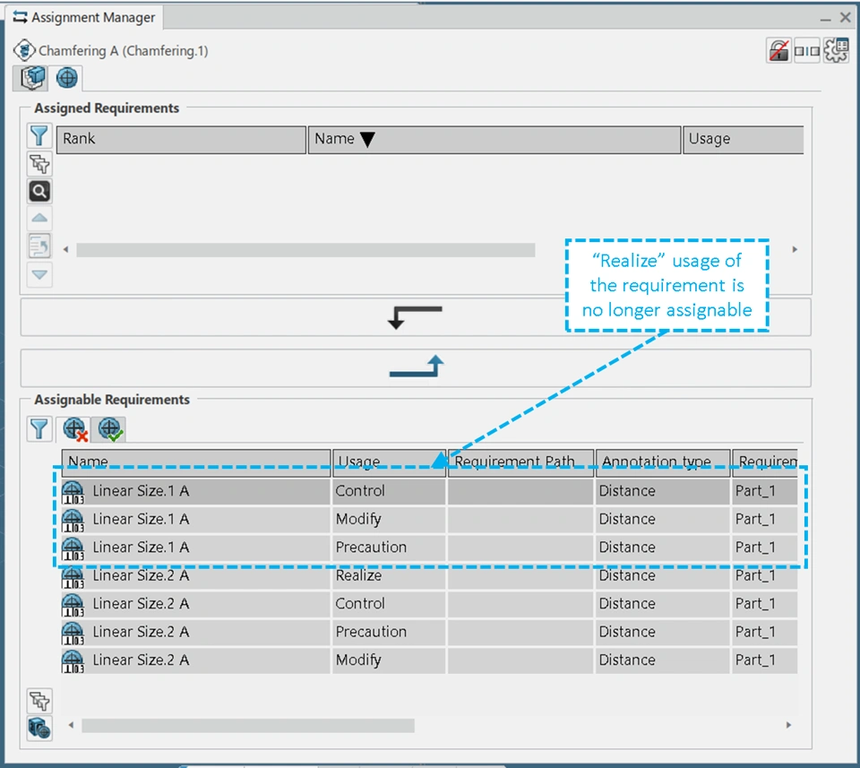

Let’s assign the “Realize” usage (OOTB usage with allowed number of assignments in a structure = 1) of the “Linear Size.1 A” requirement to the “Turning” operation as shown below:
After assigning the “Realize” of the usage of the “Linear Size.1 A” requirement on one operation in process structure, the “Realize” usage of that requirement will no longer assignable for other operations (Because the number of allowed assignments for “Realize” usage = 1) as shown below:
In similar way, the “Modify” usage will be assignable only on 1 object in a structure.
Let’s assign the control usage of the “Linear Size.1 A” requirement on the “Turning” and “Chamfering” operation (This will be allowed as number of allowed assignments for “Control” usage = 2) as shown below:
Now the “Control” usage of the requirement “Linear Size.1 A” will be no longer available for additional assignments as shown below:

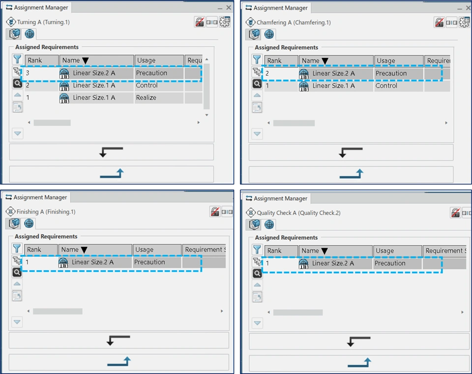

The “Precaution” usage of a requirement can be assigned on any number of objects in a structure, because it’s allowed number of assignments are set to “-1” which allows infinite number of assignments.
Now, let’s assume that, for the requirement “Linear Size.2 A” it is required that the precaution should be taken that this length is not changed by any of the machining operation.
Let’s assign the precaution usage of the requirement “Linear Size.2 A” to all the machining operations and to the “Quality Check” Operation” as shown below:
In this way, the number of allowed assignments can be customized for the OOTB Requirement usages and additional usages, and combined usages can be added as per the need.

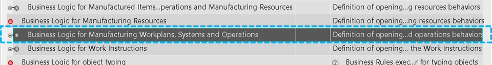

A. Deploy the Business Rule
You may refer the below page for Business Rule deployment.
How to Deploy Business Rule
