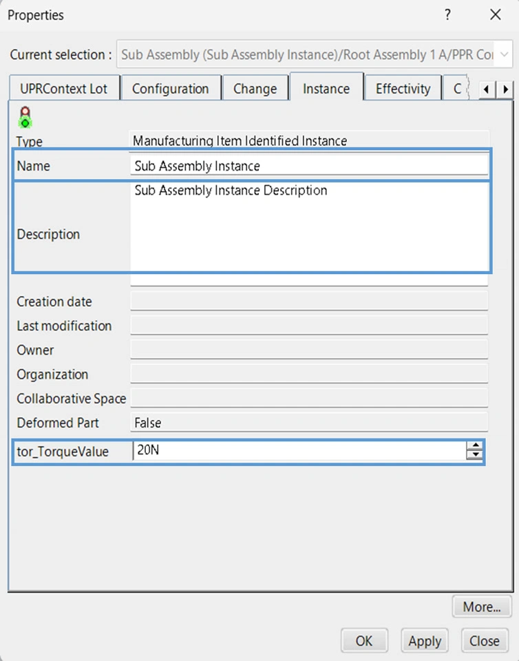

When an Mfg. Item is moved within the tree structure the reference of the Mfg. Item is not altered but the instance of that Mfg. Item changes. In OOTB behavior the new instance which is created gets the same instance name, description and other OOTB attributes copied from the original instance information. But if you have any custom attribute value set in the original instance, that value doesn't get copied in the newly created instance. To achieve that we can use the Business Logic (BL) in the below provided example.
| Input | Results |

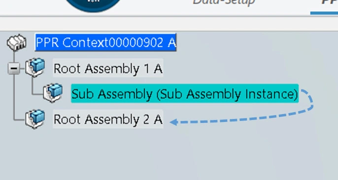

| Scenario | Drag and drop Sub Assembly from Root Assembly 1A to Root Assembly 2A |
Only the OOTB attributes like Name and Description are copied, but custom attributes are reset |
Example: Initialize custom instance attribute values when changing the position of Mfg. Item in the tree

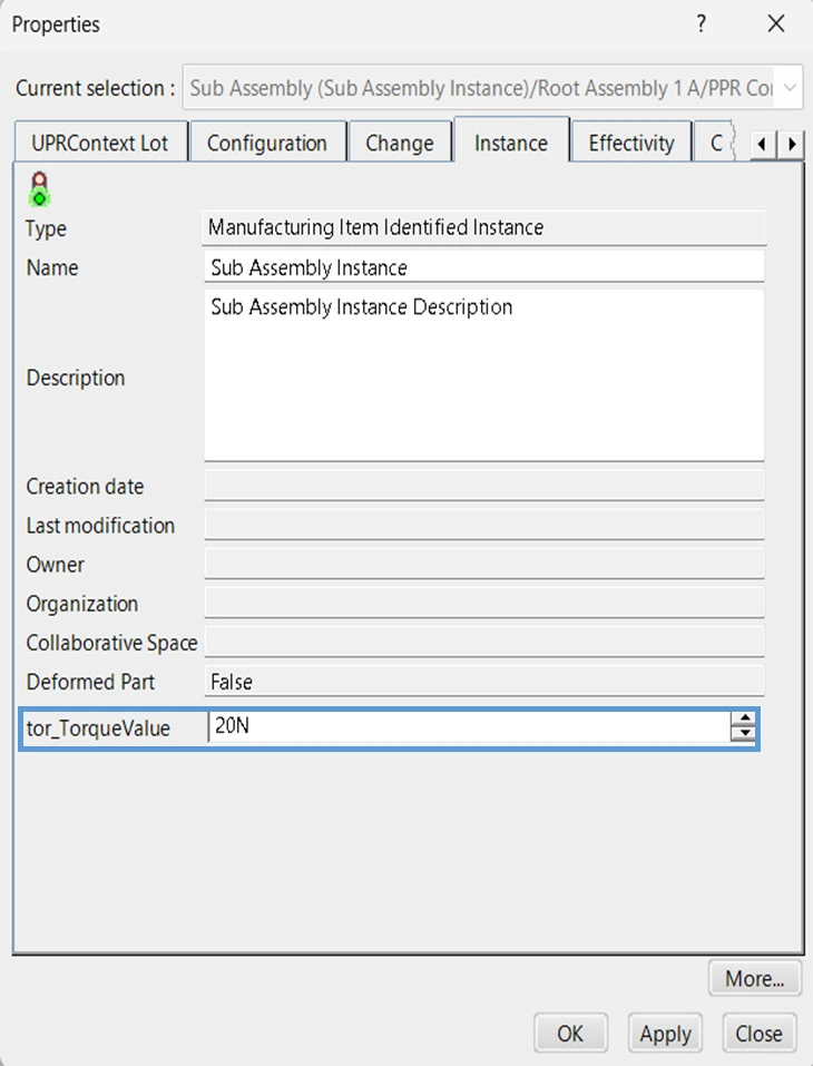

In this example we are using a custom attribute "tor_TorqueValue" which is present in the instance information of an Mfg. Item.
When an Mfg. Item is relocated in the tree using this BL we can copy the value of this custom attribute "tor_TorqueValue" from the old instance to the newly created instance of that item.

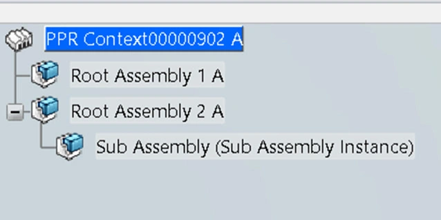

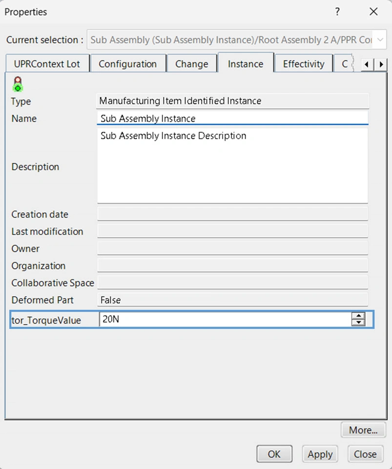

| Input | Results |
The custom attribute tor_Torque Value gets copied onto the new instance
