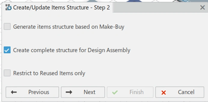

After clicking on the "Next" button, it gives three options:
  1. "Generate item structure based on "Make-Buy"
  2. "Create complete structure for Design Assembly"
  3. "Restrict to Reused Items Only"

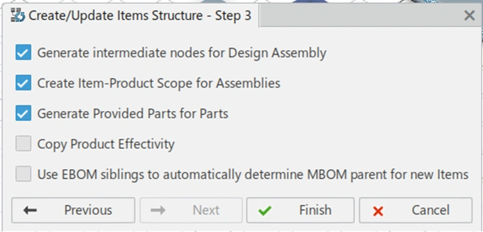

After clicking on the "Next" button, its askes to select preferences to create the Mfg. Item nodes and few additional options.
After clicking on the "Finish" button, it will generate the Mfg. Item Structure based on the selected options.

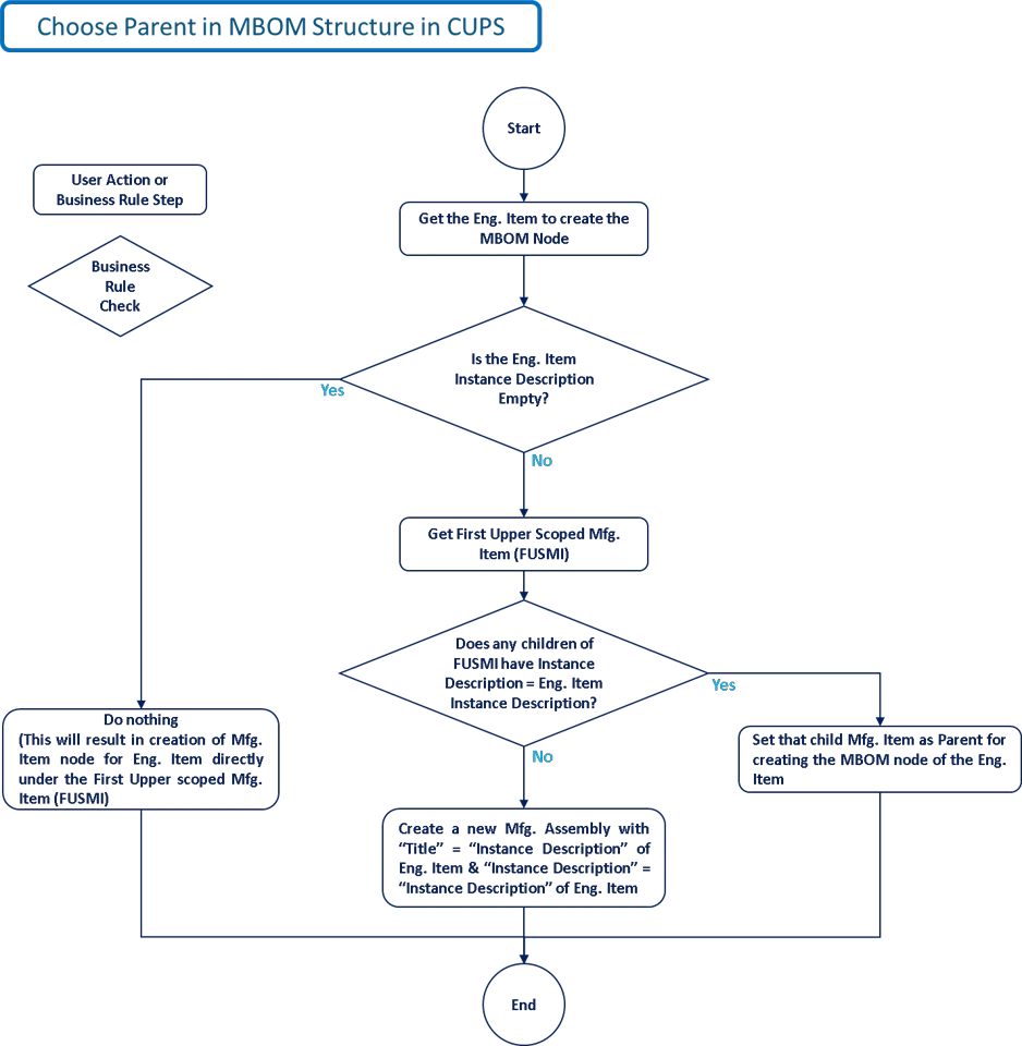

The opening ID "DELMA_ChooseParentInCUPS_ID" can be used to customize the logic to select the parent Mfg. Items for the Mfg. Item nodes that are getting created for their respective Eng. Item nodes after the execution of CUIS command.
In the provided sample script, a logic is written to select the parent Mfg. Item for the MBOM Node to be created based on the "Description (V_description)" attribute of the Eng. Item Instance for which the node is being created.
  • If a Mfg. Item with the same instance description as of a Eng. Item instance is available under the first upper scoped Mfg. Item, that Mfg. Item will be used as the parent to insert the Mfg. Item node for the current Eng. Item.
  • If no Mfg. Item with the matching instance description is available, a new Manufacturing Assembly node is created to act as a parent under the first upper scoped Mfg. Item with "Title" and instance description same as the "V_description" of the current Eng. Item Instance and the node for the current Eng. Item is created under that parent node.
  • If the "Description (V_description)" of the Eng. Item is empty, the Mfg. Item node for the Eng. Item is created directly under the first upper scoped Mfg. Item.
Logical Flow

Here the "Create/Update Item Structure" command is executed for the "Root Product 14052025" Mfg. Assembly. The options are selected as shown below:
