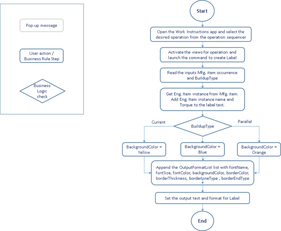

Logical Flow
Business Rule

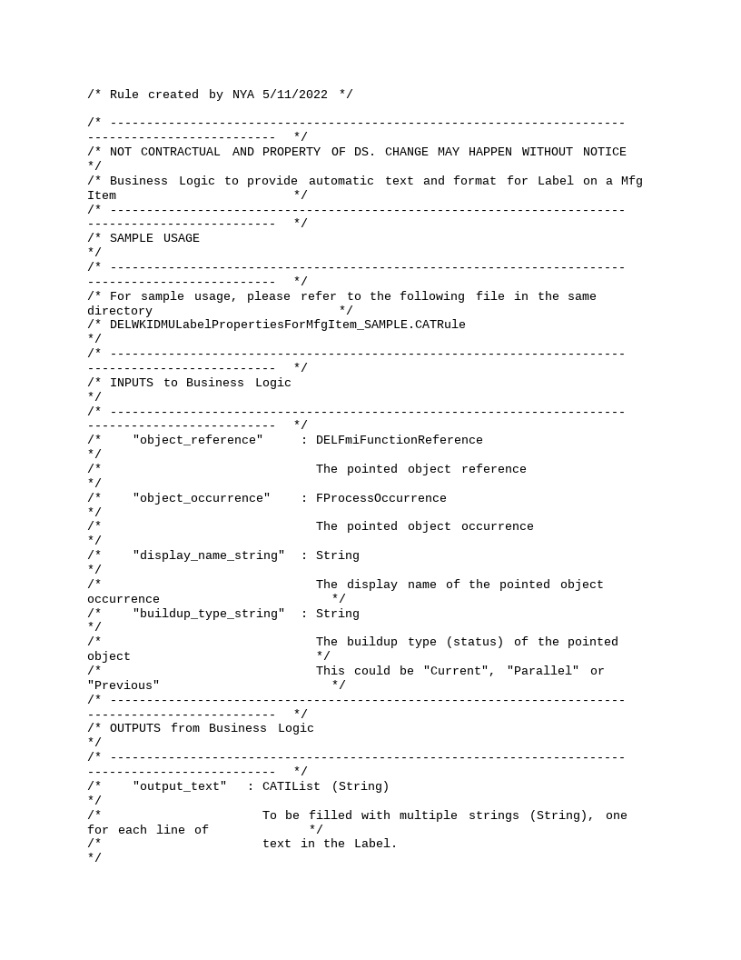

The above sample business logic has been derived from the out-of-the-box (OOTB) business logic "DELWKIDMULabelPropertiesForMfgItem.CATRule", with additional customizations incorporated to meet specific requirements.
The following out-of-the-box (OOTB) working business logics (BLs) are available in the directory:
Your_3DEXPERIENCE Installation\\win_b64\\resources\\knowledge\\scripts, corresponding to the opening ID "DELWKIDMULabelProperties_BL_ID":
DELWKIDMULabelPropertiesForResource
DELWKIDMULabelPropertiesForFasten
DELWKIDMULabelPropertiesForDetailedFasten
DELWKIDMULabelPropertiesForDrill
DELWKIDMULabelPropertiesForContinuousProvide
DELWKIDMULabelPropertiesForOperation

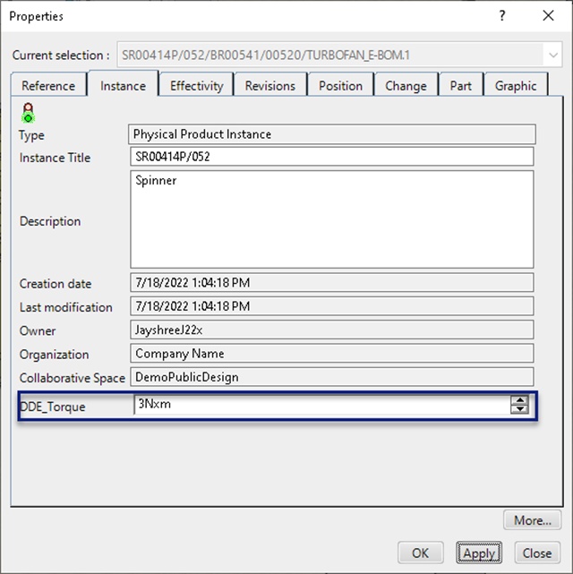

Now, we need to get the Eng. item instance to get the Torque attribute value associated with it.
Logic to get Eng. Item instance from Eng. Item occurrence
oVPMInstance = oProdOcc.Instance
We can get the required Eng. item instance from the occurrence using above method.

// the "DDE_Torque" attribute on the Eng Item Instance
strInstanceTorque = oDDEVPMInstance.DDE_Torque
OutputTextList.Append( "Torque: " + strInstanceTorque ) //Add torque to label text

Logic to set the background color according to the buildup type
if (BuildupType == "Current")
BackgroundColor = "255, 255, 0" //yellow color
else if (BuildupType == "Parallel")
BackgroundColor = "255, 165, 0" //orange color
else /* Previous */
BackgroundColor = "0, 128, 255" //light blue color
}We have changed the background color according to the buildup type. Like it's yellow for buildup type "Current".
In similar way we can set the required background color by changing the RGB values (like "255, 255, 0" for yellow and "255, 255, 255" for white)

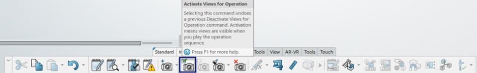

Run Activate Views for Operation command to activate the view for ‘LoadSpin’ operation.
Once the view is activated the Label gets enabled.

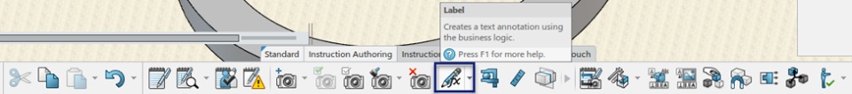

To create a new label click on Label from the Instructions Authoring section of the action bar.
Select the spinner.
A new label gets created which contains Title and Torque value of the Eng. Item instance linked with the LoadSpin operation.

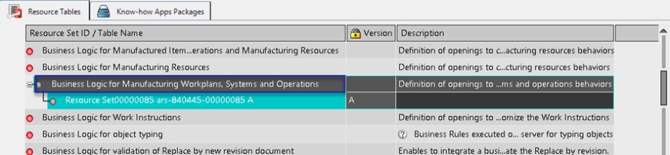

For deployment using Data Setup app following Resource set and Opening needs to be used
Resource Set:
Note: Please note that the Resource set ID for this Business Rule opening is ‘Business Logic for Manufacturing Workplans, Systems and Operations (and not ‘Business Logic for Work Instructions’).
Opening:
