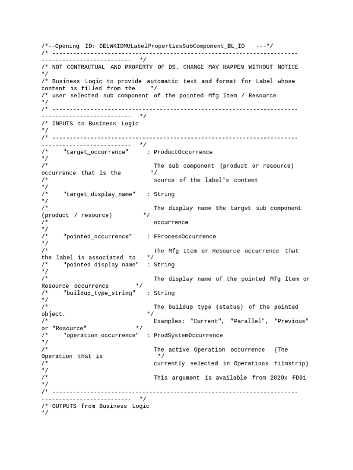

| Usage | Using this BL, we can set the text and text format of the Label created in the Work Instruction View for the Sub-Component of the assigned Mfg. Item to the Operation.
This BL is invoked when you author Labels on a Sub-Component of either a Manufacturing Item or a Resource or an Operation-Output using Label
| CATRuleExit | DELWKIDMULabelPropertiesSubComponent.CATRuleExit |
| Sample CATRule | DELWKIDMULabelPropertiesSubComponent.CATRule |

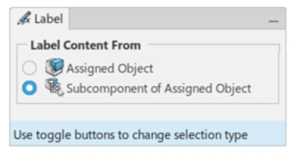

In DELMIA's Work Instructions Application, when creating a "Label" using the "Label" command, one can choose to create a label for the "Assigned Object" or the "Subcomponent of Assigned Object".
The Business Logic to customize the Label for "Assigned Object" is already discussed here: Link
When the option to create Label for "Subcomponent of Assigned Object" is selected and the subcomponent is selected from the 3D View, it shows that subcomponent in the "Subcomponent Selection" section.
When the subcomponent is selected in the "Subcomponent Selection" section, out of the box (OOTB), a label is created showing the Occurrence Name of the Subcomponent (Physical Product).

Sample Script
Note: To understand how the script works, please read the comments in the code, which explain each line.
The above sample business logic has been derived from the out-of-the-box (OOTB) business logic "DELWKIDMULabelPropertiesSubComponent.CATRule", with additional customizations incorporated to meet specific requirements.
The out-of-the-box (OOTB) working business logic (BL) is available in the directory:
Your_3DEXPERIENCE Installation\\win_b64\\resources\\knowledge\\scripts\\DELWKIDMULabelPropertiesSubComponent.CATRule

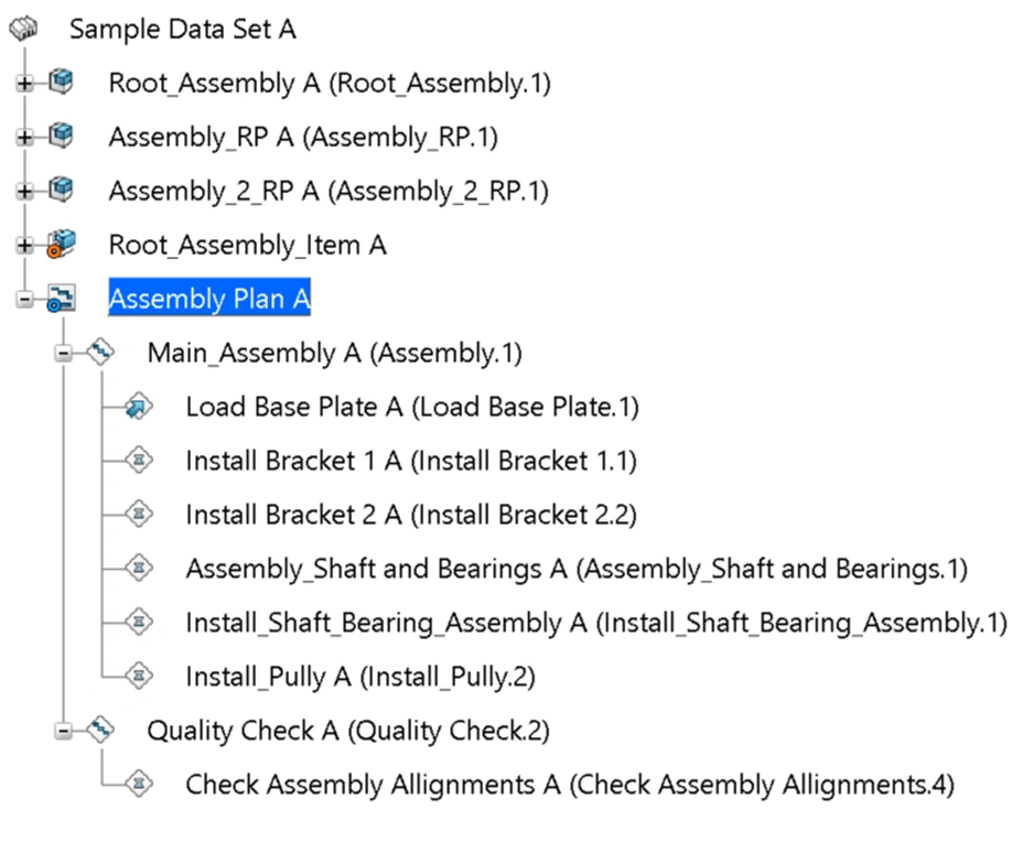

To demonstrate the use case, the following data set is used.

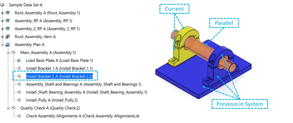

The operation "Install Bracket 2" has three types of components visible in its 3D View:
- Current
- Parallel
- Previous in System
Here, label will be created for all these three types of operations using the customized BL.

Here, let's create a label using the customized business logic for the operation "Install Bracket 2 A".
- Open the data set in "Work Instructions" application.
Activate the "Install Backet 2 A" operation and select the "Activate Views for Operation" command.
The "View.1" will get activated.
Note: If view is not available, please create it using the "Create View for Operation" command.Launch the "Label" command from the "Instruction Authoring" section.
In the "Label" window, select "Subcomponent of Assigned Object".
Select the "Bracket_Cap" shown in yellow color. and in the "Subcomponent Selection" section of the "Label" window, select "Bracket_Cap A (Bracket_Cap.1)"
A Label will be created for the "Bracket_Cap A (Bracket_Cap.1)" showing the Reference Description, Instance Description and Part Number (Custom Attribute). Adjust the position of the label as required.
