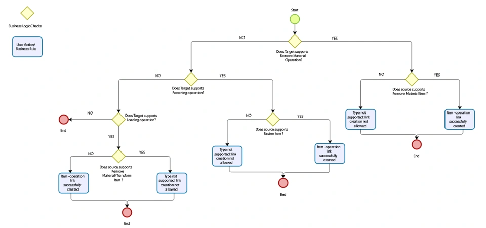

Logical Flow:

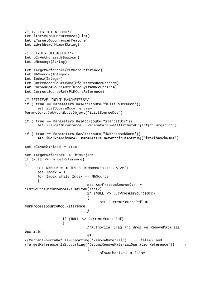

Business Rule Sample:
Detail Explanation:
  • Inputs:
    • iLstSourceOccurrences: A list of source occurrences that are being dragged.
    • iTargetOccurrence: The target occurrence where the drag and drop action is being attempted.
    • iWorkbenchName: The name of the workbench [This is not used directly in the example but can be used to restrict drag and drop in particular application]
  • Outputs:
    • oIsAuthorized: A Boolean that determines whether the drag and drop action is allowed.
    • oMessage: A message providing information if the action is not authorized.
      If any rule for drag and drop is violated, oIsAuthorized is set to false and a corresponding message is set for the user.

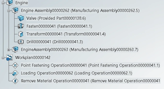

Sample MBOM and Workplan DataSet:
Note: Remove Material Item type consist of Pre-Drill, Drill, No-Drill, Cut, Bevel, Grind Item Type.
Scenario1:
Drag Drill Item Type to RemoveMaterial Operation
  • Result: Assignment will be successful.
Drag Fasten Item to RemoveMaterial Operation
  • Result: Error message and assignment will fail. It triggers the error message:
In the Relations tab, you can see only Drill Item assigned to Remove Material Operation
Logic to authorize Drag and Drop of Remove Material Item Type to Remove Material Operation:
if ((CurrentSourceRef.IsSupporting("RemoveMaterial") == false) and (TargetReference.IsSupporting("DELLmiRemoveMaterialOperationReference")) )
            oIsAuthorized = false
            oMessage="Type not supported for Drag and Drop on Remove Material operation"
            break

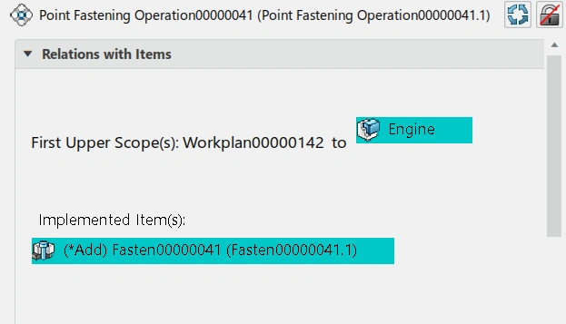

Scenario2:
Drag Fasten Item to Point Fastening Operation
  • Result: Assignment will be successful.  The script allows "Fasten" items to be assigned to Point Fastening operation.
Drag “Valve” Provide Item type to Point Fastening Operation
  • Result: Error message and assignment will fail. An error message will be triggered
In the Relations tab, you can see only Fasten Item assigned to  Operation
Logic to authorize Drag and Drop of Fasten Item Type to Fastening Operation:
if ((CurrentSourceRef.IsSupporting("Fasten") == false) and (TargetReference.IsSupporting("DELLmiCurveOperationReference")  OR TargetReference.IsSupporting("DELLmiPunctualOperationReference") ) )
          oMessage="Type not supported for Drag and Drop on Fastening operation"
          break
Scenario3:
Drag Transform Item to Loading Operation
  • Result: Error message and assignment will fail. Since the item is of type "Transform," the drop will fail, and the error message will be:
Drag Provide Item to Loading Operation
In the Relations tab, you can see only Provide Item assigned to Operation
Logic to restrict Drag and Drop of Transform/Remove Material Item Type to Loading Operation:
if ((CurrentSourceRef.IsSupporting("RemoveMaterial") OR CurrentSourceRef.IsSupporting("Transform")) and (TargetReference.IsSupporting("DELLmiLoadingOperationReference")))
                   oMessage="Type not supported for Drag and Drop on Loading operation "
                   break

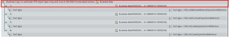

Other Supported DELMIA Types
When we associate this BL with type ‘DELLmiLoadingOperationReference’ the BL gets invoked on Loading Operation.
The same Business Logic can be applied to other DELMIA types
Similarly, one can use below type in script for customization
  • ‘DELFmiFunctionReference’ for Mfg Items types and their subtypes
  • ‘DELLmiGeneralSystemReference’ for General system
  • ‘DELWkiInstructionReference’ for Work Instruction
  • ‘VPMReference’ for different Resource types and Engineering items (Products/ parts)
In the example, we have used
FactTypeTo Invoke On
DELLmiLoadingOperationReferenceLoading operation
DELLmiCurveOperationReferenceCurve Fastening operation
DELLmiPunctualOperationReferencePoint Fastening operation
DELLmiRemoveMaterialOperationReferenceRemove Material operation
