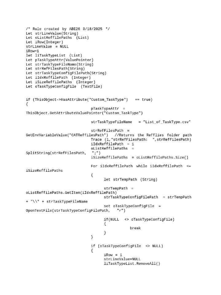

Example 1: Set Authorized Attribute Value
Disclaimer: Please be aware that reading the CSV file with each BL trigger may impact performance, particularly with large files.

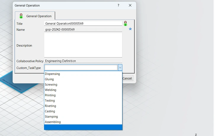

In some cases, the values for a specific attribute may not be fixed and could change or increase over time. To accommodate such changes and make the process more flexible, it's ideal to read these values from an external CSV file and populate the dropdown list dynamically.
The below example reads CSV file which has various Task Types needed for an operation and this BL will loads them on the attribute “Custom_TaskType” in dropdown when user opens the Properties page of General operation Type.
| No | Use Case |
| 1 | Read CSV and set authorized value for Custom_TaskType |
CSV file path: “
The values for the Custom_TaskType attribute are stored in the input CSV file located in the reffiles folder within the installation directory. The first column of the CSV file contains the list of Task Type values for Operations.
Please refer below image for input csv file.
Template CSV Format:
- The Custom_TaskType attribute can be accessed/edited in following ways
- Create page of General operation object
- EDIT Property page
Property page at search
BL will be triggered for all above cases
Note: You can use this BL for existing attributes. However, if a mask is defined, the selection will be limited to the values specified within the mask. It will not be possible to add any values outside of what the mask allows

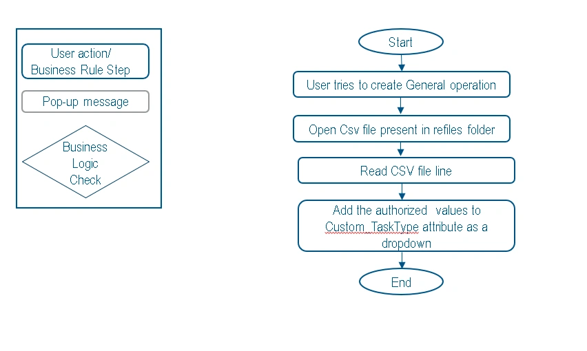

Logical Flow
Business Rule Sample
Detail Explanation
When the user creates a General operation in the Process Planning app, the properties page for the General operation opens, and a Business Logic (BL) script is triggered.
This BL will populate the dropdown for the Custom_TaskType attribute with authorized values from a CSV file.
Note: The authorized values in the CSV can be updated in the future. If new task types like "Painting" need to be added, the user will modify the CSV, and the dropdown will be updated to reflect these changes
Logic to open csv file
For iIdxReffilePath while iIdxReffilePath <= iSizeReffilePaths
let strTempPath (String)
strTempPath = oListReffilePaths.GetItem(iIdxReffilePath)
strTaskTypeConfigFilePath = strTempPath + "\\\\" + strTaskTypeFileName
set oTaskTypeConfigFile = OpenTextFile(strTaskTypeConfigFilePath, "r")
if(NULL <> oTaskTypeConfigFile)
break
}Logic to read csv file:
strLineValue = oTaskTypeConfigFile->Read()Logic to set Authorized values:
if (oTaskTypeConfigFile <> NULL)
iRow = 1
strLineValue=NULL
liTaskTypeList.RemoveAll()
for iRow while strLineValue <> ""
Trace (1,"strLineValue: ",strLineValue)
if(strLineValue<>"")
liTaskTypeList-> Append(strLineValue)
iRow = iRow + 1
pTaskTypeAttr.AuthorizedValues=liTaskTypeListOther Supported DELMIA Types

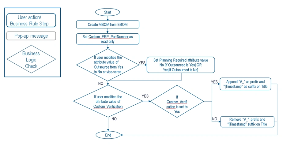

Logical Flow
Detail Explanation
Input parameter "EditAttributeId" identifies the attribute that has been modified and whose edition requires propagation.
Input parameter "Propagation Mode" specifies if the propagation must be performed on
- on attribute value ["PropagationMode" value will be "Valuation"] or
- on attribute visibility only ["PropagationMode" value will be "Edition"].

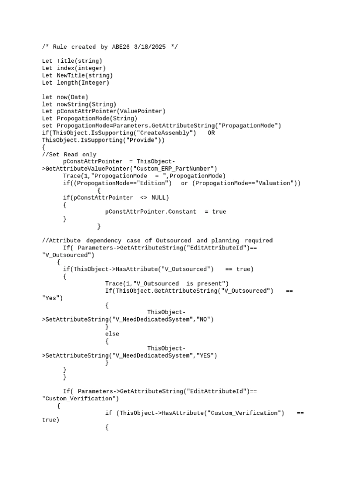

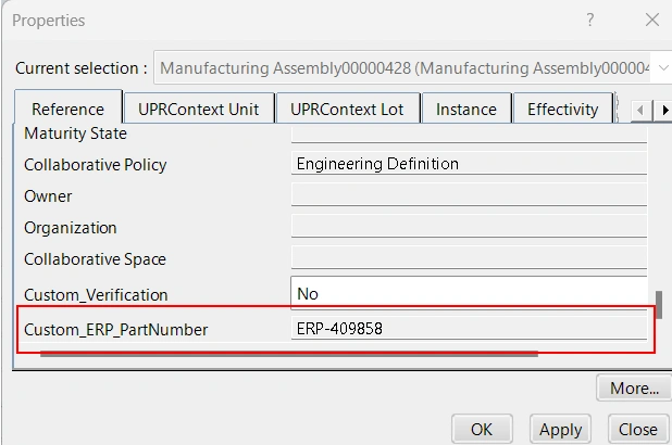

Scenario1: Setting Custom_ERP_PartNumber as Read-only
- The user creates an MBOM (Manufacturing Bill of Materials) from an EBOM (Engineering Bill of Materials).
- Once the MBOM is created, the user opens the Properties Page of one of the assemblies within the MBOM. At this point, the Business Logic (BL) is triggered automatically.
The
Custom_ERP_PartNumberattribute, which was copied over from the EBOM, will be set as read-only in the MBOM. This prevents the user from modifying theCustom_ERP_PartNumberat the MBOM level, ensuring that the part number remains consistent with the original EBOM.
Logic:
Let pConstAttrPointer(ValuePointer)
pConstAttrPointer = ThisObject->GetAttributeValuePointer("Custom_ERP_PartNumber")
if(pConstAttrPointer <> NULL)
pConstAttrPointer.Constant = true

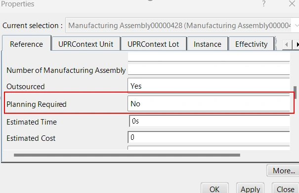

}Scenario 2: Modifying "Outsourced" Attribute
The user modifies the Outsourced attribute from No to Yes. The Business Logic (BL) is triggered automatically when the attribute Outsourced is updated. When the Outsourced attribute is set to Yes, the Planning Required attribute will be automatically updated and set to No by the BL.
Logic:
//Attribute dependency case of Outsourced and planning required
If( Parameters->GetAttributeString("EditAttributeId")== "V_Outsourced")
if(ThisObject->HasAttribute("V_Outsourced") == true)
Trace(1,"V_Outsourced is present")
If(ThisObject.GetAttributeString("V_Outsourced") == "Yes")
ThisObject->SetAttributeString("V_NeedDedicatedSystem","NO")
else
ThisObject->SetAttributeString("V_NeedDedicatedSystem","YES")

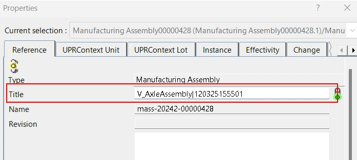

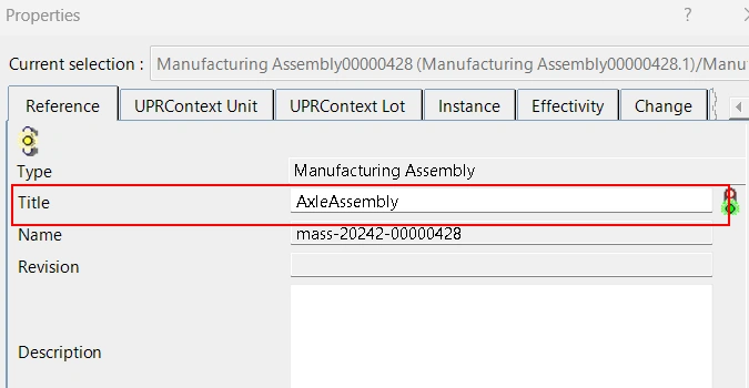

}Scenario 3: Modifying "Custom_Verification" Attribute to Yes
The user changes the Custom_Verification attribute value to Yes. The Business Logic (BL) is triggered automatically when the Custom_Verification attribute is updated to Yes. The Title attribute will be modified by appending the prefix "V_" and adding the current timestamp as the suffix.
Logic:
If( Parameters->GetAttributeString("EditAttributeId")== "Custom_Verification")
if (ThisObject->HasAttribute("Custom_Verification") == true)
set now = BuildDate()
set nowString = DateFormat("%d%m%y%H%M%S", now)
If(ThisObject.GetAttributeString("Custom_Verification") == "Yes")
Trace(1,"Custom_Verification is Yes")
set Title = ThisObject.V_Name
set index = Title.Search("V_")
if(index <> 0)
set NewTitle="V_"+Title
set index = NewTitle.Search("|")
if(index < 0)
NewTitle = NewTitle + "|"+nowString
Trace (1,"NewTitle=========> ",NewTitle)
ThisObject.SetAttributeString("V_Name",NewTitle)
}Scenario 4: Modifying "Custom_Verification" Attribute to No
The user changes the Custom_Verification attribute value to No. The Business Logic (BL) is triggered automatically when the Custom_Verification attribute is updated to No. The Title attribute will be modified again by removing the "V_" prefix and the timestamp suffix if they exist.
Logic:
If(ThisObject.GetAttributeString("Custom_Verification") == "No")
if(index ==0)
set length = Title.Length()
set NewTitle = Title.Extract(2,length-2)
ThisObject->SetAttributeString("V_Name",NewTitle)
if(index >= 0)
set NewTitle = NewTitle.Extract(0,index)

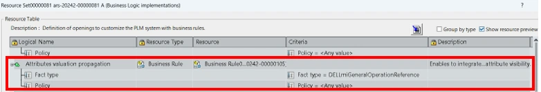

Business Rule Deployment
The below page can be referred for Business Rule deployment.
For deployment using Data Setup app following Resource set ID and opening needs to be used:
Resource Set ID:
Opening:
Fact Type for Example 2: 'DELFmiFunctionReference’
