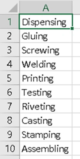

The values for the Custom_TaskType attribute are stored in the input file located in the knowledge resource set of data setup app. The first column of the sheet contains the list of Task Type values for Operations.
Please refer below image for input csv file.
Template CSV Format:

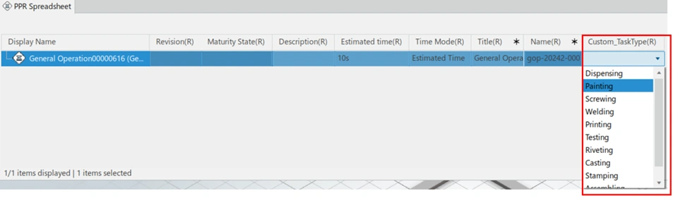

When the user opens a General operation in the PPR Spreadsheet and double clicks on Custom_TaskType, Business Logic (BL) script is triggered.
This BL will populate the dropdown for the Custom_TaskType attribute with authorized values from a resource set file.
Note: The authorized values in the sheet can be updated in the future. If new task types like "Painting" need to be added, the user will modify the sheet, and the dropdown will be updated to reflect these changes

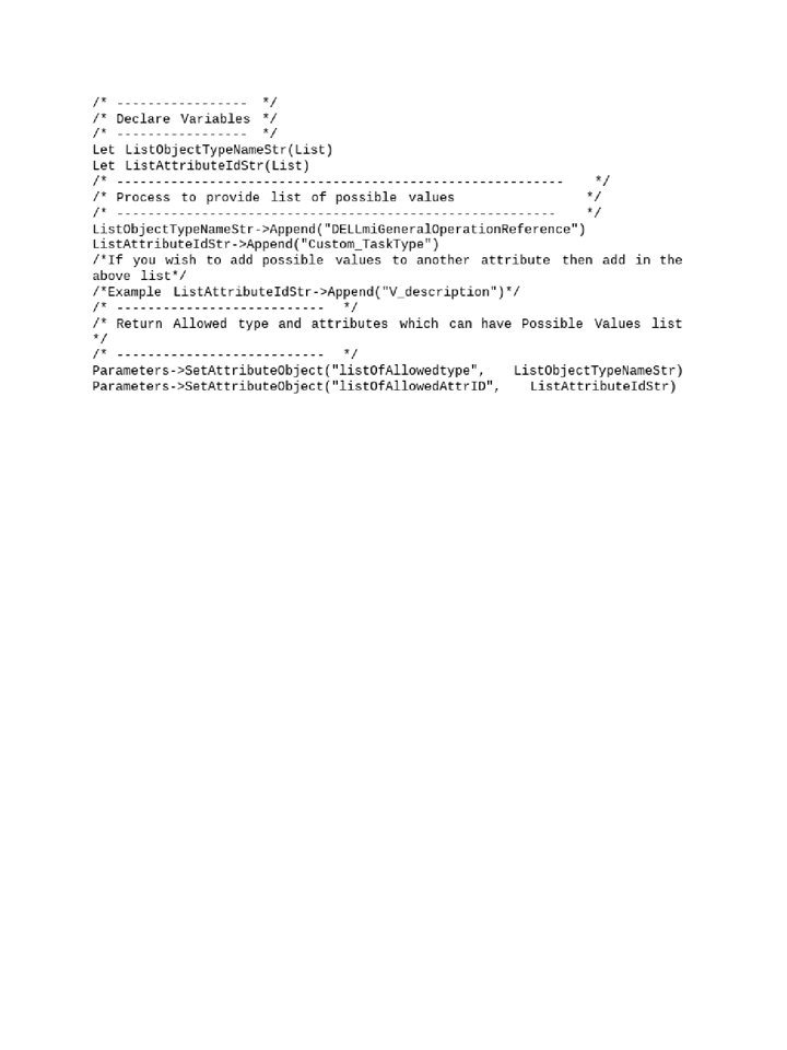

Logic to List Allowed Object Type and Attribute: {PPRSpreadsheetCheckObjectTypeAllowedForPossibleAttributeValues_ID}
Let ListObjectTypeNameStr(List)
Let ListAttributeIdStr(List)
/* Process to provide list of possible values                */
ListObjectTypeNameStr->Append("DELLmiGeneralOperationReference")
ListAttributeIdStr->Append("Custom_TaskType")
/*If you wish to add possible values to another attribute then add in the above list*/
/*Example ListAttributeIdStr->Append("V_description")*/
/* Return Allowed type and attributes which can have Possible Values list */
Parameters->SetAttributeObject("listOfAllowedtype", ListObjectTypeNameStr)
Parameters->SetAttributeObject("listOfAllowedAttrID", ListAttributeIdStr)

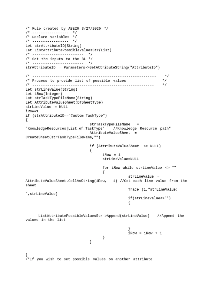

Logic to set Authorized values: {PPRSpreadsheetListPossibleAttributeValues_ID}
if (strAttributeID=="Custom_TaskType")
			strTaskTypeFileName  = "KnowledgeResources|List_of_TaskType"  //Knowledge Resource path"
			AttributeValueSheet = CreateSheet(strTaskTypeFileName,"")
			if (AttributeValueSheet <> NULL)
				iRow = 1
				strLineValue=NULL
				for iRow while strLineValue <> ""
					strLineValue = AttributeValueSheet.CellAsString(iRow, 1) //Get each line value from the sheet
					Trace (1,"strLineValue: ",strLineValue)
					if(strLineValue<>"")
						ListAttributePossibleValuesStr->Append(strLineValue) //Append the values in the list
					iRow = iRow + 1

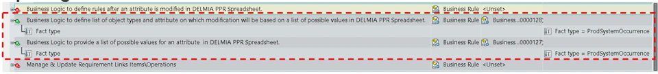

Business Rule Deployment
The below page can be referred for Business Rule deployment.
How to Deploy Business Rule
For deployment using Data Setup app following Resource set ID and opening needs to be used:
