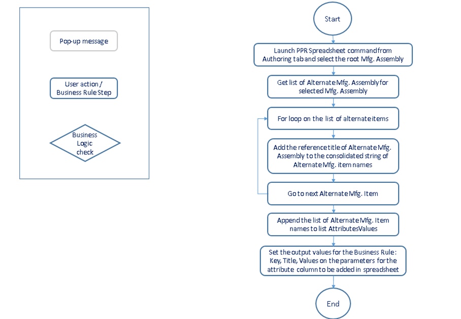

Example1: Display Alternate Mfg. items in PPR Spreadsheet Editor

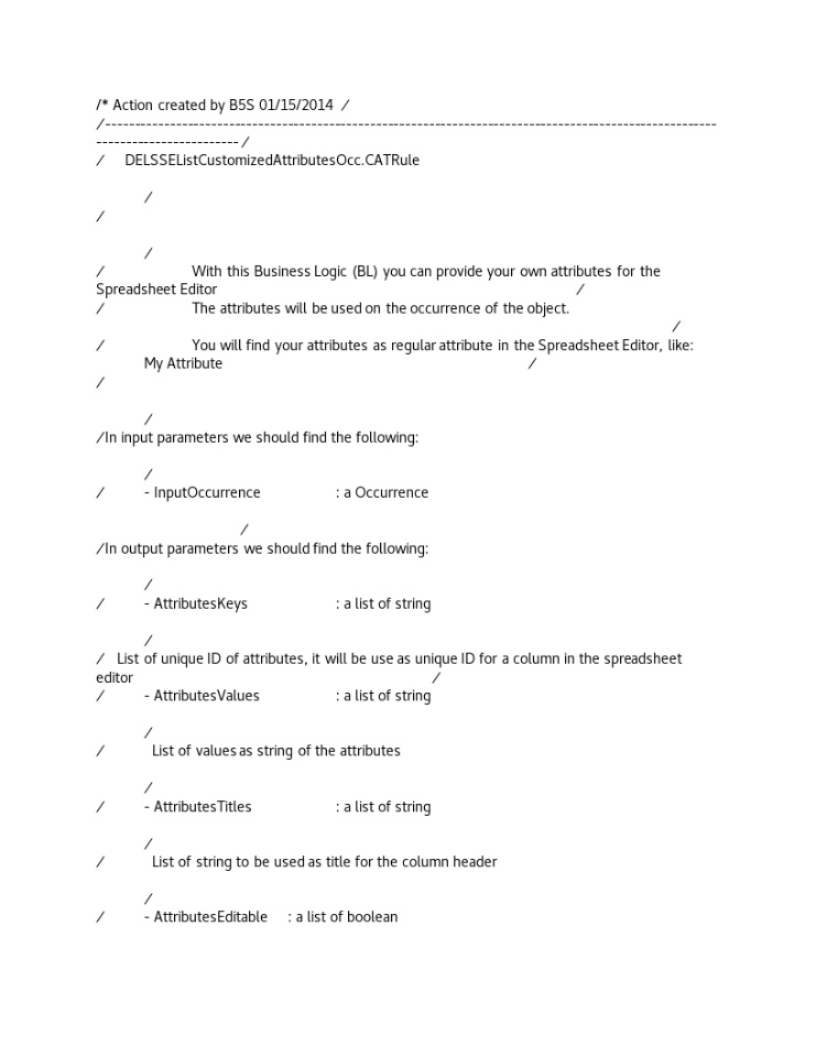

In this example the OOTB Business Rule DELSSEListCustomizedAttributesOcc.CATRule is customized to display the alternate Mfg. item names in the custom column added in front of the Mfg. item in the spreadsheet editor.
Example 1: Logical Flow
Example 1: Business Rule
DELSSEListCustomizedAttributesDELFmiFunctionReference.CATRule
Detail Description:
This business rule gets invoked when we select a row/ multiple rows in a PPR Spreadsheet Editor and do a refresh by a click on sign in the PPR Spreadsheet Editor.
If the Mfg. item has more than one alternate Mfg. items then the titles of the alternate Mfg. items are displayed separated by a comma ‘”,”.
In similar way we can add a column displaying any other attribute/ information in the PPR Spreadsheet Editor.

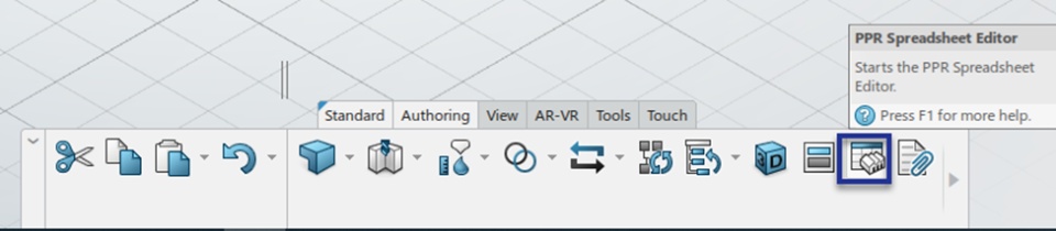

Select the Spreadsheet Editor command from the Authoring tab and select the root Mfg. item.

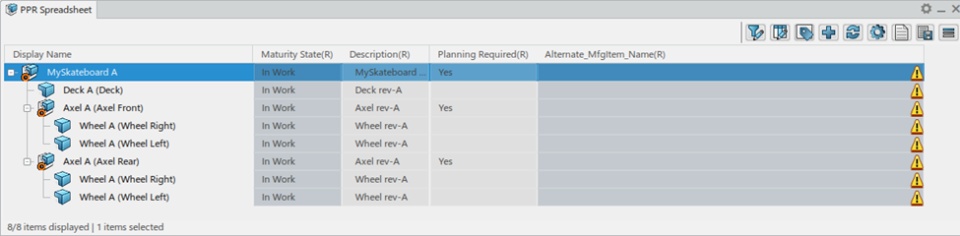

We can see a column ‘Alternate_MfgItem_Name’ is added at the right.
The symbol at the right end indicates that there is a Business Rule present for that column in the PPR spreadsheet. We need to refresh the PPR spreadsheet editor to see the column valuated by business rule.
We need to select the row and click on the symbol to refresh the editor in order to see the values in the column.
The alternate Mfg. item for provide ‘Deck’ can be seen in the right most column ‘Alternate_MfgItem_Name’. That is ‘Deck 2’.

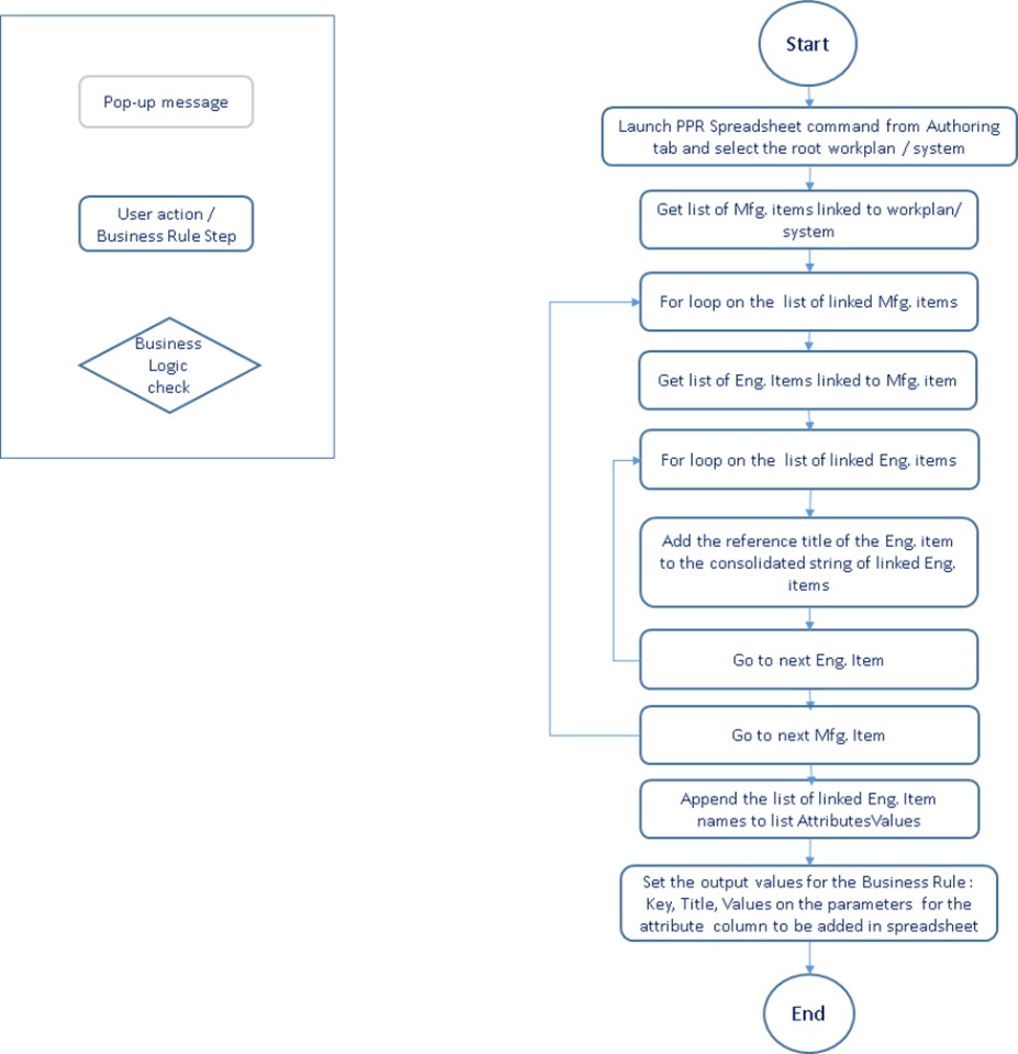

Example 2: Logical Flow

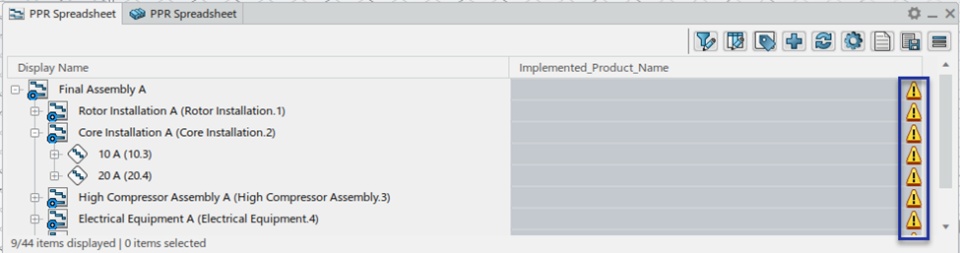

We can see the error ​​​​​​​ sign in the PPR Spreadsheet editor when we deploy this Business Rule. This business rule gets invoked when we do a refresh on the PPR Spreadsheet editor. We can see the column values after refresh.
Logic to traverse to linked Mfg. items from operation
oListOfAssignedProcesses = oProdSysOccurrence.AssignedProcesse
Logic to traverse to linked Eng. Items from Mfg. item
listOfProdOcc = oMfgProcOcc.AssignedProduct
Logic to read reference attribute value on Eng. Item
Set oVPMReference = oProdOcc.Reference
strProdName = oVPMReference.V_Name
Logic to add column title and column values to PPR spreadsheet editor
AttributesKeys.Append("ProductName")
AttributesValues.Append(strProdName)
AttributesTitles.Append("Implemented_Product_Name")
AttributesEditable.Append(false)

Select the PPR Spreadsheet Editor command from the Authoring tab and select the root workplan. If you want to see the linking in the spreadsheet then select the PPR.
The PPR spreadsheet can be seen with different tabs for Eng. Structure, Mfg. structure, Workplan structure and Resource structure.​​​​​​​
We can see a column ‘Implemented_Product_Name’ is added at the right. We need to select the row and click on the symbol to refresh the editor in order to see the values in the column.

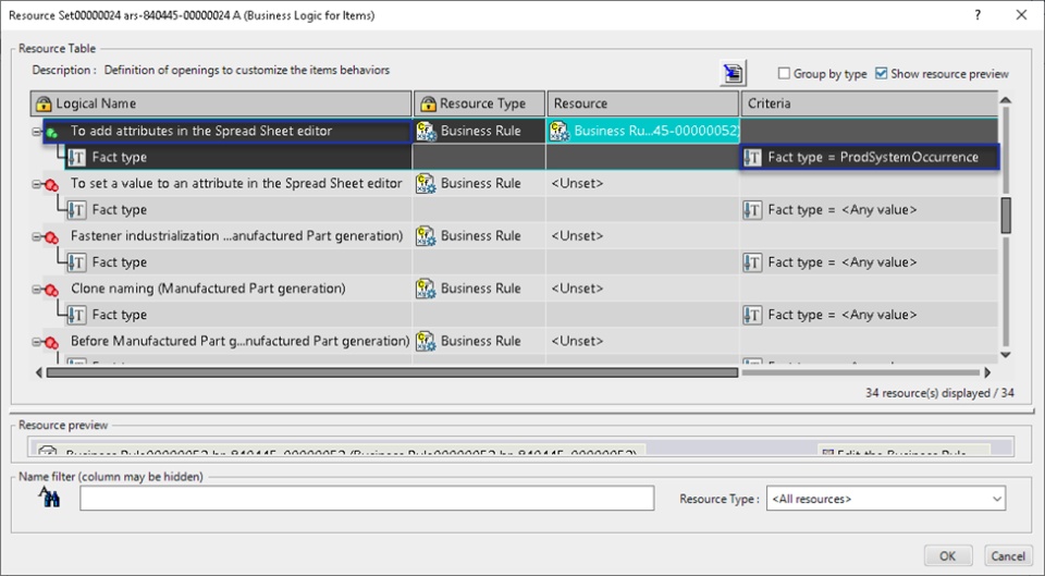

Business Rule Deployment
The below page can be referred for Business Rule deployment.
How to Deploy Business Rule

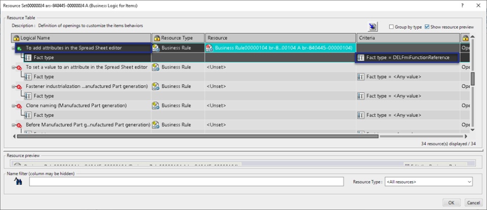

For deployment using Data Setup app following Resource set and Opening needs to be used.
Resource Set:
Opening:
Example 1:
   Example 2:
