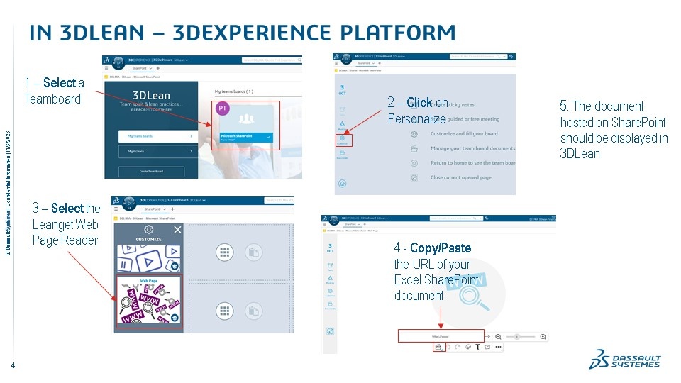

Do you want to embed you Microsoft office files in 3DLean?
If you are using Sharepoint, you just need to :
- Right-click on a file (Excel, word, powerpoint) and select ‘Open/View in Browser’.
- The file will then open in a web browser and not in the app.
- Use the url in 3DLean web page reader.
This way, the team can edit the files collaboratively, while staying synchronized with the master file in Sharepoint.
How to integrate hosted MS SharePoint documents into 3DLean - A Step-by-Step Guide
Key takeaways
- This integration permits only read-only access to Microsoft files hosted on SharePoint.
- Editing Microsoft files requires opening a separate browser tab, which can be initiated by clicking a designated button in 3DLean.
