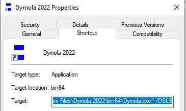

DSLS Target ID
DSLS requires a target ID, specific to the machine. To get the target ID:
- if Dymola is already installed, modify the shortcut to launch Dymola in DSLS mode, with: /DSLS
- go into Tools > License Setup > Details
- The local host id is the required target ID
