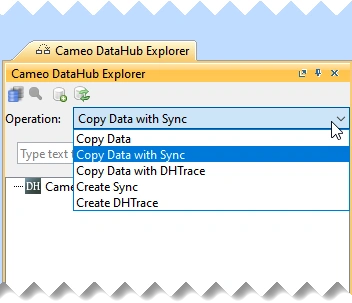

Operations in DataHub Explorer
The Operation list in the Cameo DataHub Explorer panel provides several options for you to work with your data.
The table below briefly explains the functions of the DataHub operations.
Operation Function
Copy DataOnly copies the data with child nodes.
Copy Data with DHTraceCopies data and creates DHTrace links between the source and target nodes. DHLinks are used to trace the changes.
Copy Data with SyncCopies data and creates synchronization (DHLinks) between the source and target nodes. Nodes in the modeling tool are updated or deleted whenever their corresponding nodes in associated tools are updated or deleted. The newly created nodes can be transferred to other associated tools as well.
Create DHTrace (with OSLC links)Creates DHLinks between the source and target nodes without copying any data.
Creates an OSLC link from an IBM® Rational® DOORS® Next Generation Data Source to a MagicDraw® element.
Create SyncRecreates synchronization (DHLinks) if you lose or delete the DHLinks without replicating the data.

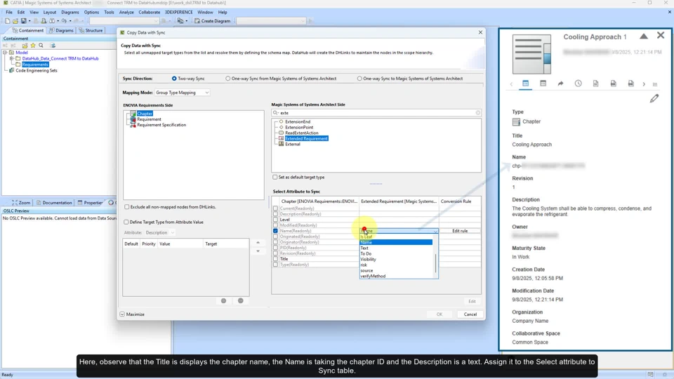

Copy Data with Sync operation
In this operation, a DHLink for synchronization is added to the data. It maintains the structure and data of the elements within the node. During data synchronization, DataHub searches for any new nodes and deleted nodes. If it finds any new nodes or deleted nodes within the scope on one side, DataHub copies them to the other side and creates a synchronization relation between them or deletes them from the other side.

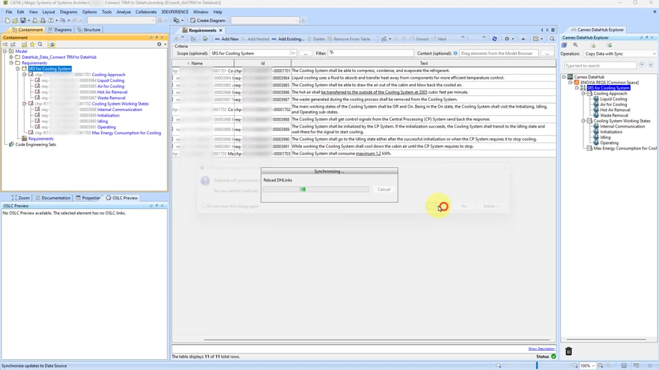

Use Case 1: Copy Data with Sync Operation from ENOVIA Requirements to CATIA Magic
Scenario: A systems engineer initiates a Copy Data with Sync operation to copy validated requirement changes from TRM to CATIA Magic, enabling seamless traceability and model alignment.
Personas: Dave, Systems Architect is responsible for maintaining requirement traceability. After requirements are updated in ENOVIA Requirements, he triggers a sync operation to copy the latest data into CATIA Magic, ensuring the system model stays aligned with the current specifications.
Workflow:

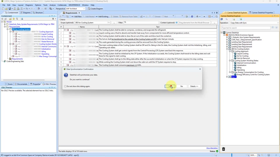

Use Case 3: Update Requirements from ENOVIA Requirements to CATIA magic
Scenario: The Systems Architect is assigned to update the system model in CATIA Magic by syncing the latest requirements changes from TRM, ensuring the architecture stays aligned with current specifications and traceability.
Actors/Personas: Dave, Systems Architect is responsible for updating requirements in TRM and syncing those changes into CATIA Magic to ensure the system model reflects the latest requirements and maintains accurate traceability.
Workflow:

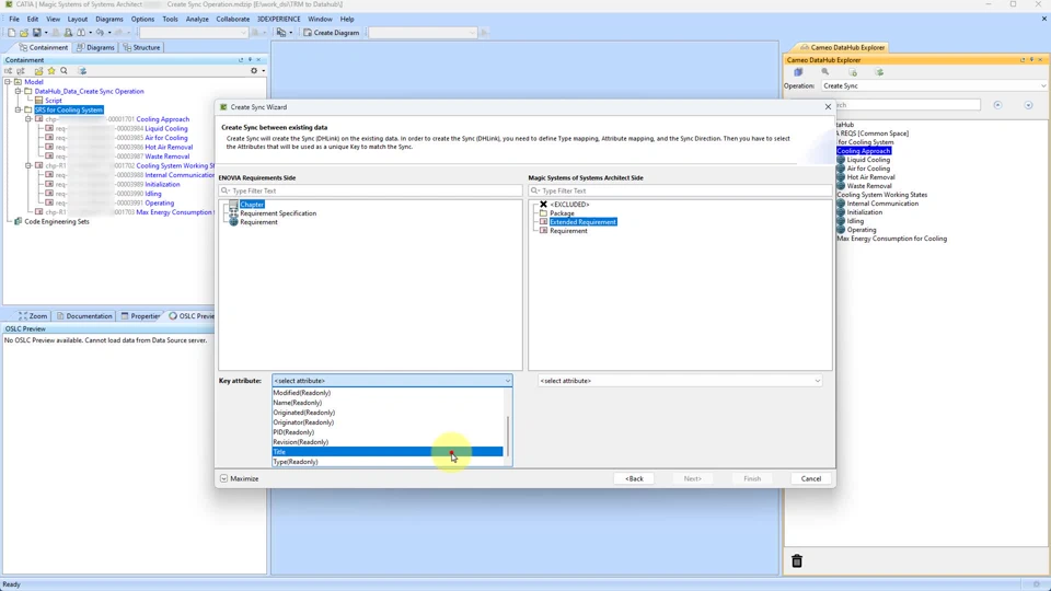

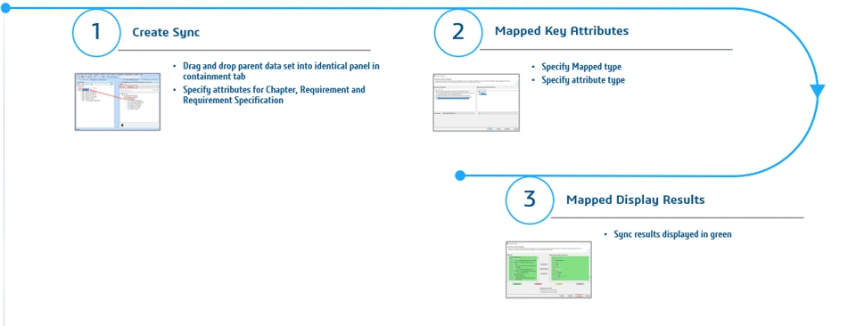

Use Case 4:  Create Sync Operation Between ENOVIA Requirements to CATIA Magic
Scenario: The Systems Architect is assigned to the synchronization process to transfer updated requirements from TRM to CATIA Magic.
Actors/Personas:
Workflow: Dave, Systems Architect is responsible for creating Sync operation between TRM to CATIA Magic.

Step 5: Create Sync Operation Between ENOVIA Requirements to CATIA Magic
