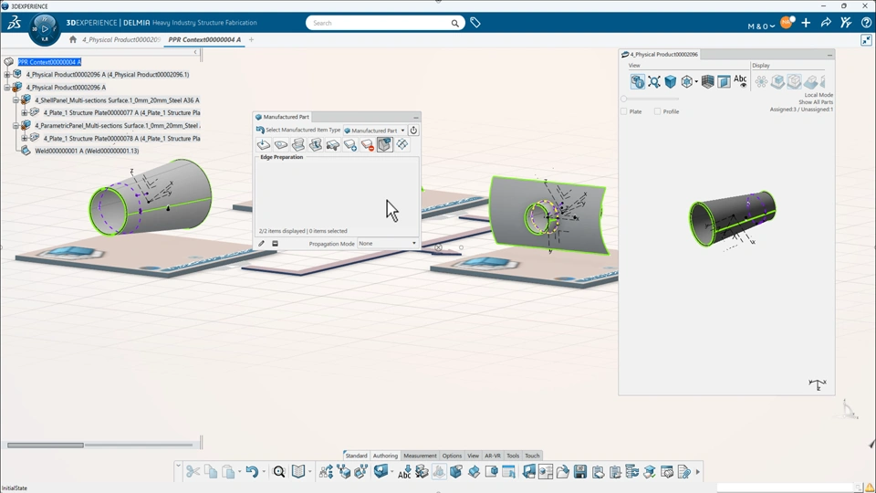

Closing functional gaps to automatically generate manufacturing features for cases that would otherwise would require additional manual intervention
-- by delivering manufacturing feature generation for closed shapes with circular or rectangular cross-sections made from plates
-- by providing profile fabrication sketch views for closed sections
-- by supporting to generate roll lines for double curvature plates
-- by supporting of marking generation for "intercrossing" (egg-crate) plate-plate connections
User Experience Value
Display multiple Eng Item to Mfg Item assignments in Synchronization manager to make it more simple for the end user to recognize such cases
Supporting of marking generation for "intercrossing" (egg-crate) plate-plate connections
Manufacturing feature generation for closed shapes with circular or rectangular cross-sections made from plates
