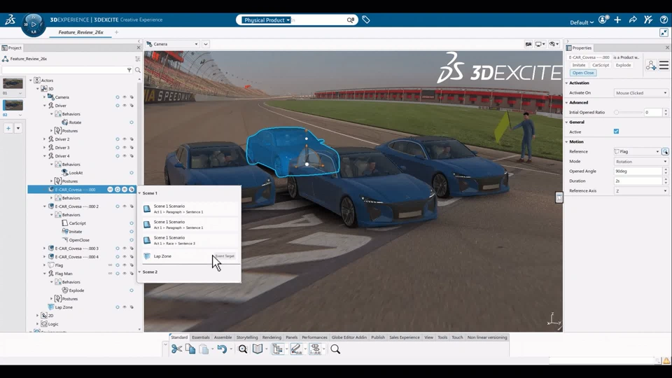

- Easily identify all objects that use an actor within an experience through the Used-By panel

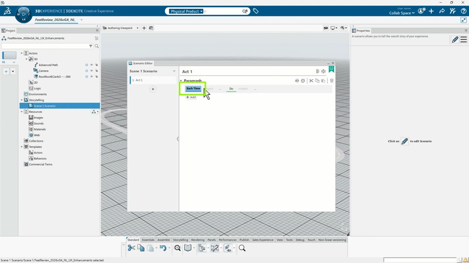

- More intuitive visual scripting through Natural Language with several user experience improvements

Used By command enables to find all references to an Actor
New Sequential Mode enables better readability and Each Time renamed to Do Always
