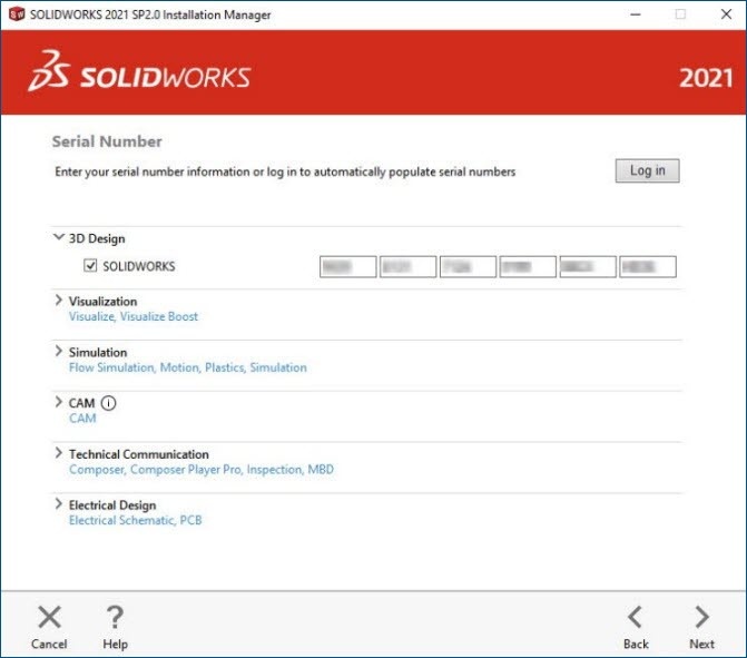

4. Input serial code in the 3D Design section and click next.
Note:
1. Leave other sections blank. Installation Manager will run system requirement check and if anything missing program will notify.
2. After system check installer will take you to the summary page to display all the products you will be installing

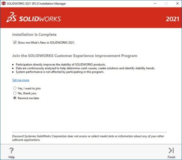

5. Accept terms and conditions and click Install Now.
6. Click Finish.
SOLIDWORKS is now installed on your computer.

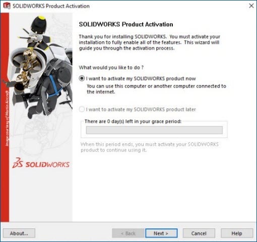

How to Activate SOLIDWORKS desktop.
1. Launch SOLIDWORKS.
2. Select the “I want to activate my SOLIDWORKS product now” option.
3. Select the “Automatically over the Internet” option.

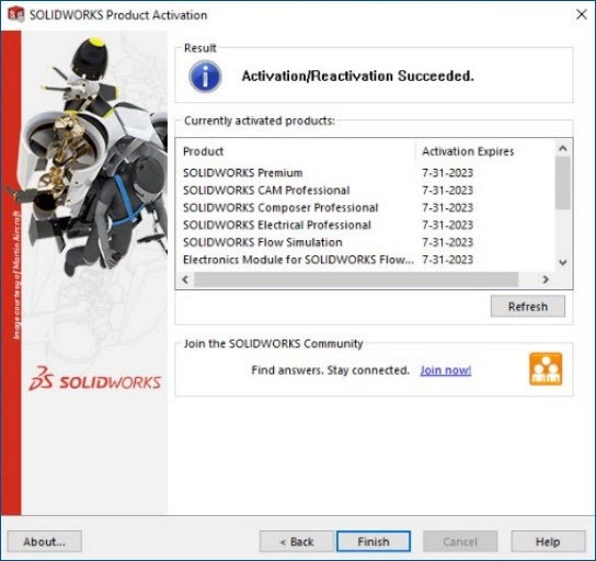

4. Enter your Email-Id and click next.
5. Click on a finish to exit activation.
