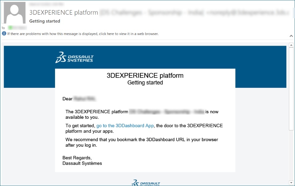

2. Open the invitation email and click on the link to 3DDashboard App
Once the Administrator grants a role, you will receive an invitation email, you need to accept the invitation through the link .

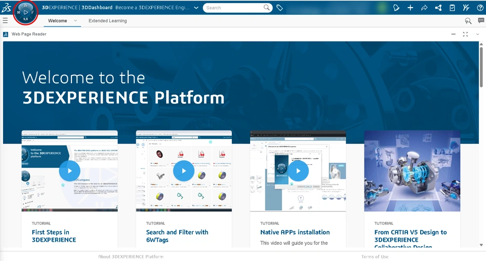

3. Click on the 3D Compass.
Log in to the 3DEXPERIENCE platform and Click My Compass (Top-left corner of browser).

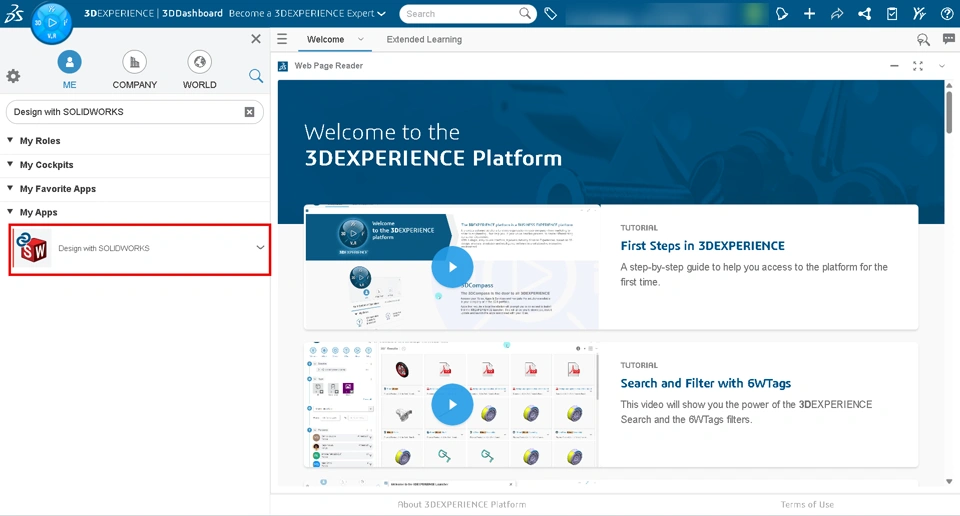

4. Search and Click on Design with SOLIDWORKS app (or SOLIDWORKS Add In app).
NOTE: If you are not able to see the app like the one in the screen below and you're seeing a bunch of advertisements on clicking the 3DCompass, then you are not using the right login link. Please use correct Login Link and set it as a Bookmark

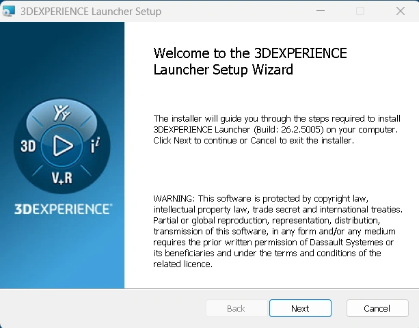

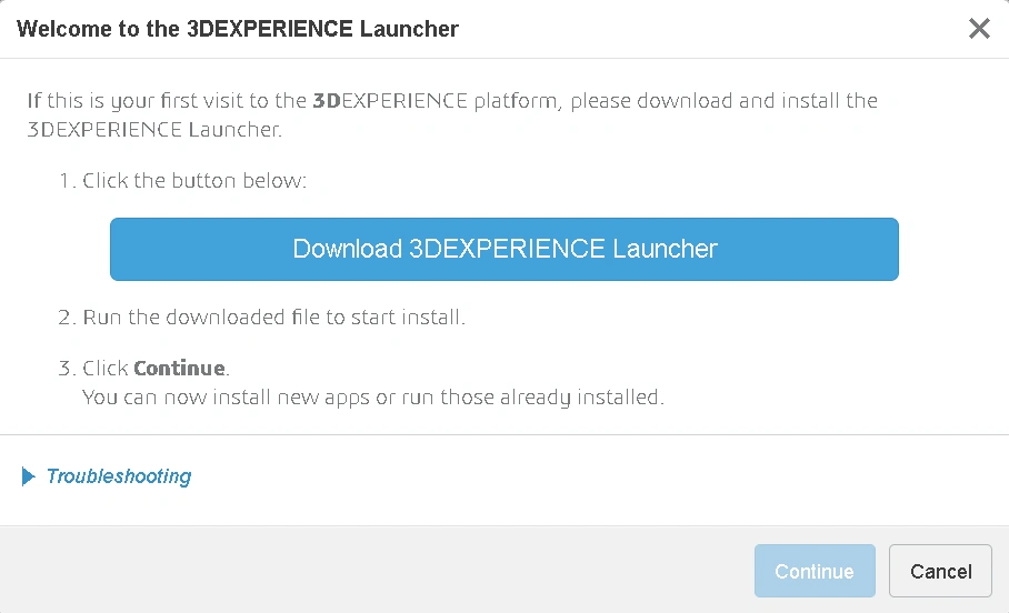

Note: If 3DEXPERENCE Launcher is not installed then a window will pop up to install it. a) Click on Download 3DEXPERIENCE Launcher
b) Run the downloaded file. c) Follow the setup instructions. d) Click on continue. |

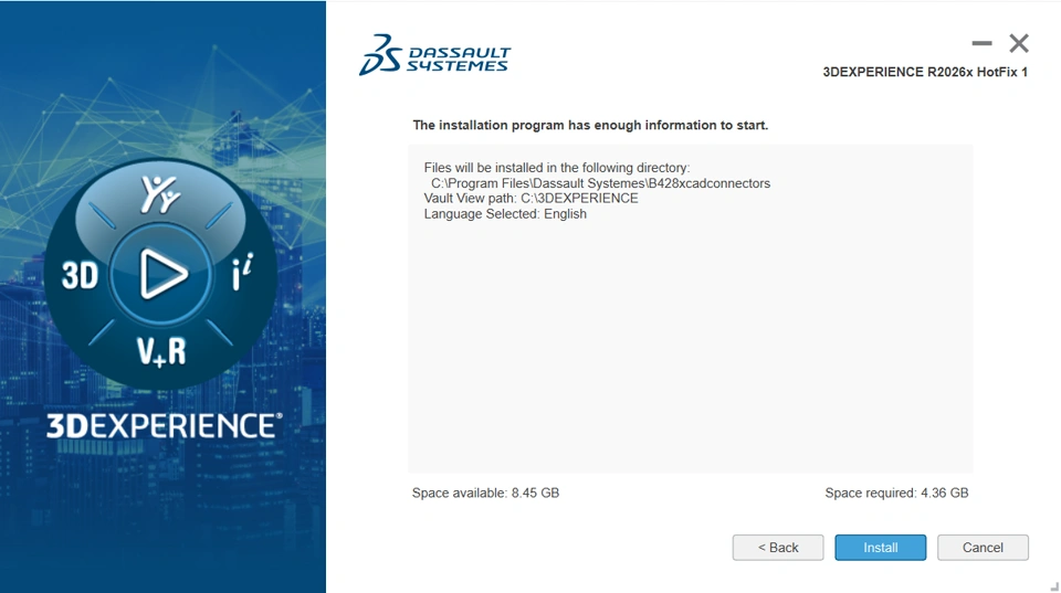

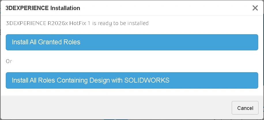

5. Click on Install All Granted Roles.

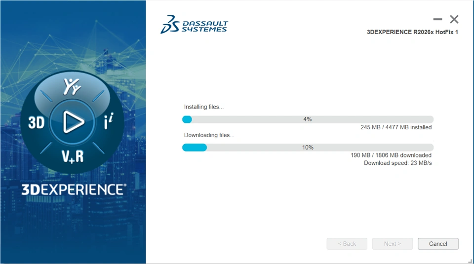

Design with SOLIDWORKS installation file set will be downloaded via the 3DEXPERIENCE Launcher, and the installation should proceed automatically.

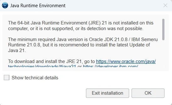

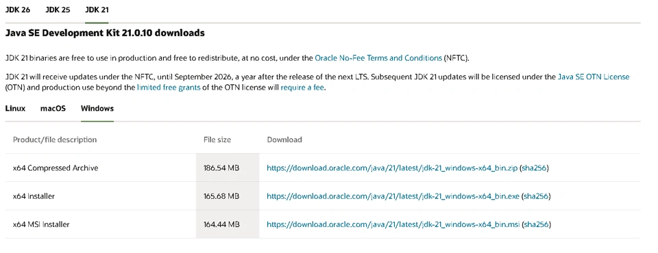

Note : If you haven't installed Java Development kit 21 (JDK 21) previously you will be prompted to install them now Click on the provided link and Install the JDK 21 |

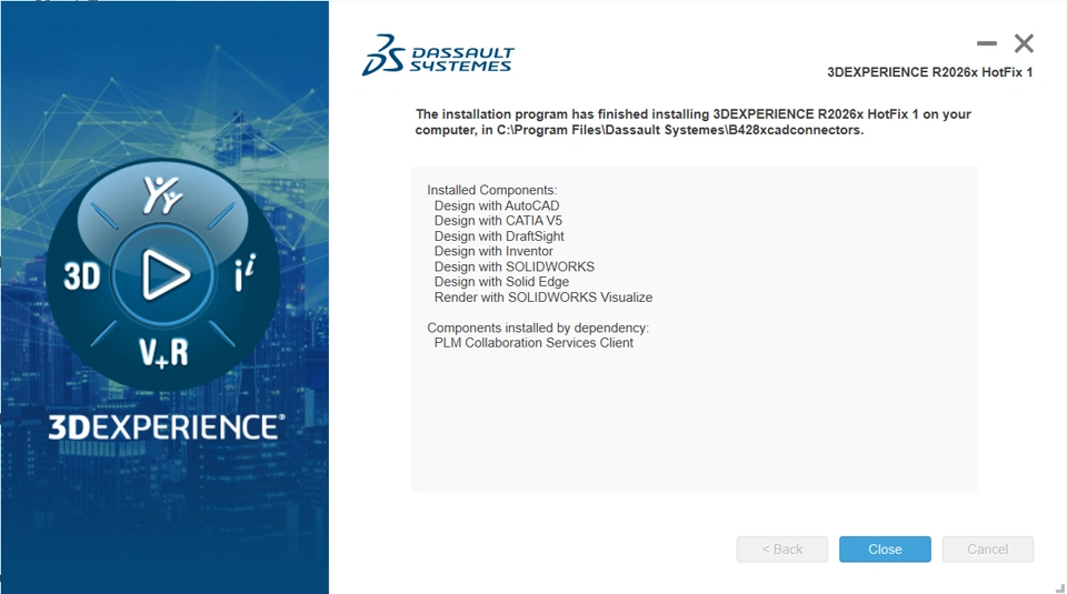

6. Follow the setup instructions
7. Message: Installation Success
