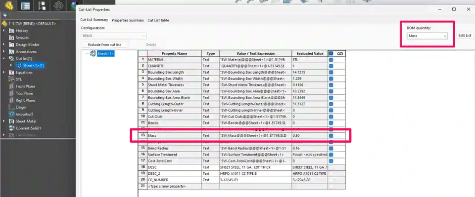

I would like a weldment cut list property to be displayed as the qty in my indented BOM.
For example, in image 1 below, I would like the qty of item 1.1.1 to be represented as mass. In image 2, it's shown I have the BOM qty set to mass. This makes me expect to have a qty of 0.50 in the BoM table, but it's not.
Image 2: 1-51749 Cut-List Properties
Achieving this would make it easier to create copy paste BoM info that can be compared to our ERP BoM via excel spreadsheet. No more discrepancy between CAD and BOM data and no need to buy integration software!
Any and all suggestions welcome!
