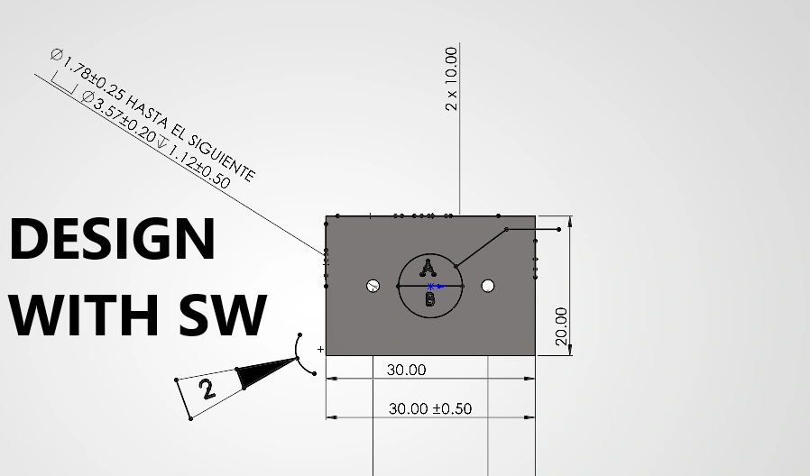

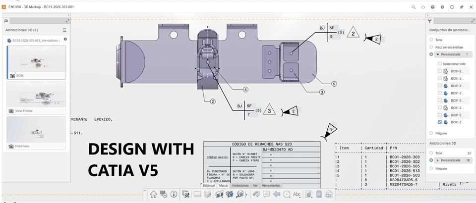

I am working with models created in SolidWorks, where I create annotations and several saved views to document different aspects of the design. However, when I open the model in 3D Markup within the 3DEXPERIENCE Platform, the saved views are not displayed in a clear and organized structure as they are when working with CATIA.
