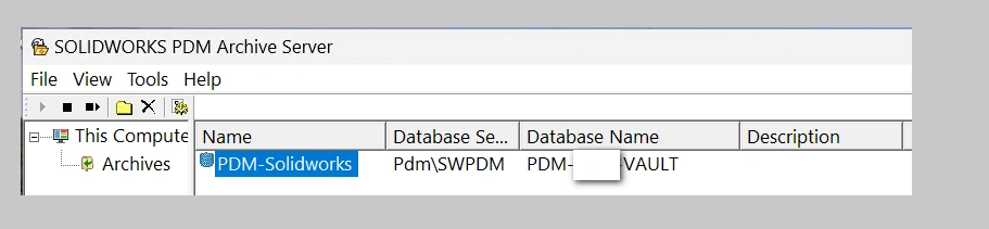

Is it possible to rename a PDM Vault?

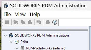

It seems that renaming the "Vault"s key makes the Archive disappear in the Archive Config.
In this case PDM-Solidworks is the original name I need to change, but if i change this Key to the new name, it fails.
I have changed the dbname(s) sucessfully and updated the archive pointers. all was well. this key name is the issue and is what is used for displaying the name in the Archive Config and Administration.
