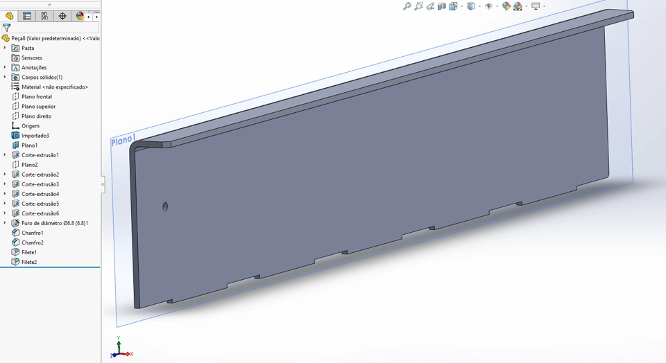

I am trying to convert a import bodie into sheet metal.
Some parts is converted, but i have problem into convert some bodies.
After to open the imported part, the FeatureWorks is starded and i select the Yes.
The FeatureWorks can't indentify the Extrusion (Corpo não reconhecido):
The final results is:

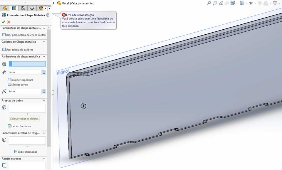

When i am try to convert into sheet metal, is not possible to select the Flat Face:
Some parts is possible to convert into sheet metal and other is not possible.
The part is attached in the first comment.
