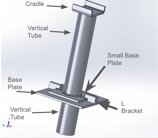

I’m looking for advice on contact modeling strategies in SolidWorks Simulation for a contact-dominated support structure, where both accuracy and computation time matter.
I need to run 200+ simulations (≈20 geometries × ≈10 load cases), so I’m trying to identify the simplest model that still captures the governing failure mode.
Model Overview (see attached image)
Built as a multi-body part (not an assembly)
Two welded substructures:
Moving body: cradle + vertical tube + small base plate (merged)
Fixed body: base plate + two L-brackets + vertical tube (merged)
Geometry ranges:
Tube thickness: 2–12 mm
Height up to 1000 mm
Plate thickness: 12 mm
Boundary Conditions:
Bottom of fixed tube fully constrained
Roller/slider on one side face of the moving plate
(blocks lateral motion, allows longitudinal sliding)
Contact Definition
I deleted Global contact.
Local contacts: No Penetration at :
Bottom of moving plate ↔ top of fixed plate
Side restraint:
Vertical faces of moving plate ↔ inner faces of brackets
(one side touching to prevent rigid body motion, other side with gap)
Uplift / tipping restraint:
Upper faces of moving plate ↔ underside of bracket horizontal legs
(modeled physical gap of 5 mm)
Modeling Strategies Compared
I tested three approaches:
A) All solid elements
it takes a lot of time, sometimes it doesn't finish ( i think it converges )
B) Mixed solid / shell ( SOLID : 2 plates and the L brackets / SHELLS : the rest )
Solids in contact regions
Shells for tubes and cradle
Peak stress location and magnitude differ noticeably from (A)
C) All shell
Much faster
But unclear reliability for contact, gap closure, and load transfer
For contact-dominated problems, is all-solid generally the only reliable option in SolidWorks?
Is an all-shell model ever acceptable when contact, gaps are involved, or should it be avoided entirely?
