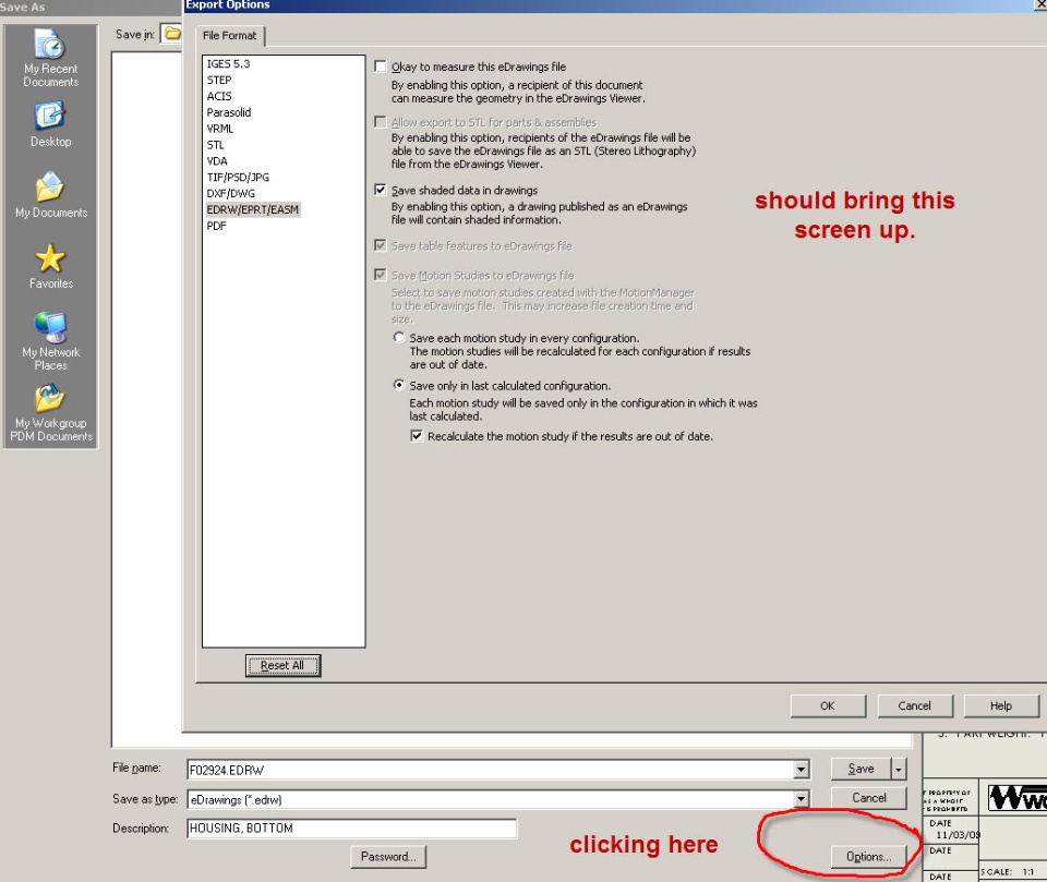

Enable measuring on eDrawing?
I want to send an eDrawing to a vendor.  I can't figure out how to enable measuring on the file.  How do you do this?
