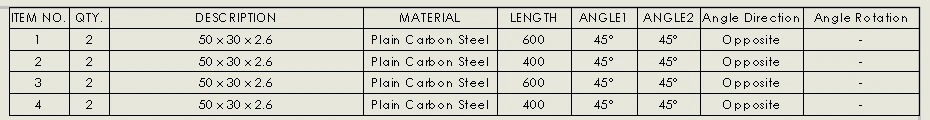

Hello SOLIDWORKS users. Could one of you help me with the following question. I am using a weldment structure as in the image below: Not that this is using a rectangular tube, the top one is rotated 90 degrees around the tube axis, the bottom one is the original orientation of the weldment profile.
When generating the weldmet cutlist i get the following list. Note that it is not possible to see if the profile is cut along the short or the long side.
how can we identify the correct cutting order from these cutlist if it doen not take into account the rotation of the profile. Anyone have a solution for this?
