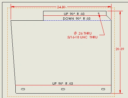

Working on some side panels for a bench and one of the sides is calling out an up bend as a down bend. I could use some help on troubleshooting because it is so strange I don't know where to start. All the other bend lines are correct (it is not flipped view) and on the other side the flat pattern is coming out properly for the other part. One final thing to note is our solidworks is a little outdated (2013) if that makes a difference. Pictures attached show the part itself as well as the drawing and the drawing for the other side that seems to fine, both sides were modelled using a solid body converted to sheet metal with cuts added afterward for the holes.
