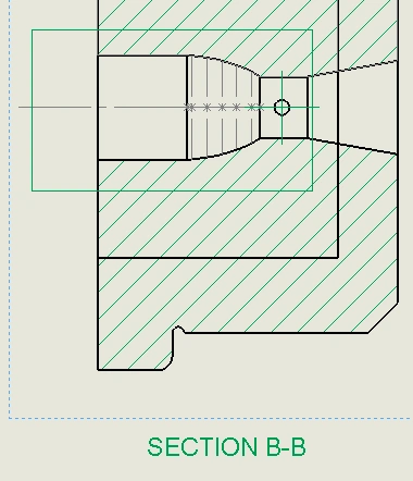

I am running SW 2025 SP5.0. When I set sketches to visible on a drawing they work as they should in a normal view but if I crop the view or create a detail view I can no longer see the sketch. I browsed through all the drawing and color settings but didn't see anything in there that seemed to fit this issue. Any suggestions?
First screenshot is before crop. Second is after crop without changing anything else.
