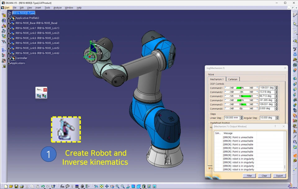

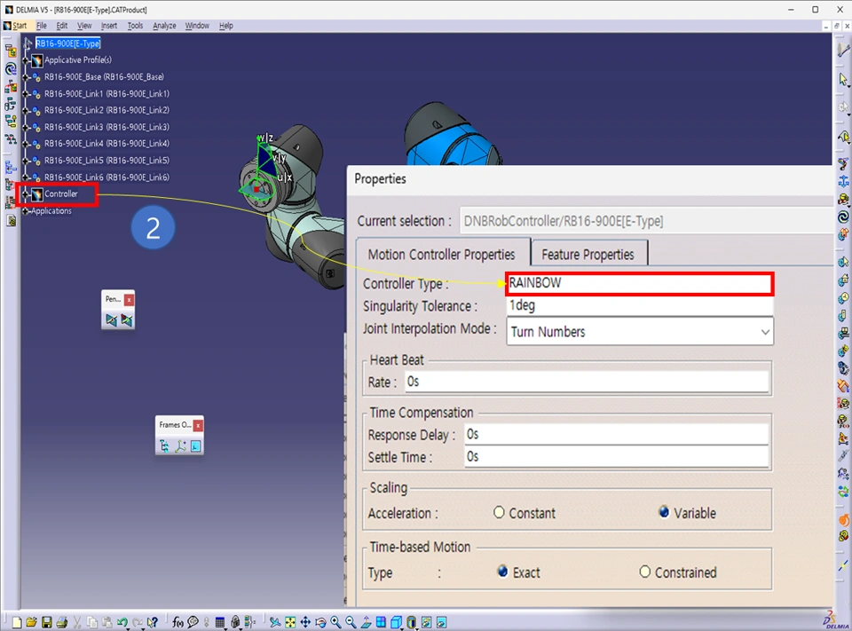

Step1 :Robot Generation (Rainbow robot) and Inverse Kinematic Application
Step2 :Chaning Robot Controller Type

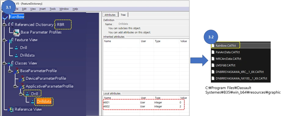

Step3.1 : Create Feature and Save
Step3.2 : Save .CATfec file (ex: RainBow.CATfct)

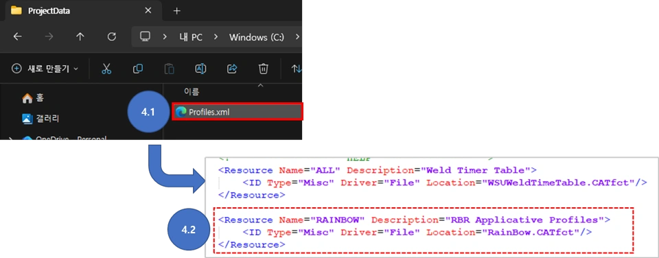

Step4.1 : Open Profiles.xml (C:\\Program Files\\Dassault Systemes\\B35\\win_b64\\startup\\Igrip\\ProjectData)
Step4.2 : Defining a Project Resource Management File

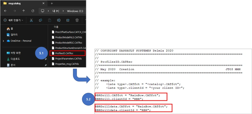

Step5.1 : Open profiles.CATRsc (C:\\Program Files\\Dassault Systemes\\B35\\win_b64\\resources\\msgcatalog)
Step5.2 : ADD the Text

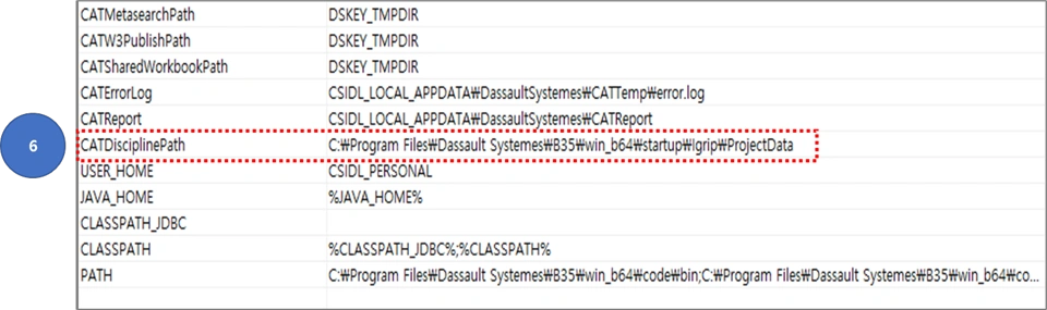

Step6 : Set the CATDisciplinePath Path(CATDisciplinePath = C:\\Program Files\\Dassault Systemes\\B35\\win_b64\\startup\\Igrip\\ProjectData)

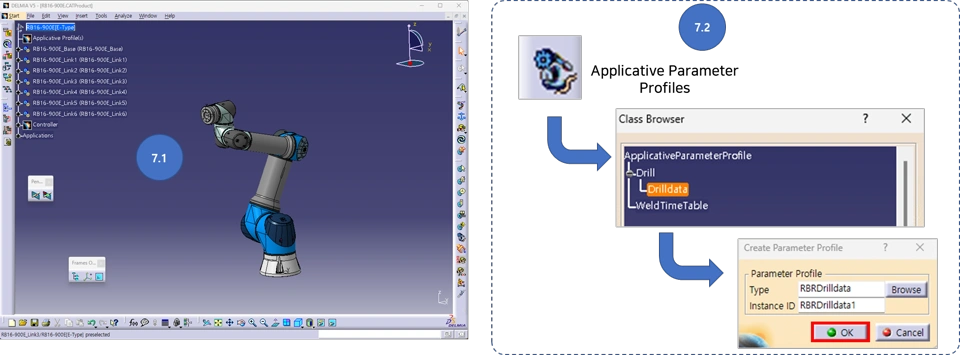

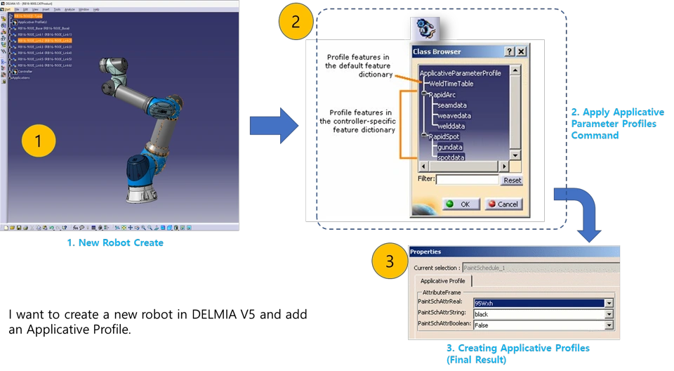

Step7.1 : Restarting Delmia V5 and Open the RainBow Robot (at Device Building App)
Step7.2 : Apply Applicative Parameter Profiles function (Repeat 2 times)

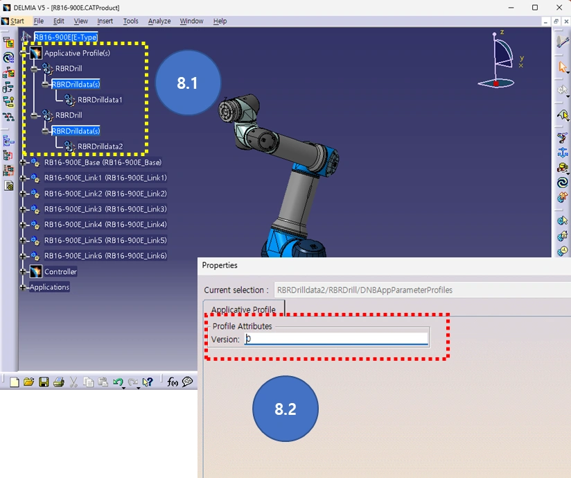

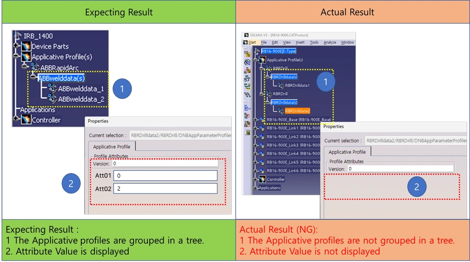

Step8.1 : Observe the Result (Tree)
Step8.2 : Observe the Result (Properties)
Final Result
