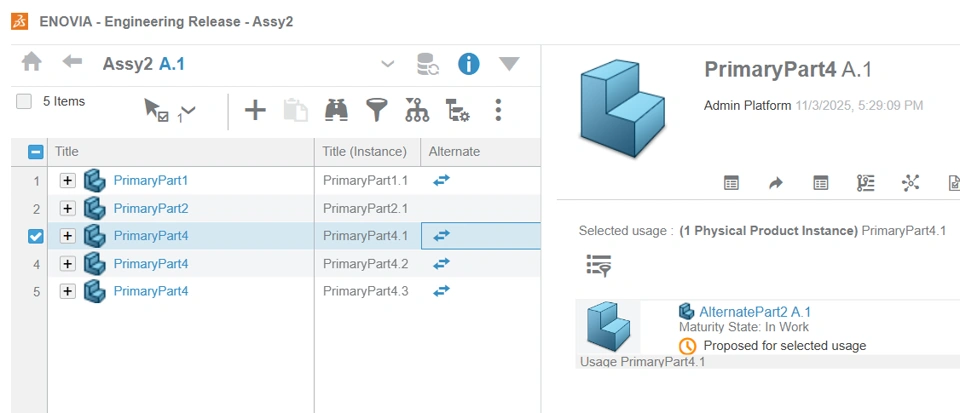

We are trying to retrieve Alternate Parts for a Primary Part using the Report Template Administrator (RGD).
Below is the template definition we used. This definition is giving all the Alternate Part irrespective of the applicability context. For example, for the below assembly "Assy2", the definition is giving "AlternatePart2" for all the "PrimaryPart4" instances even though it is added as "Selected Usage" for instance "PrimaryPart4.1".
How can I extract alternate part only for a particular instance ?
