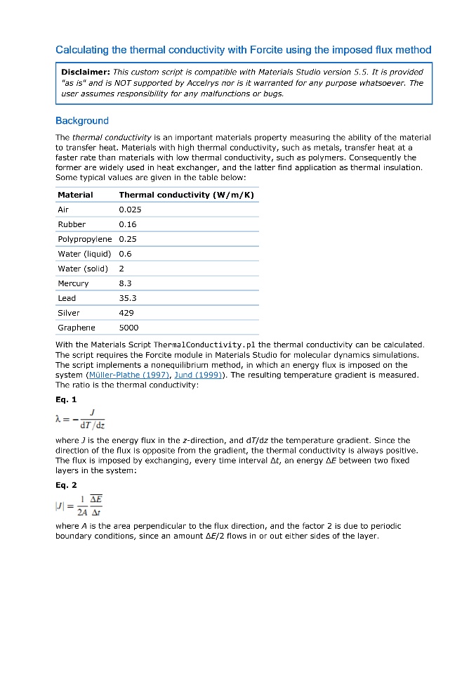

Firstly, I use the Materials Studio2017 Forcite module to measure the ability of the SWCNT (Single-Walled Carbon Nanotubes) to transfer heat. In other words, it’s the thermal conductivity of the SWCNT. The simulation is driven by script written in the programming language PERL, referring to the example of argon at density 0.2652 g/cc and temperature 500 K that Reiniera provides.(Appendix)

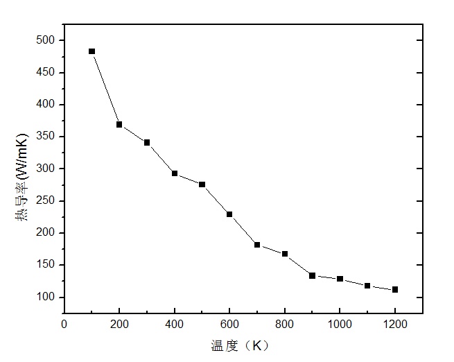

The thermal conductivity of (6,6) single-walled carbon nanotube (SWNT) with the length of 245.95nm, the diameter of 8.14 Å, the thickness of 3.34Å(diameter of carbon atom and I change the cellarea to 85.37 Å in line 201) is 197.70W/m•K. That’s different from the value of 341.07 W/m•K which I do the simulation using the Lammps software with the same SWNT model.

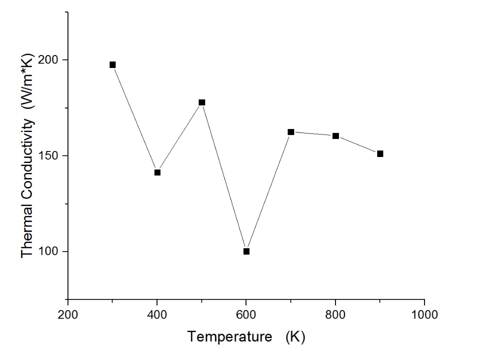

Then, I change the temperature (line 108 in the Perl script) to study how the thermal conductivity of the SWCNT change with the temperature. Disappointingly, the thermal conductivity has almost no change with the temperature change(show in the figure1).Actually, we use the LAMMPS to simulate and get the result that the thermal conductivity of the SWCNT decreases with the increase of temperature(show in the figure2).
