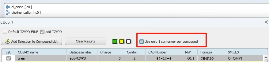

Step 1: Add two ions of choline chloride to the list of compounds, then add a single conformation of urea to the list. (Please check if only one conformation of urea is added)

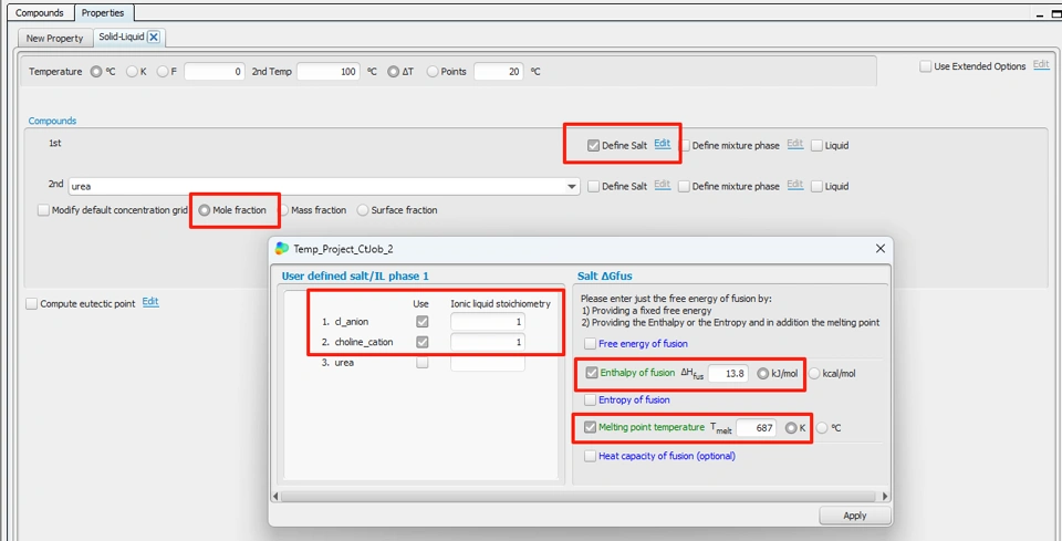

Step 3: Select the Solid-Liquid module.

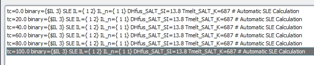

Step 4: Define the two ions of choline chloride as salt, and add two parameters (∆Tfus and ∆Hfus). The second compound is urea.
Step 5: Set the temperature range for the simulation. As shown in the figure, just mole fraction is seleted.
Step 6: Add the task to the table and start running.
Choline chloride: ΔTfus=687 K, ΔHfus=13.8 kJ⋅mol−1
Urea: ΔTfus=406 K, ΔHfus=14.6 kJ⋅mol−1
