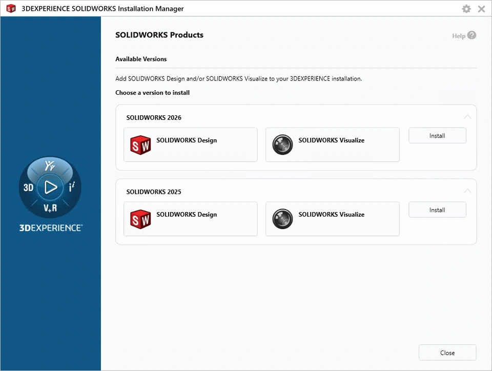

Selecting Choose the version to install and update on-demand will install only 3DEXPERIENCE platform components and prompt you to launch the 3DEXPERIENCE SOLIDWORKS Installation Manager at the end of the installation.
Using the 3DEXPERIENCE SOLIDWORKS Installation Manager, you can select which version to install from the list of Available Versions.
You can select which apps (1) and which service pack (2) to install.

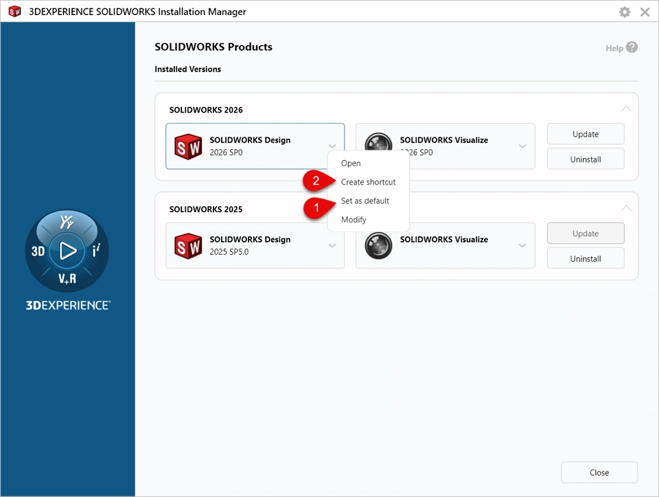

Launch the 3DEXPERIENCE SOLIDWORKS Installation Manager at any time from Windows Start menu to modify (1) or update your existing SOLIDWORKS Apps installation (2) or install another version side-by-side (3).
If you install multiple versions of SOLIDWORKS Apps, launch the 3DEXPERIENCE SOLIDWORKS Installation Manager to declare which version will launch by default from the Platform (1). For more control, create a version-specific shortcut (2).

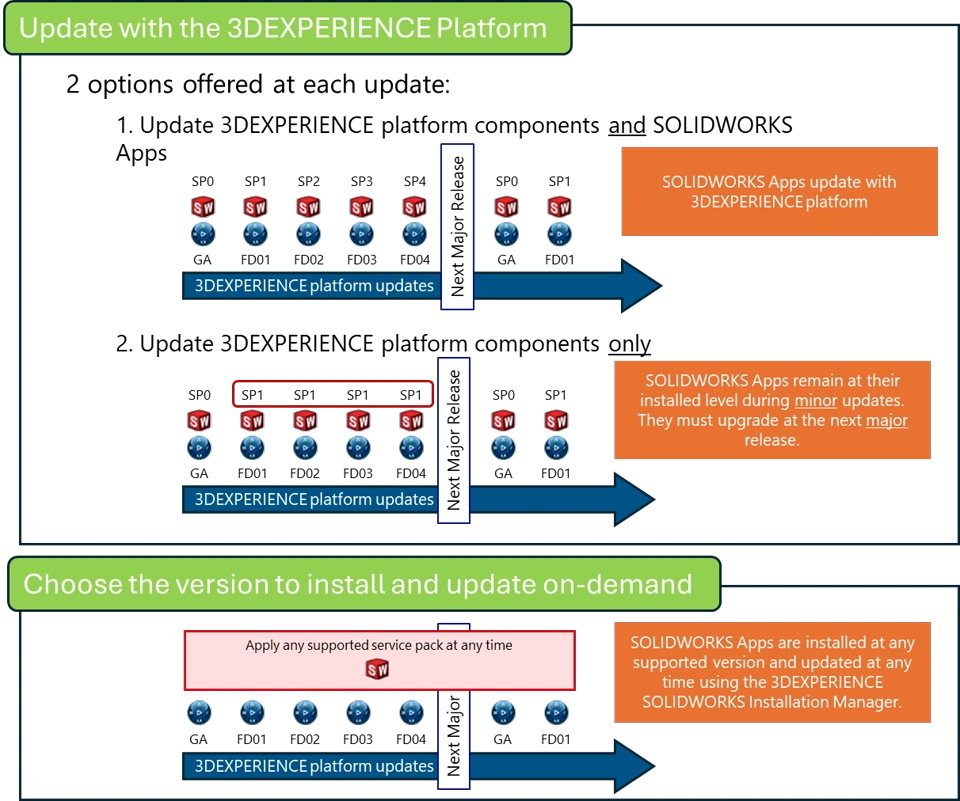

Update with the 3DEXPERIENCE platform - the SOLIDWORKS Apps are updated to the next service pack with each FD of the 3DEXPERIENCE platform. This is option 1 in the infographic below.
In 2025x_FD04, an option was added to update only the platform components. This lighter update keeps your SOLIDWORKS Apps at their current service pack level until you decide to update them at the next platform FD or by reinstalling. SOLIDWORKS Apps cannot remain at an older major release during a major version upgrade. This is option 2 in the infographic below. The user has stopped upgrading their SOLIDWORKS Apps at FD01 in this example.
Choose the version to install and update on-demand - the installation of the SOLIDWORKS Apps is separated from the 3DEXPERIENCE platform components. You can install any supported service pack of your SOLIDWORKS Apps. Update the SOLIDWORKS Apps on your schedule even while the platform components update at their required cadence.

A: Launch the 3DEXPERIENCE SOLIDWORKS Installation Manager at any time from the Windows Start menu. Find the version in your list of “Available versions” and click Install. By default, older versions will be uninstalled, but you can choose to keep the existing version to run versions side-by-side.
