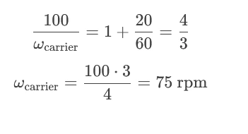

Case 2: Sun Gear Fixed
- Fixed Component: Sun Gear (ωsun=0)
- Input: Ring Gear (ωring=100 rpm)
- Output: Carrier (ωcarrier)

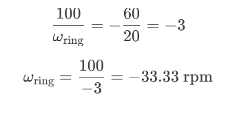

Case 3: Carrier Fixed
- Fixed Component: Carrier (ωcarrier=0)
- Input: Sun Gear (ωsun=100 rpm)
- Output: Ring Gear (ωring)

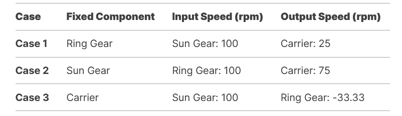

Summary of Speeds

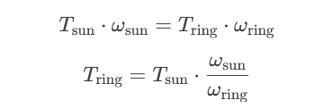

Assume the input torque is (100 Nm) the torque calculation will be:
Case 1: Ring Gear Fixed
- Fixed Component: Ring Gear (0ωring=0)
- Output: Carrier (ωcarrier=25 rpm) (from earlier calculation)

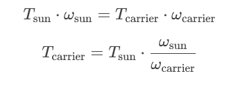

Torque Relationships:
The torque on the sun gear (Tsun) and carrier (Tcarrier) are related by:
Torque on Ring Gear:
Since the ring gear is fixed, it reacts to the torques on the sun gear and carrier. Using equilibrium:

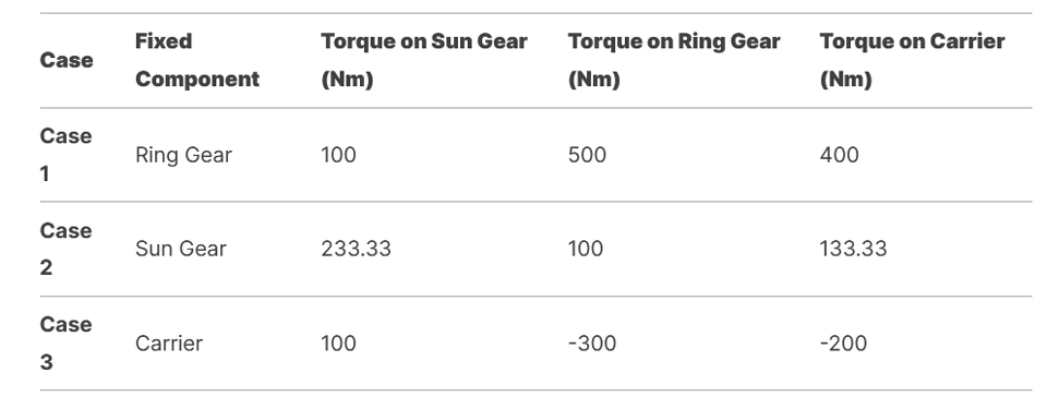

Summary of Torque Results
