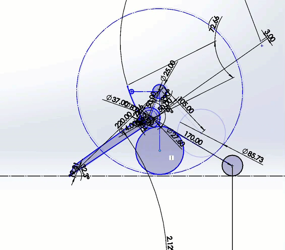

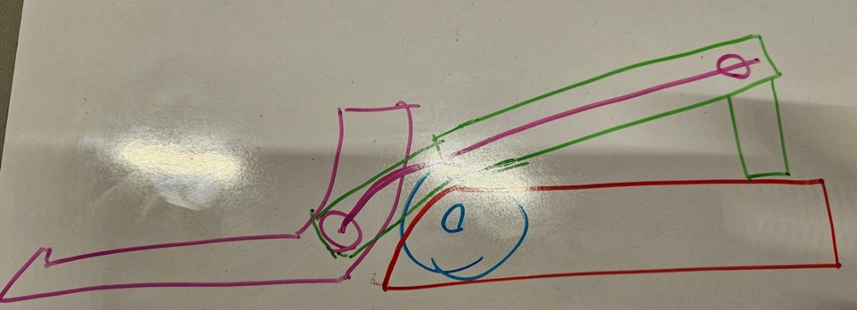

Here's a smattering of whiteboard side sketches over some period of time, all various weird methods of trying to introduce a spinner to an opponents underside.
Do these types of sketches enough and you'll get more and more calibrated to what "real" dimensions look like, but eventually things get funky enough it's time to first up Solidworks and add some real dimensions. The other large advantage here is being able to drag around and move things/change sizes without redrawing and erasing losing fidelity every time.
So believe it or not most of the work of getting to this stage happened in the whiteboard and Solidworks sketches shown above.
