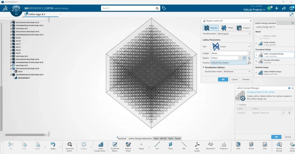

Design Method: 3DEXPERIENCE CATIA - Lattice Design
Lattice Pattern: Crown
Cell Length: 16 mm
Structure Radius: 0.5 mm

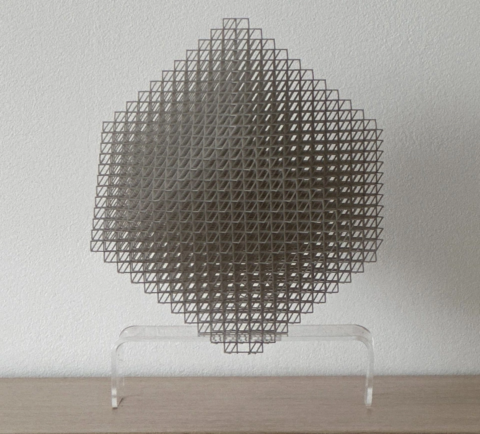

Material Saved: A material savings of 98.63% was achieved, thanks to the lattice design.

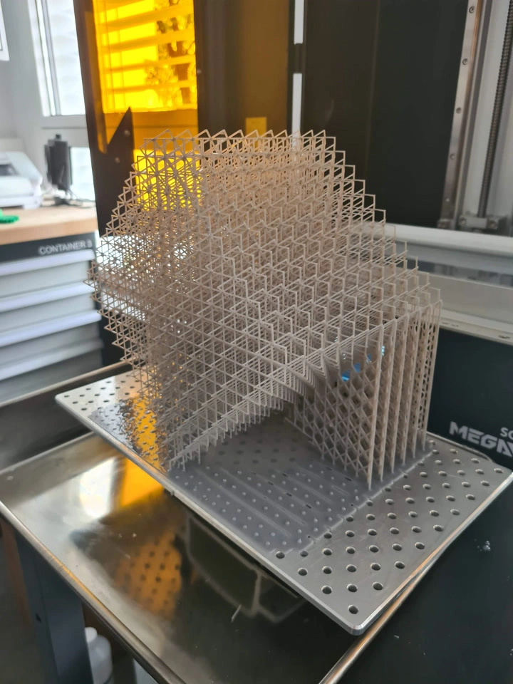

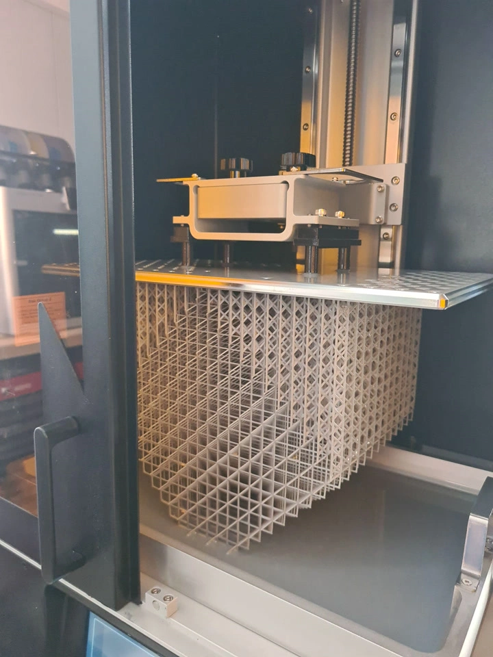

Printing Technology: Phrozen Sonic Mega 8K Resin printer
Resin Type: Speed resin
Printing Time: Completed in 5.30 hours

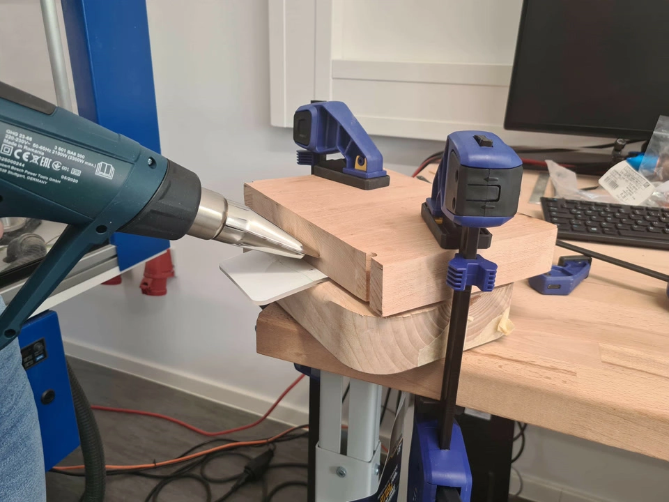

Additional Features (Stand Design): A custom-designed stand accompanies the lattice structure, crafted from acrylic cut with precision using a laser cutter machine. The corners were skillfully bent using a heat gun, ensuring stability and aesthetics.
In CATIA´s Lattice Design interface, users can adjust lattice parameters such as pattern type, cell length, and structure radius. These settings are found under "Lattice Conceptual Design".
The software also showcases material savings facilitated by the lattice design, visible under "Concept Information". In our case it is 98,63%

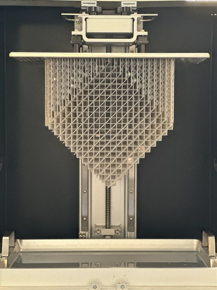

During Resin Print
Finished Resin Print
Process of taking off the support structures

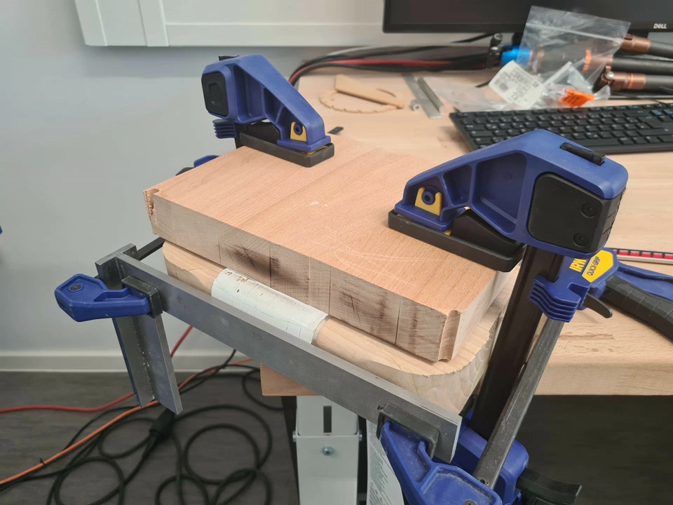

Acrylic bending with a heat gun
Secured to the table for proper cooling and stability, ensuring a smooth and stable outcome
FINAL RESULT
